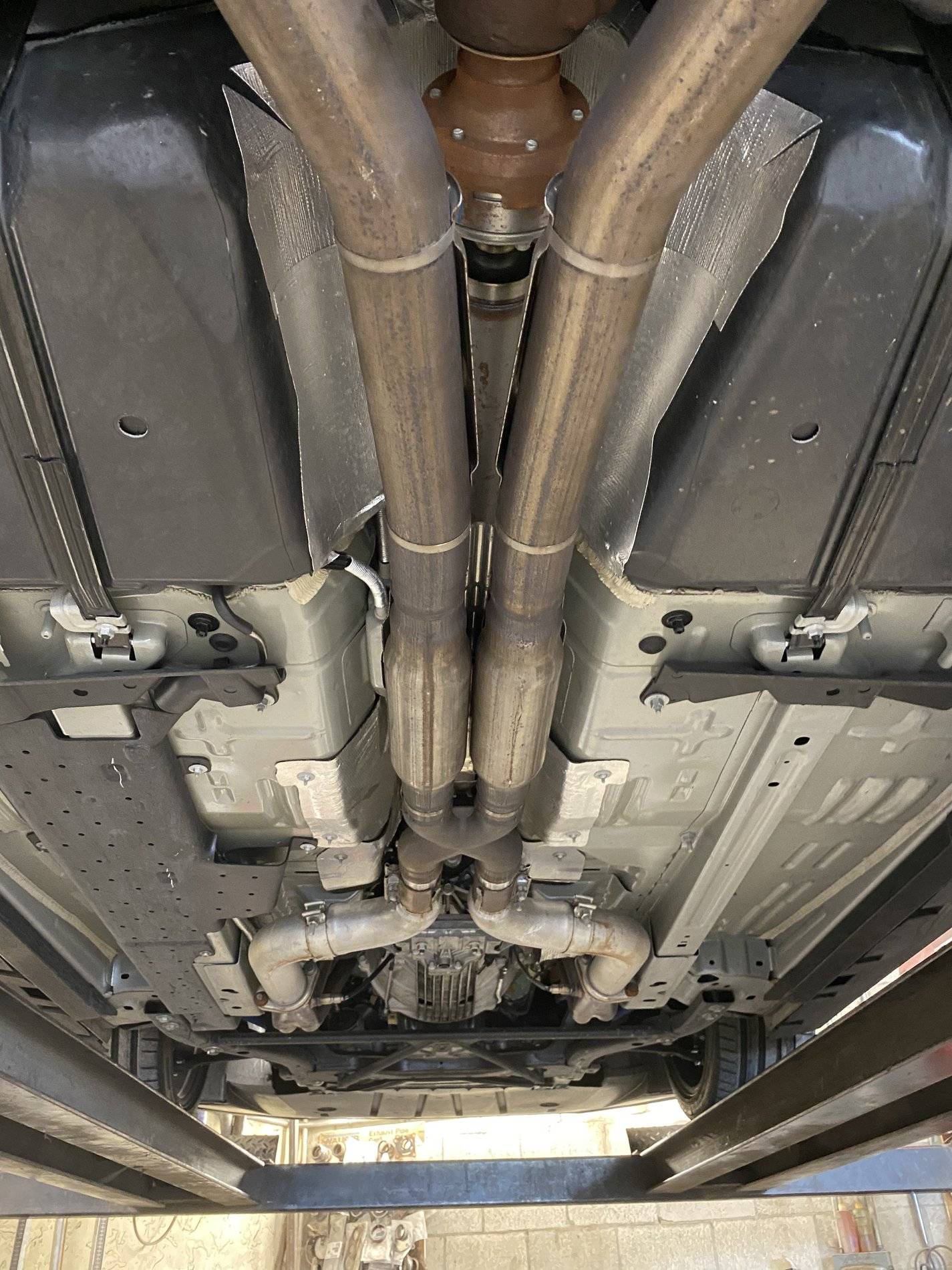

After adding long tube headers, without cats, the ford racing X-pipe that came with the GT350 Sport exhaust as too loud. So, I added the Borla resonator to tone it down and eliminate the raspiness, which it did. It sounds really good but it is just a little too tame. I started looking for a stock GT350 X-pipe with the resonators rather then build something from the Summit catalog. I was able to score the GT350 X-pie and resonators from GT350Nick. This seems to be a good aggressive sound without being obnoxious. The best thing is that I had both set-ups fabricated so I can easily swap them if needed.
