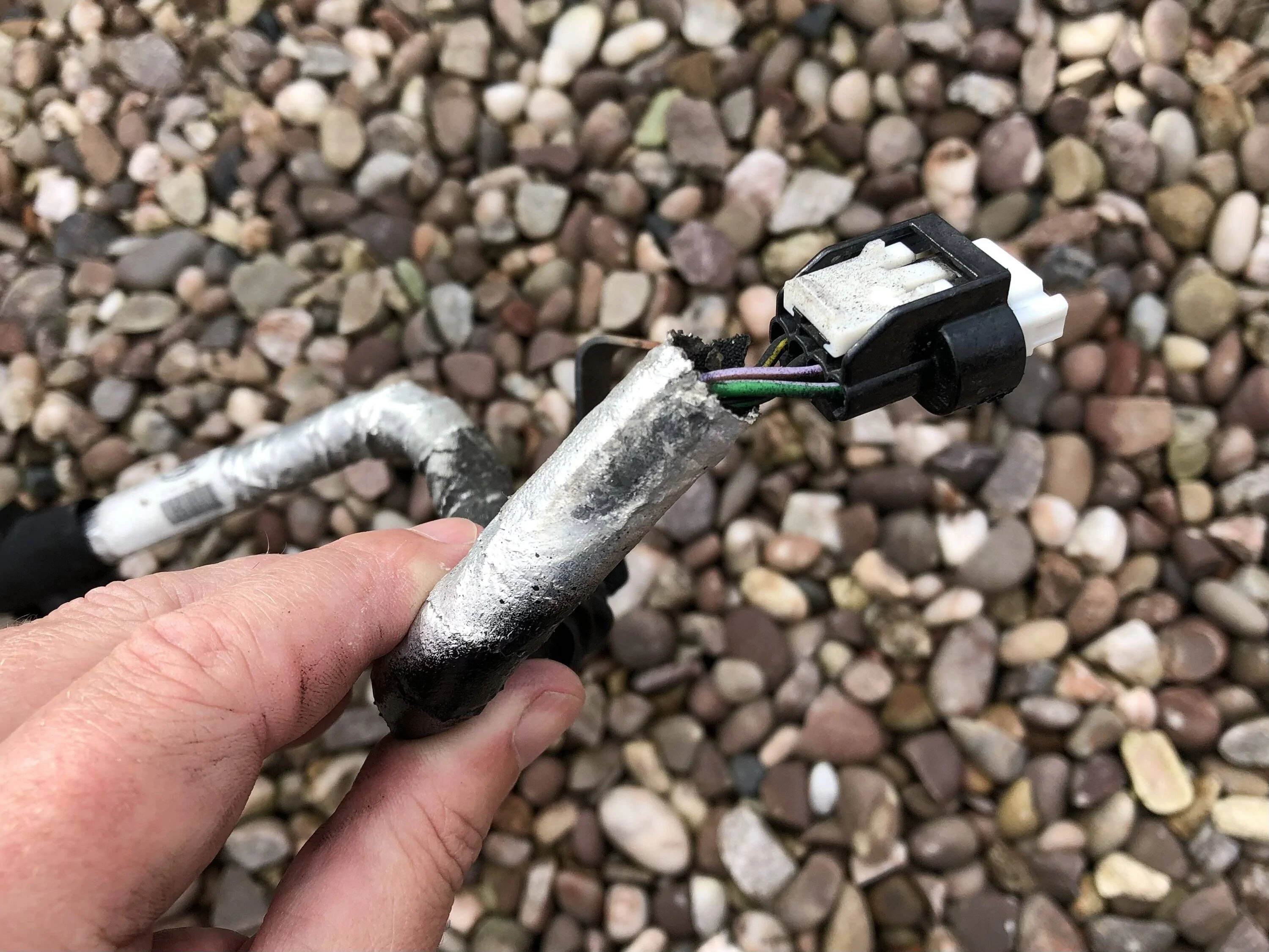

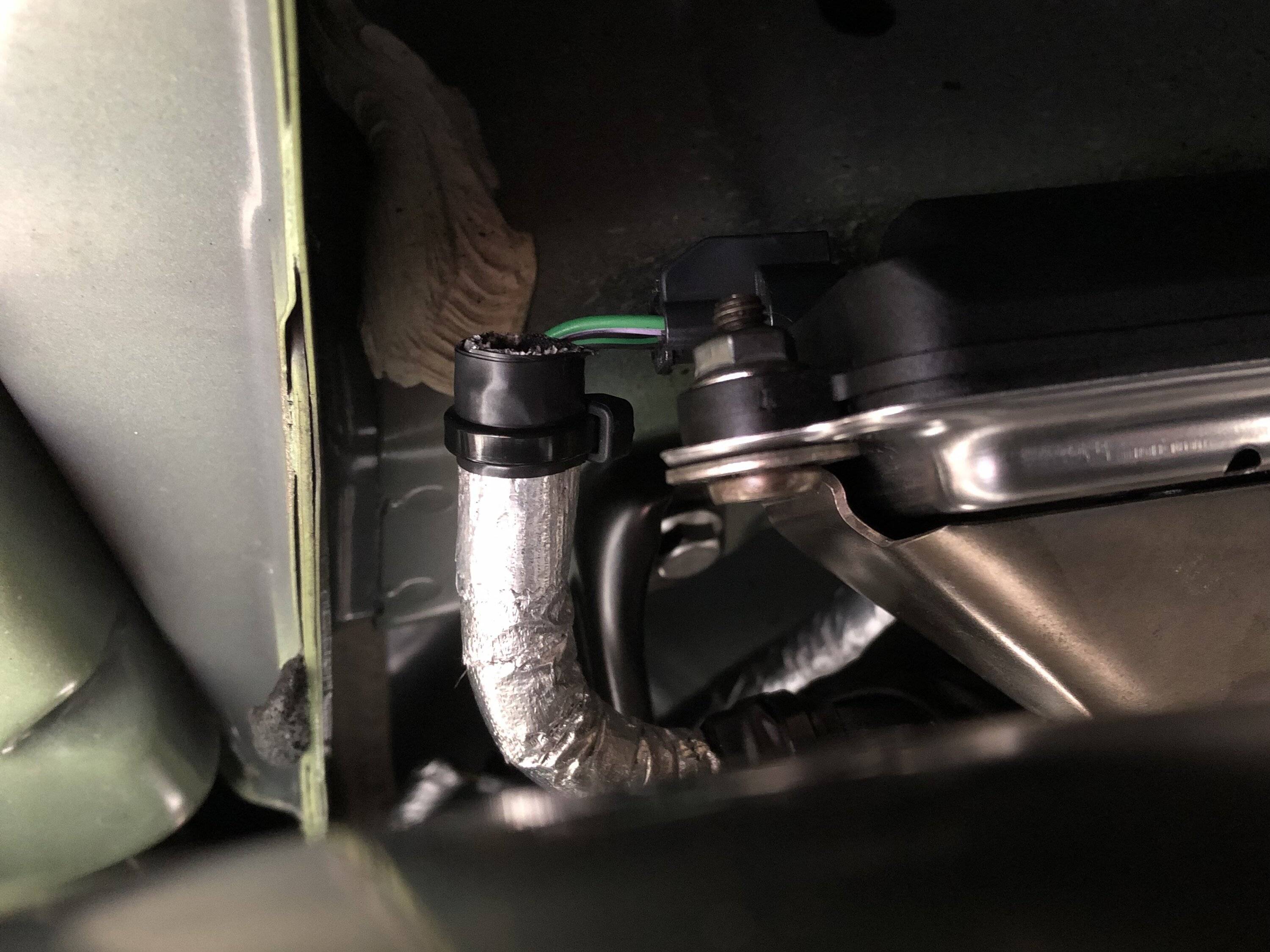

I just ran into this problem as well last night, sure enough the wires started rubbing on the pinch weld. Why Ford could not have moved the valve a 1/2" closer to the muffler, or made the connector on the valve motor 90 degrees from it's current position is beyond me.

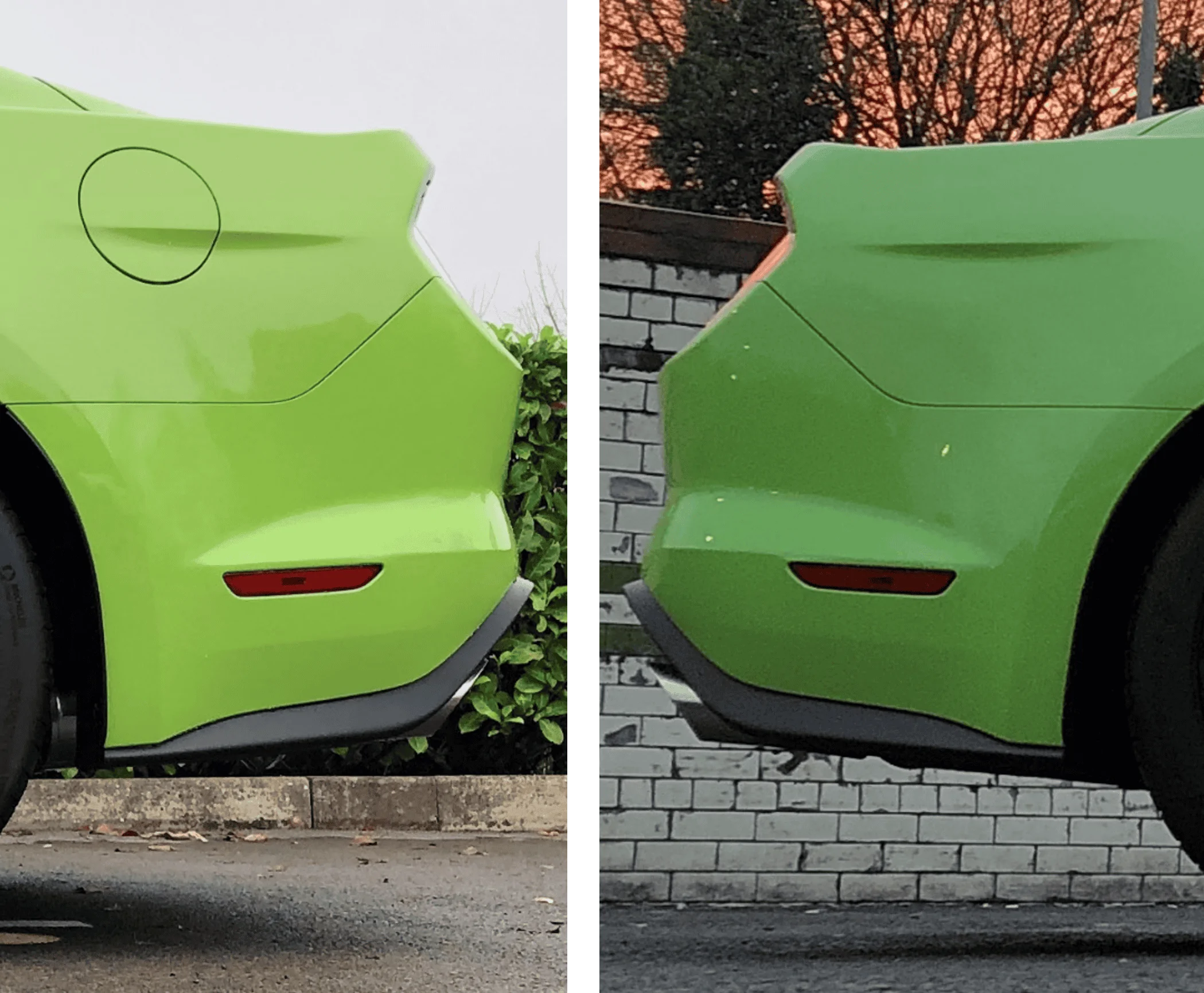

I believe @WD Pro has mentioned shortening the exhaust a bit to give move it forward and provided more clearance between the body and AE harness. This would also be an option for you to correct things moving forward.
If it helps, I shortened my active exhaust with H pipe by about 16mm total when I fitted the H after my standard system had started to rub.
I made the ‘perfect’ cut, then shortened the cut and the front of the H pipe by about 8mm each.
Right side loom off the standard system had just started to rub :
Before (standard system / standard fitment on the right) v after (modified with H) :
Loom clearance after the mod :
