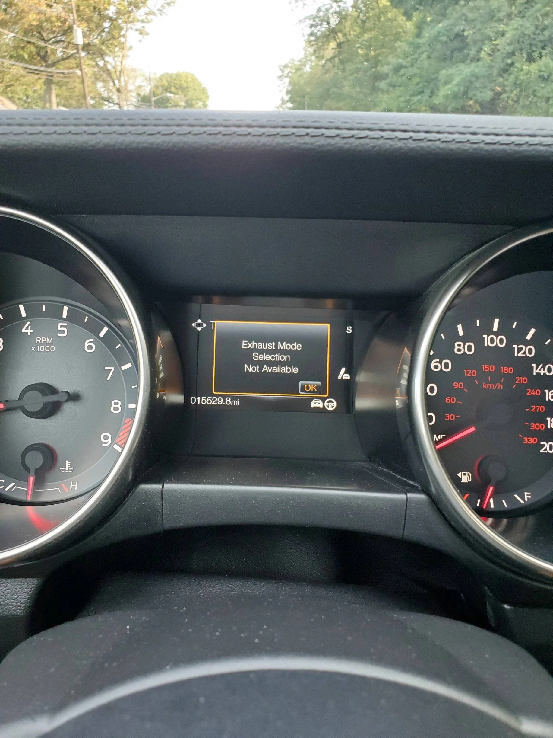

Hi All, apologies if this info is setting elsewhere and I can’t find it. Got a text from the wife that this message came up on the dash. Will check if it’s a fuse when I get home. Wanted to ask a couple questions.
If not a fuse, other items worth checking?
The bumper to bumper warranty is expired on the car but still under power train warranty. Does anyone know if covered under power train ?
thanks

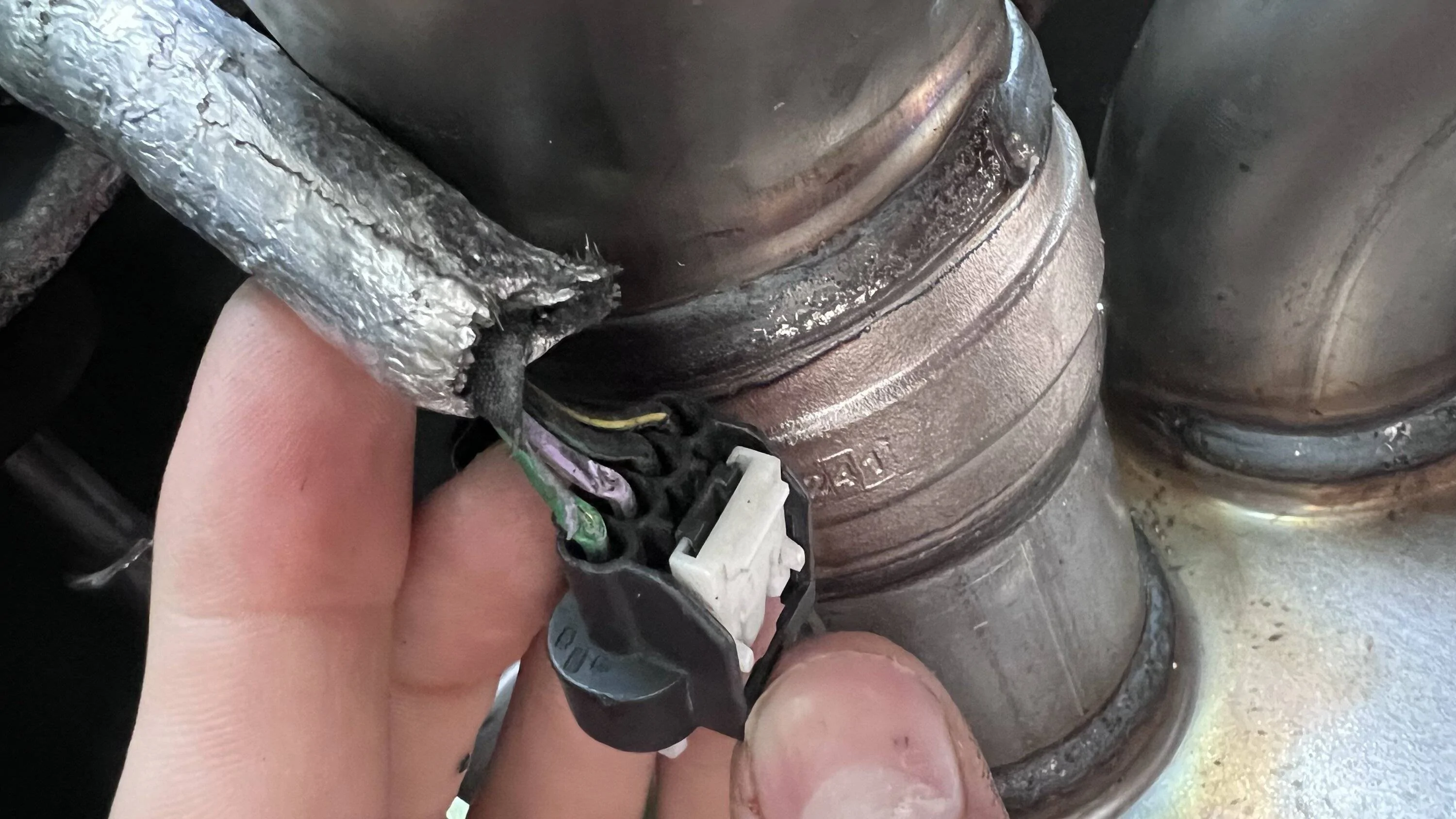

Not sure if this issue also plagues GT350's, but a lot of GT owners experience a chaffed or broken wire at the valve electrical connector on the passenger side. It rubs on a pinch weld

Do you have an aftermarket exhaust or OEM? Also, does the message go away after you drive around a while and things warm up, or does it stay that way no matter how far you drive?

Just fixed that on my GT. The wires were rubbing on the passenger side. I got the message for a couple of days before the fuse went out. I would check the wires there as a starting point.

Thanks all. I checked it when I got home. Fuse is ok but error message still there. Don’t have a lift so will probably bring it in for a look.

Did you do a pull right before that happened? I did this on my GT a month ago. Thought I fucked something up bad but the wiring harness above the muffler tips just got pinched on the frame of the car and shorted it out.

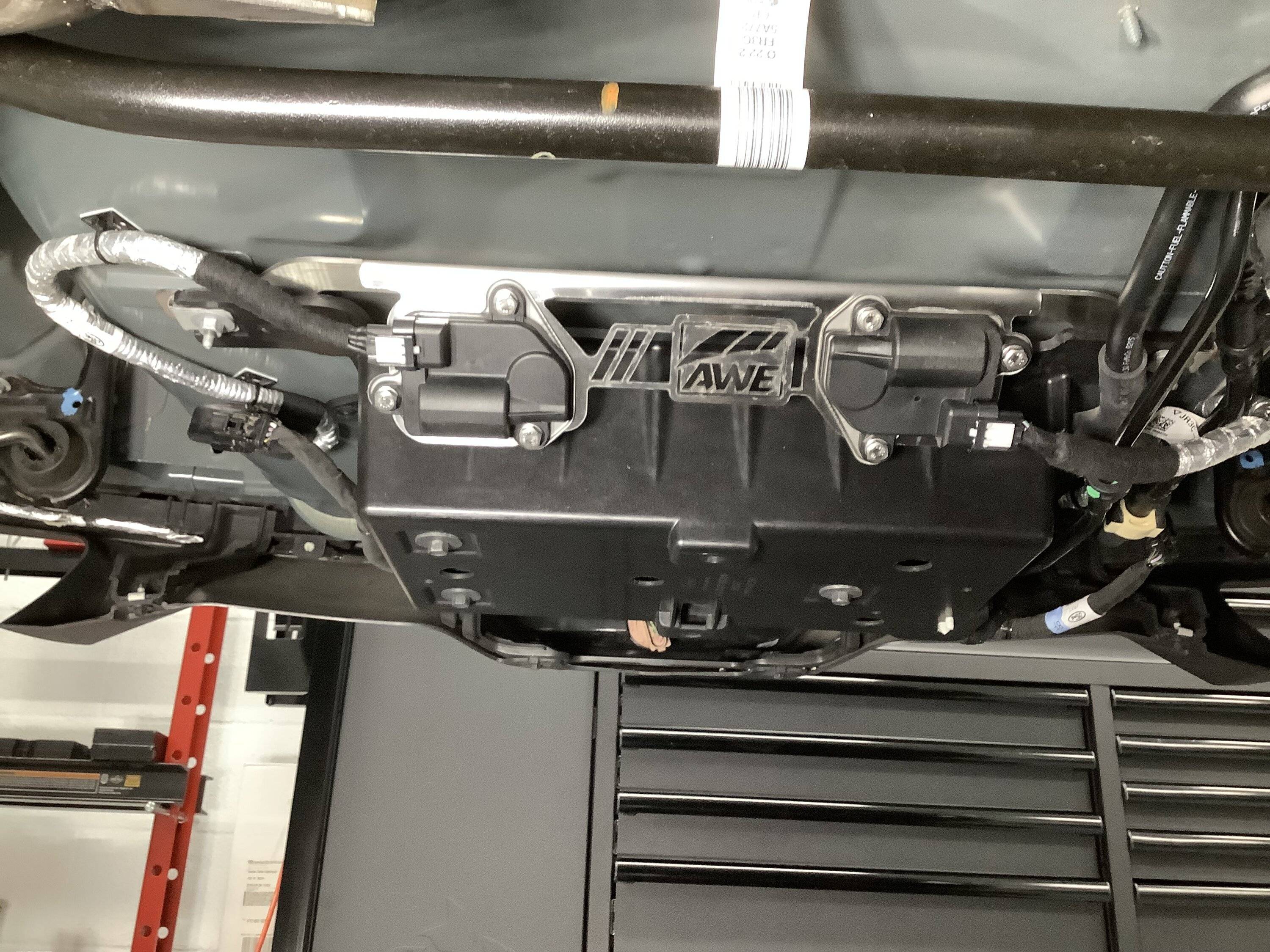

Happened to me too a while back. I repaired the harness and deleted the Active Exhaust, moving the actuator valves to an AWE bracket to keep the light off on the dash.
I believe @WD Pro has mentioned shortening the exhaust a bit to give move it forward and provided more clearance between the body and AE harness. This would also be an option for you to correct things moving forward.
You can disable the AE in FORScan too. The reverse of retrofitting the AE. Would save like 2 lbs of weight and the price of the bracket 😂
I had no idea that was even an option. With that being said, it’s clear that there’s always more than one way to get things done.
