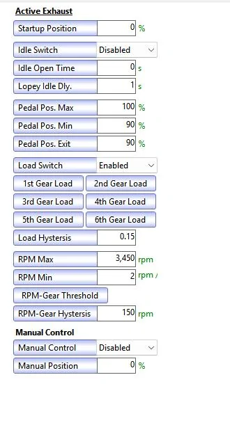

coyote.colby
Sep 20, 2024
180
85
Virginia
Colby
2015 mustang fbo pp1 (sold), 2018 kona blue gt350
I'm no IT guy, but the valve control isn't in the tables or whatever. I'll ask my guy. One has to assume if that was possible in a tune, that would have been shared by now.
...and you know you're in the 350 section, right? Not being a dick, just that a lot of guys post over here not knowing they're here, and a lot of stuff between the two cars (GT vs 350) does not carry over.
i own a gt350... and you can tune them out with both hp tuners and SCT. just set manual control to enabled and position to 100% open
galaxy
Feb 16, 2018
291
4,036
3,633
St Louis
'17 GT350
Interesting. Kinda really surprised that has never come up in here before, that I have seen at least.
coyote.colby
Sep 20, 2024
180
85
Virginia
Colby
It has just not a lot. i found this out while trying to get the stuck open because i hated the fact that the valve's close in 6th gear
