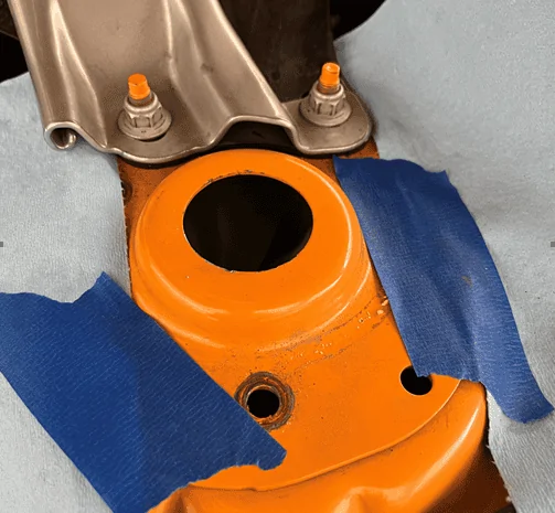

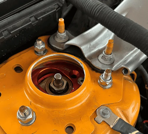

After 7 consecutive weekends of family vacations, concerts, and small trips, it's time to get back to car projects.
I sold the Leroy tire trailer, removed the hitch from the car (36 lbs lost), got a new set of track tires (so excited to be rid of the RR's), and did some more cutting.
Before:
After:
The Steeda cutting tool worked great. Now just need an alignment and onto the last couple projects: debugging my Xineering unit and installing the oil cooler.
