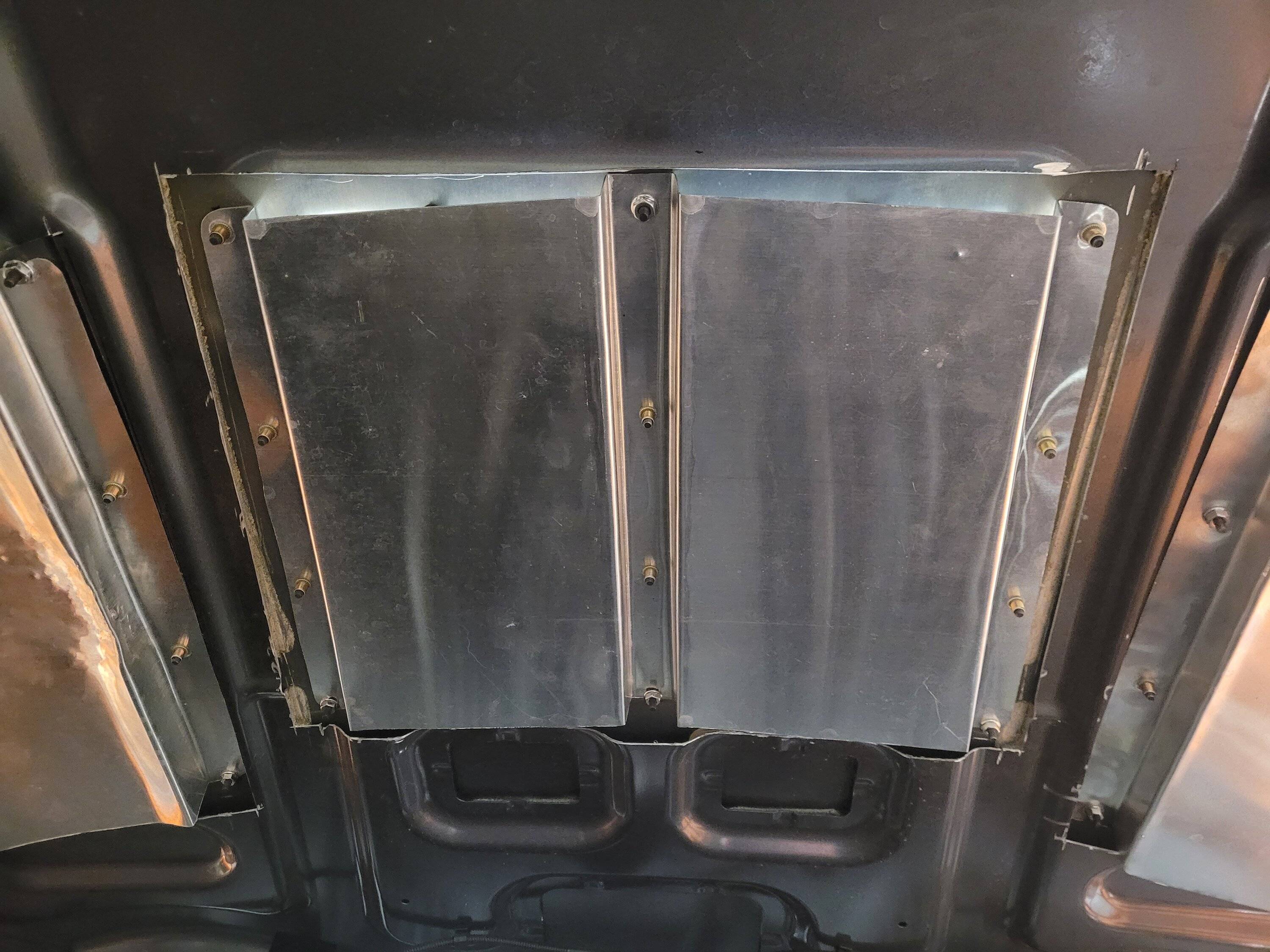

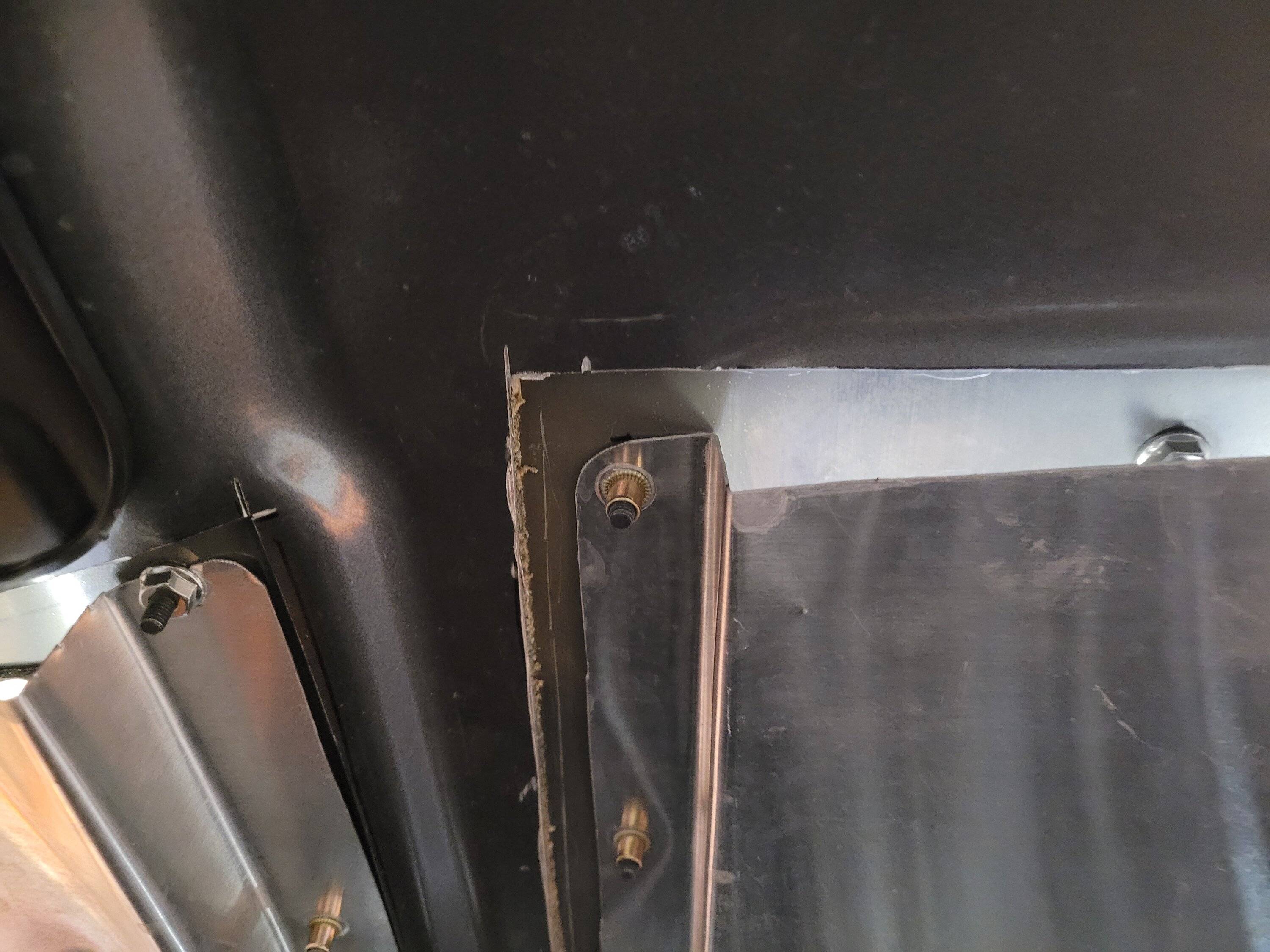

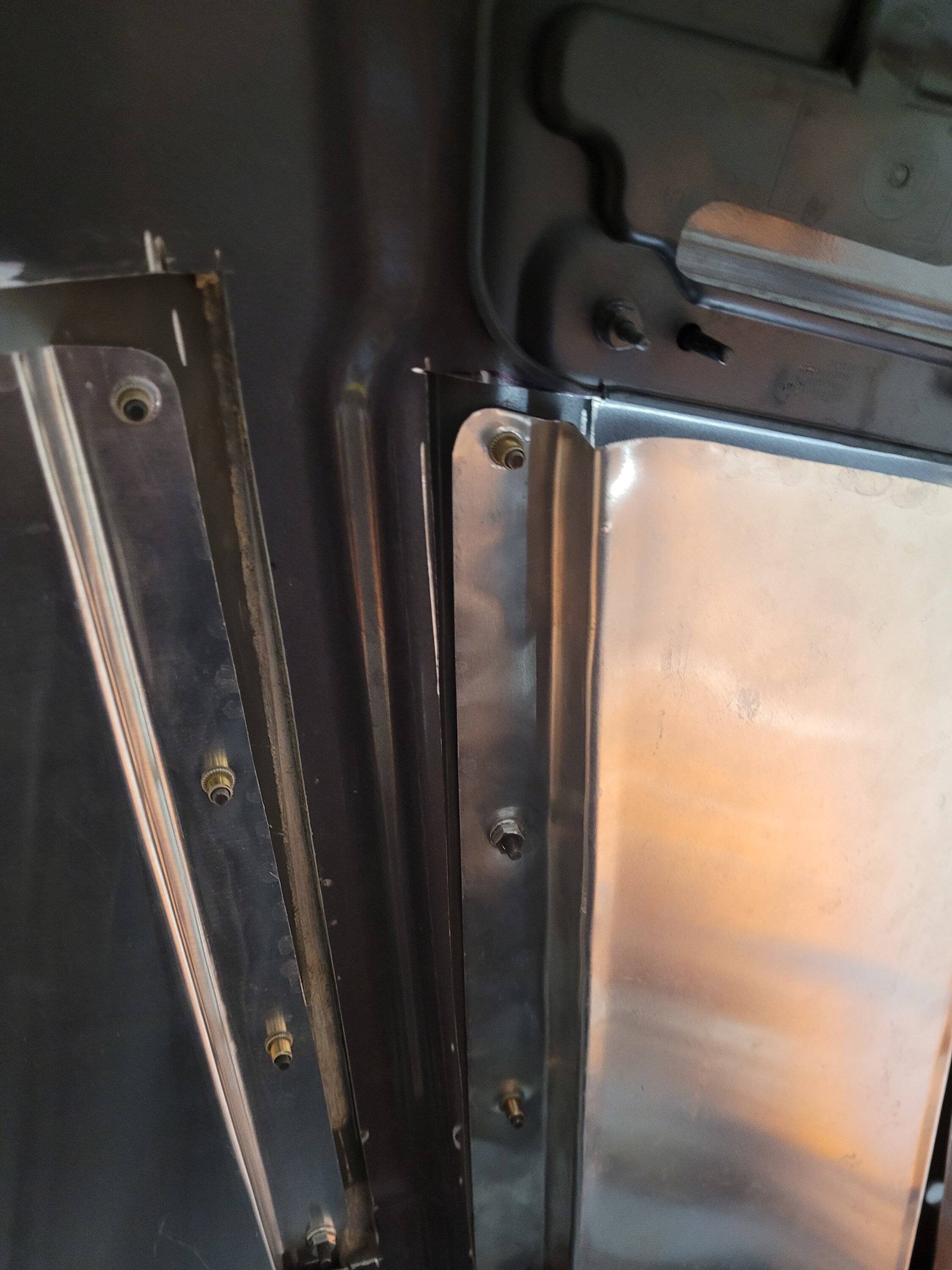

Keep in mind that you will need to cut the underside, not just top layer. I had to remove extra cutout for underside so that the screws fit well. Attaching couple pics to give an idea (don't mind the rain trays). Be careful not to cut through the top layer while doing this.
