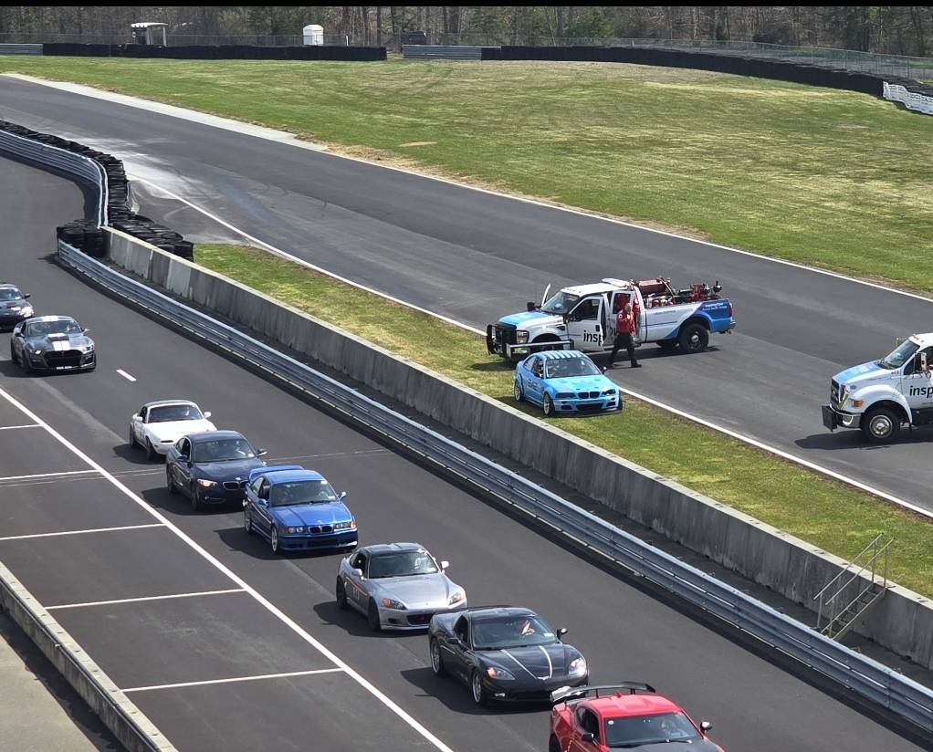

I've lost count of GT3's going into inside wall, old BMW racecars spilling fluids and screwing it up for others, a GT4 that landed on a roof 5 times while rolling across the run off area, a guy in a caged bmw who ended his day with a helicopter trip to ER for 12 days, and etc.
Cue old BMW spilling fluids for others on my last track visit...

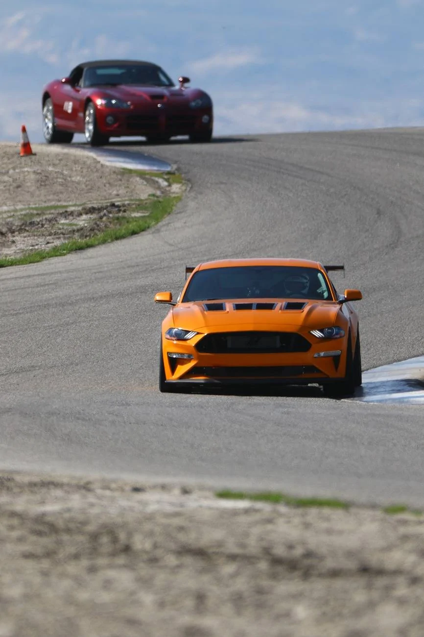

Another track day down with some more temp data and another second off my PB.
Back to Buttonwillow as the only thing I currently care about in terms of cars and racing is getting a damn sub-2:00 lap there....yet it has evaded me once again. That's ok, shaved another second off while still making tons of mistakes so I know a sub-2:00 lap is possible. Currently sitting at 2:01.5 so just need to tighten up the line and braking points and I'll be there.
In other news, the Mishimoto oil cooler that is a waste of money and time (as per the internet) is still holding up great. Back in December, highest oil temps were 255°F in 50°F ambient. This past weekend, I saw peak oil temp of 264°F and CHT of 235°F in 77°F ambient. Now, that's still a reasonably cool day so it certainly wouldn't withstand a 100°F day or maybe even 90°F but I generally skip the summer months anyway so that doesn't bother me.
It's right at the upper limits for temps so I may improve the ducting or add a bigger radiator down the road but for now, temps seem to be under control.
Suspension seems to be the weakest link at the moment. The Ford Track shocks with BMR's 250 lb springs in the front are amazing on the street but are still wet noodles on the track. I can feel the car sway from side to side in the twisty sections and I can hear scrapes on several dips in the course. How much will coilovers actually help my lap times....no clue, but from others' experiences, it should be fairly significant.
