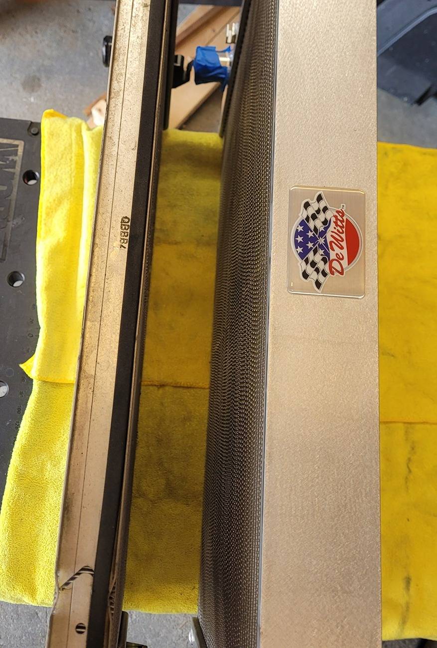

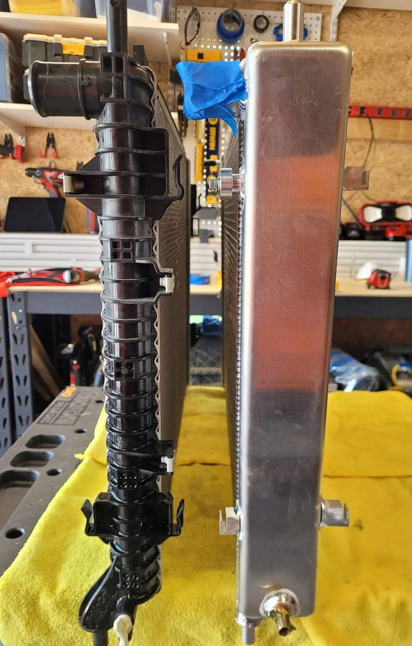

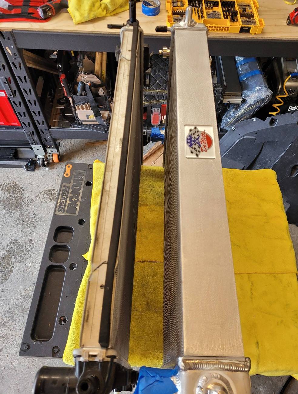

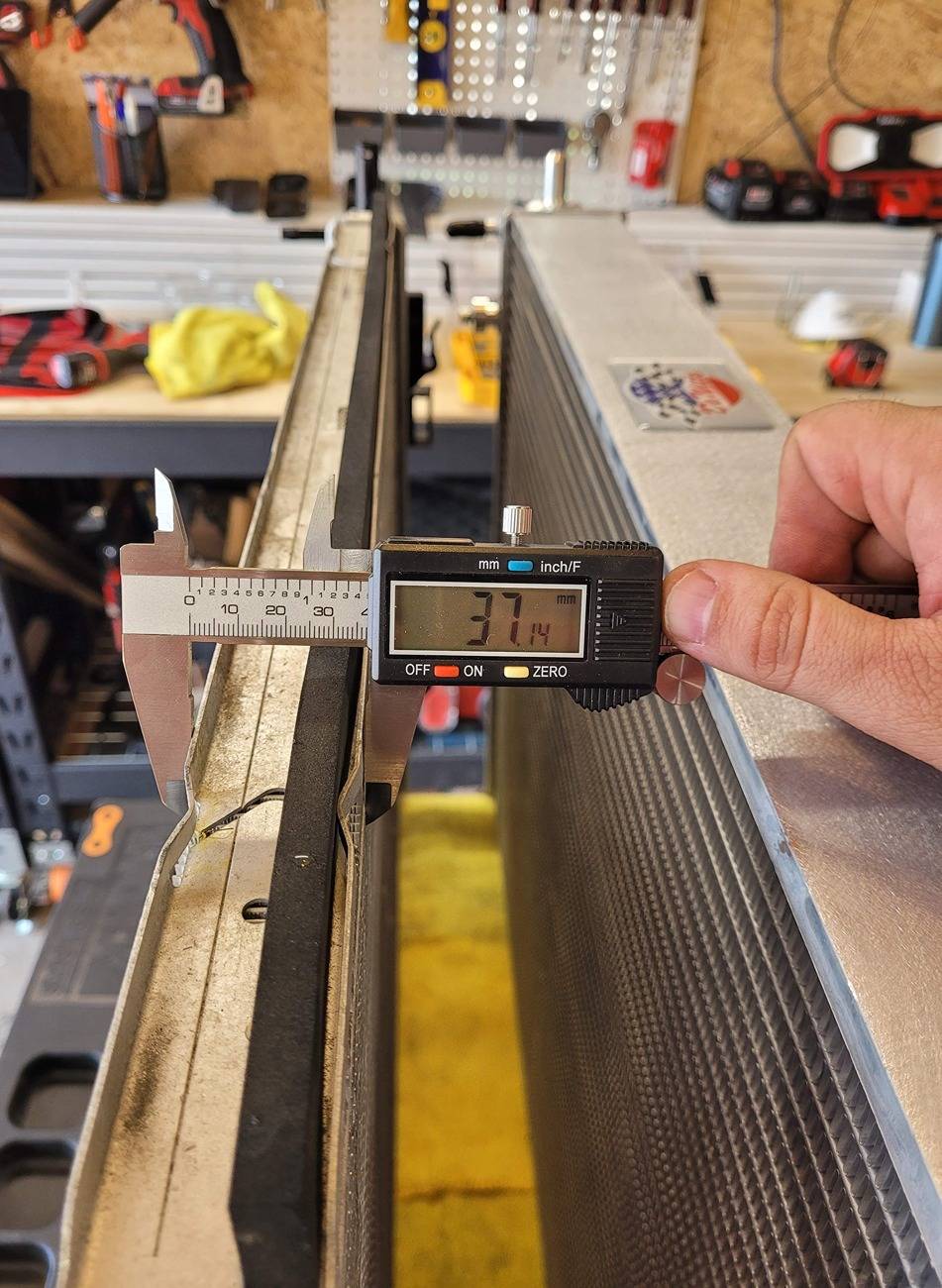

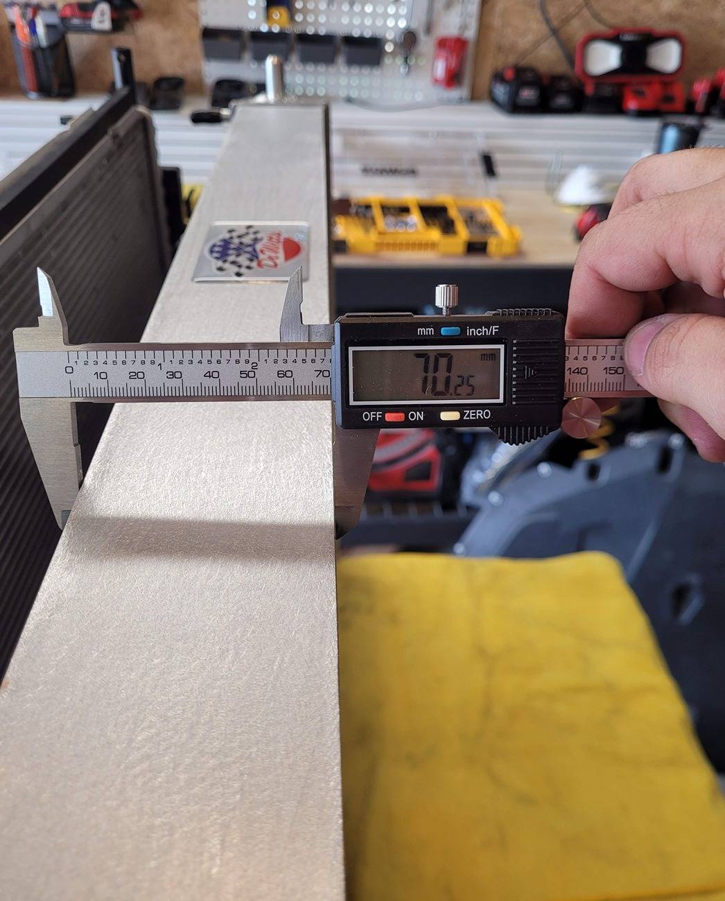

i was looking at the csf 42mm. 70mm is wild didnt even know that was an option. thanks for the info!! it says single pass any reason you went with that over a triple pass
Based on the information from this forum and my research, triple pass is not a good option unless you have specifically built custom cooling system. Short of C&R, Dewitts seemed like top of the line option with great reputation, and the biggest single pass thing that I could fit. I had to do some minor tweaks die to Roush supercharger, but I made it work. It should fit like a glove into stock engine.
I also think that it's a bit of an overkill for NA coyote, but then it's better to overbuild when it comes to cooling. What problem are you trying to solve?
