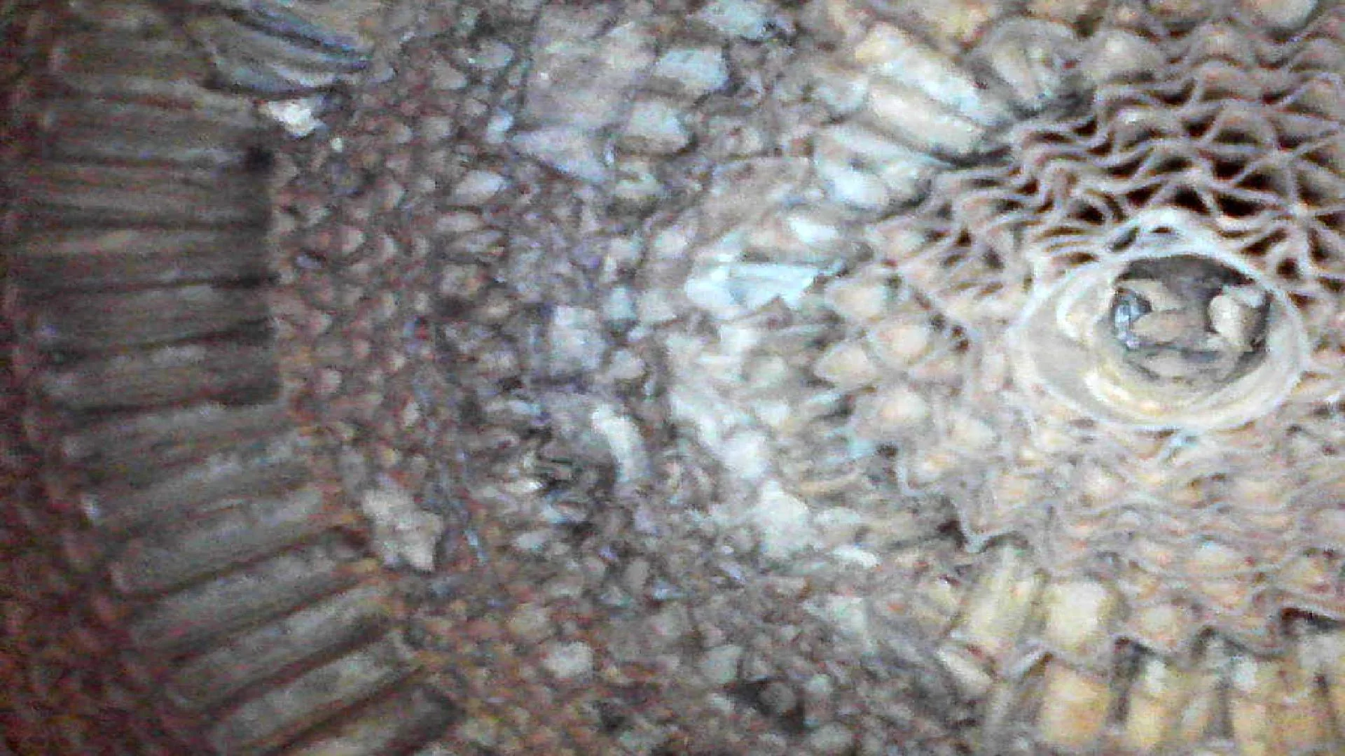

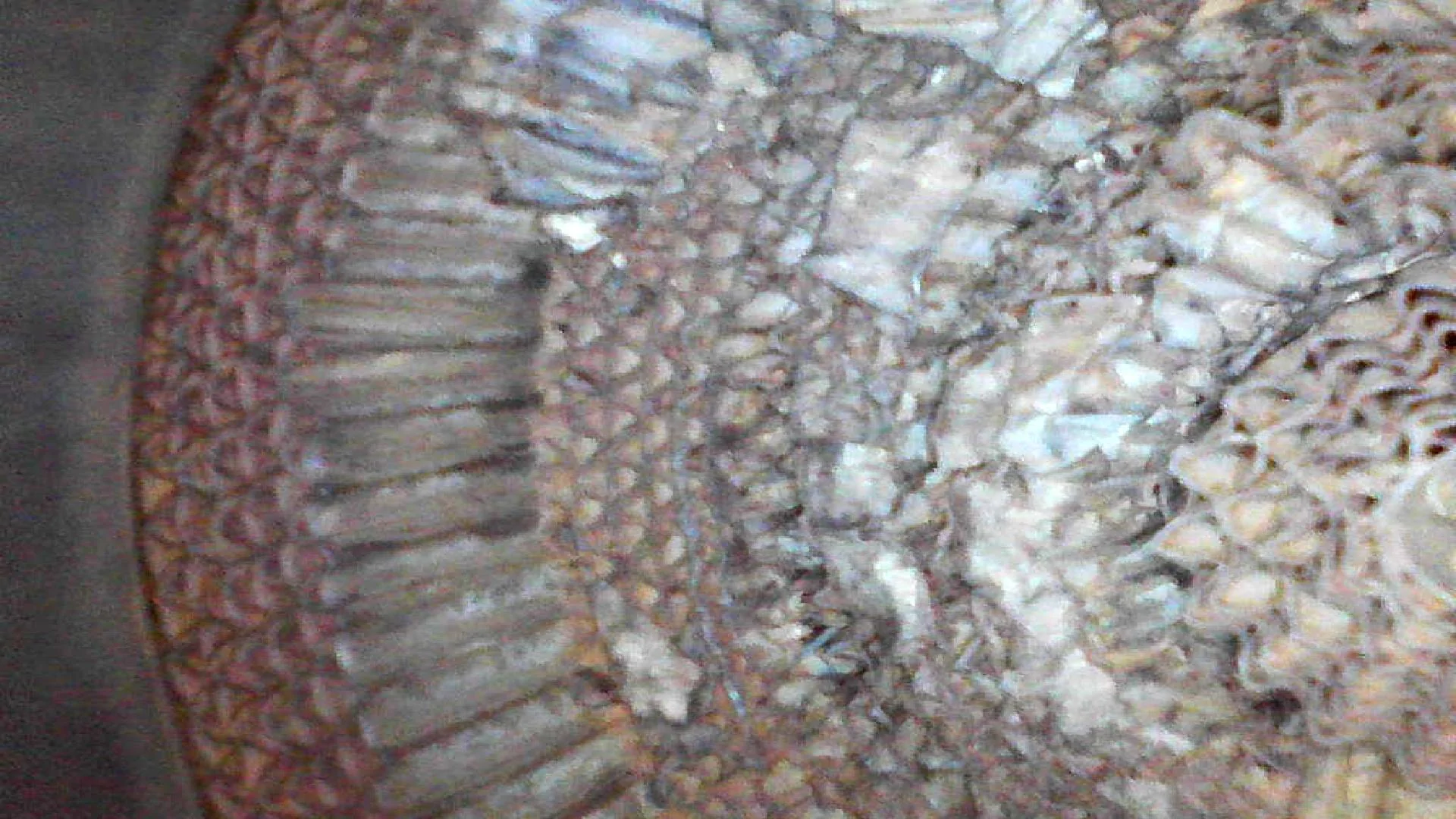

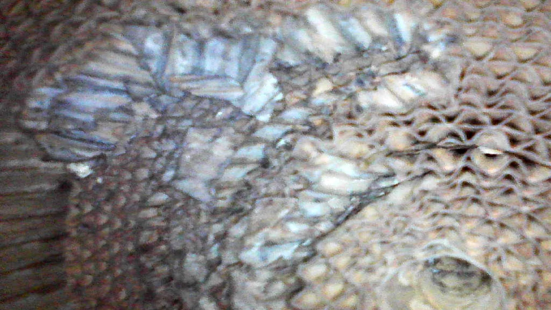

For the folks running cats....check your cats.
Was doing my general inspection and saw my driver side cats are going out.
Wasn't experiencing any power loss, just a general check so glad I caught it now before it gets fully clogged and takes out my block.
These are the relatively pricey kooks cats as well supposed to handle up to 900 hp (I'm at about 700 whp / 750-800 chp last time I dynoed it) but there you go.
Kooks Green Cats (GE-90140)
Really trying to avoid any sound increase but I don't think I have any choice but to go catless...

$800 for the green cats down the drain, should have gone catless like you from the start.
I've purchased some vibrant resonators so will get the exhaust shop to replace the cats with those and see how it sounds.
I already have the magnaflow tru-x resonators so I think that should be enough.
Last option if it's too loud will be to replace my borla active s-type mufflers with my stock ones (and change the damn tips) but hoping to avoid that as I love the s-types

From what I read, the stock cats hold higher temps than any aftermarket cat. Thats one of the reasons I'm staying on low boost. Apparently, its either oem cats or no cats at all.

So the Kooks Green Cats went out? did you contact Kooks to see about what they will do you you? I was going to go with their Green Cats, but from what you are saying I will stay clear. Thank you
Yep.
I didn't buy them from an official kooks vendor (purchased new from cspracing) so they won't warranty it per the policy on their page. Didn't bother chasing that down since I don't need a replacement though I guess I could try getting them replaced and sell the replacements to someone making less power.
Good idea, boost doesn't go well with after-market cats. There are a few other threads on this forum with the same issue, I believe one of them had his block taken out as well from the clogged cat.

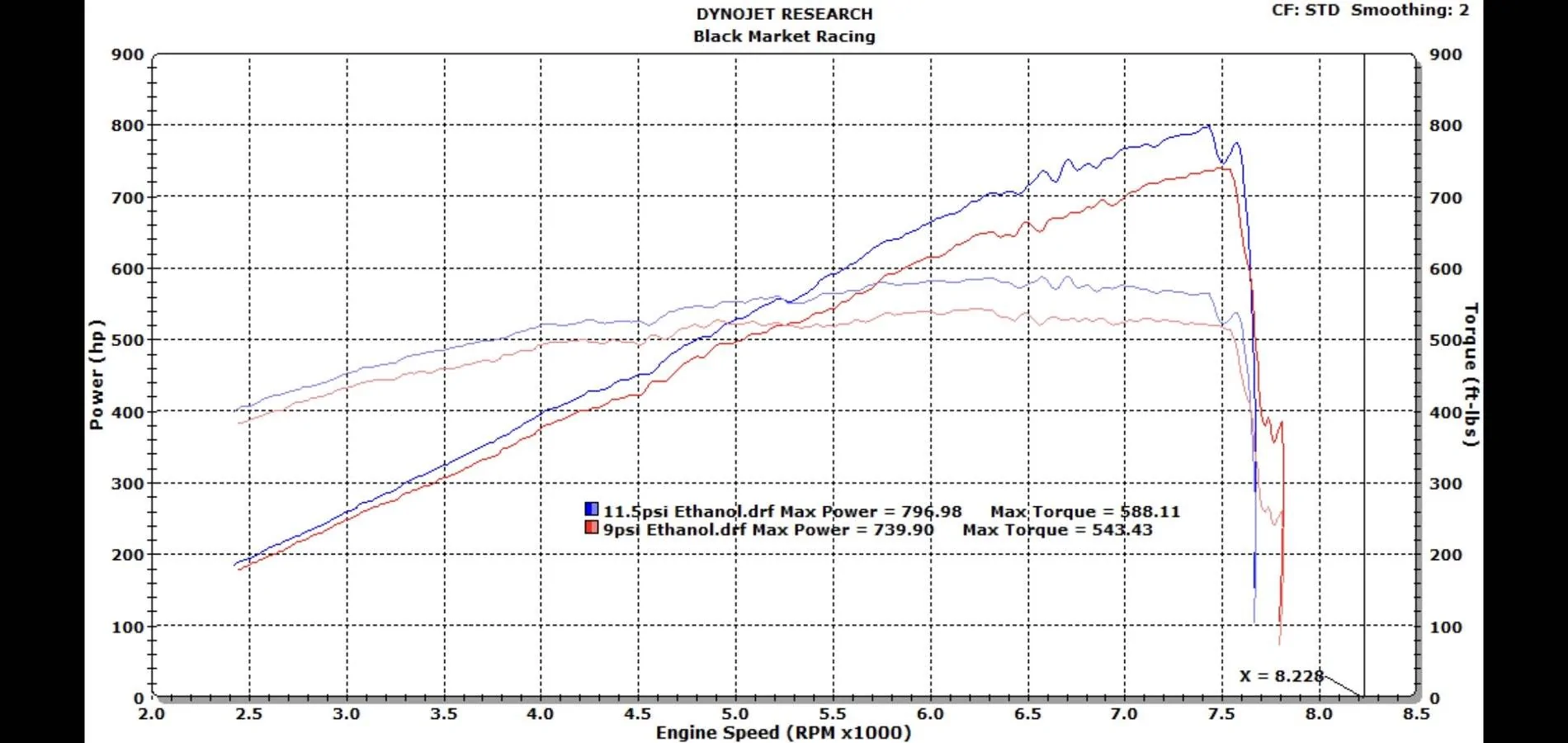

This was an E54 tune for the 796 whp graph right?
What pulley/psi were you on and what was your max WOT timing?
Went catless recently and the wife isn't fond of the smell on 93 (neither am I tbh) though the car did make about 17 more peak HP than when I was catted (710 - 727). Same dyno and similar DA.
Making the jump to E85 (fuel system + bigger injectors) and doing a clutch upgrade for my 10R80 but want to keep power below 800 whp till I consider doing an engine build (unlikely as this is a street car unless something breaks).
Will inform my decision on how much max timing to request for my PBD E85 tune with my 11 psi / 105 mm pulley. Thanks

Which fuel system did you go with? Im making the jump to e85 as well. Ordered a DW X2 hat, dw95 injectors and a set of fuel rails. Should have it all ready for April/May when the car comes back out. Hoping to be in the 800 to 850hp range. Just going to run e85 at the track vs race fuel. PBD should give you 22 degrees on e85. Looking forward to seeing your results on E.
