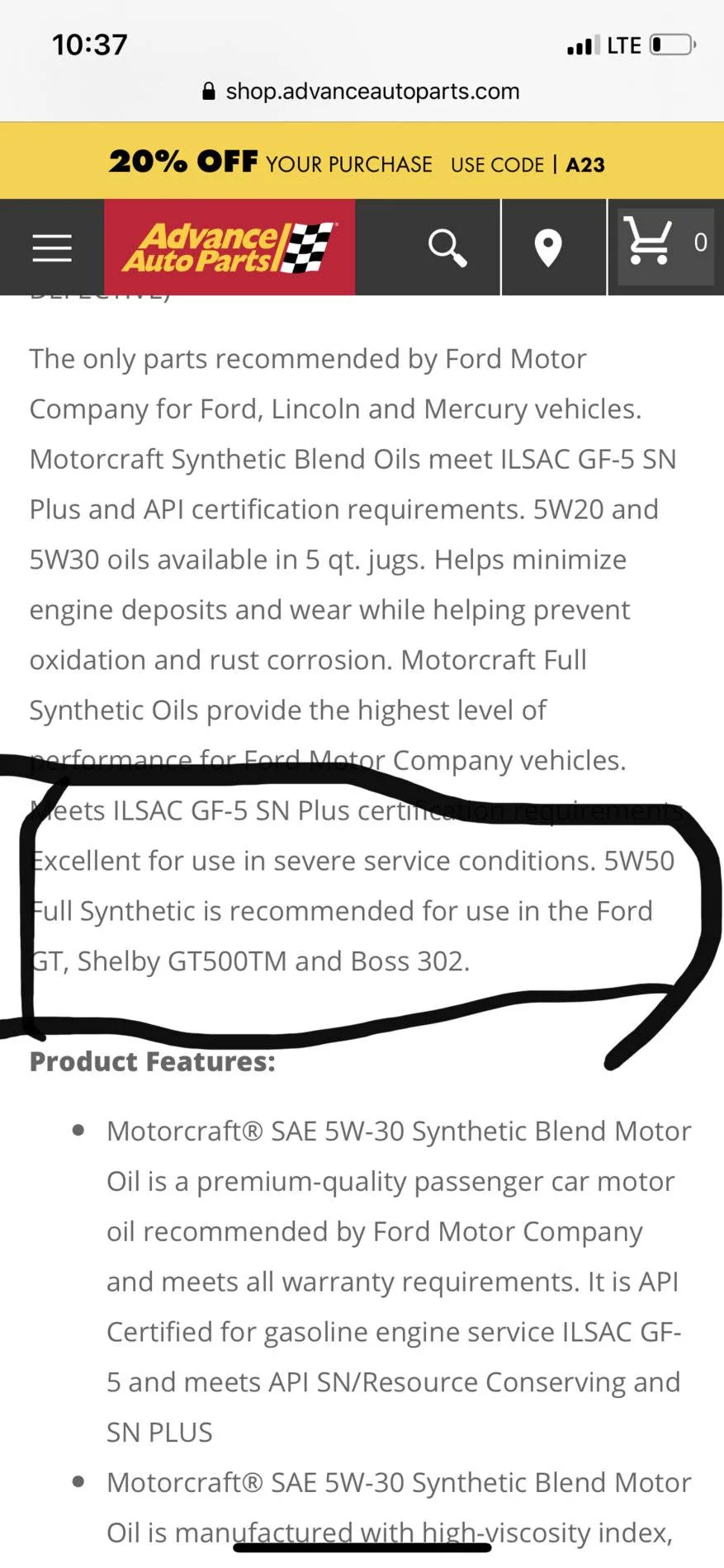

Even Boss 302 uses this, but why?

These 5W40 or 5W50 are hard to find in our local stores. Since it’s a little cooler for a couple of months, pennzoil platinum full synthetic 5W30 good for now?

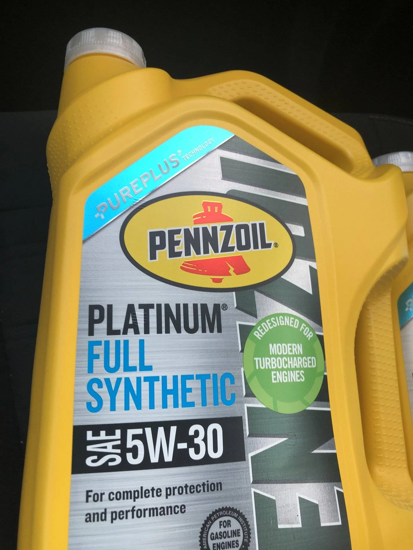

Noticed it’s redesigned for turbocharged. Does it matters?

That’s true for all SN+ oils. I believe they added that to the label with the SN+ reformulation. It’s about LSPI prevention.

I might return these Pennzoil platinum PurePlus for just a platinum or find that ultra platinum.

Platinum PurePlus is the same as platinum.
