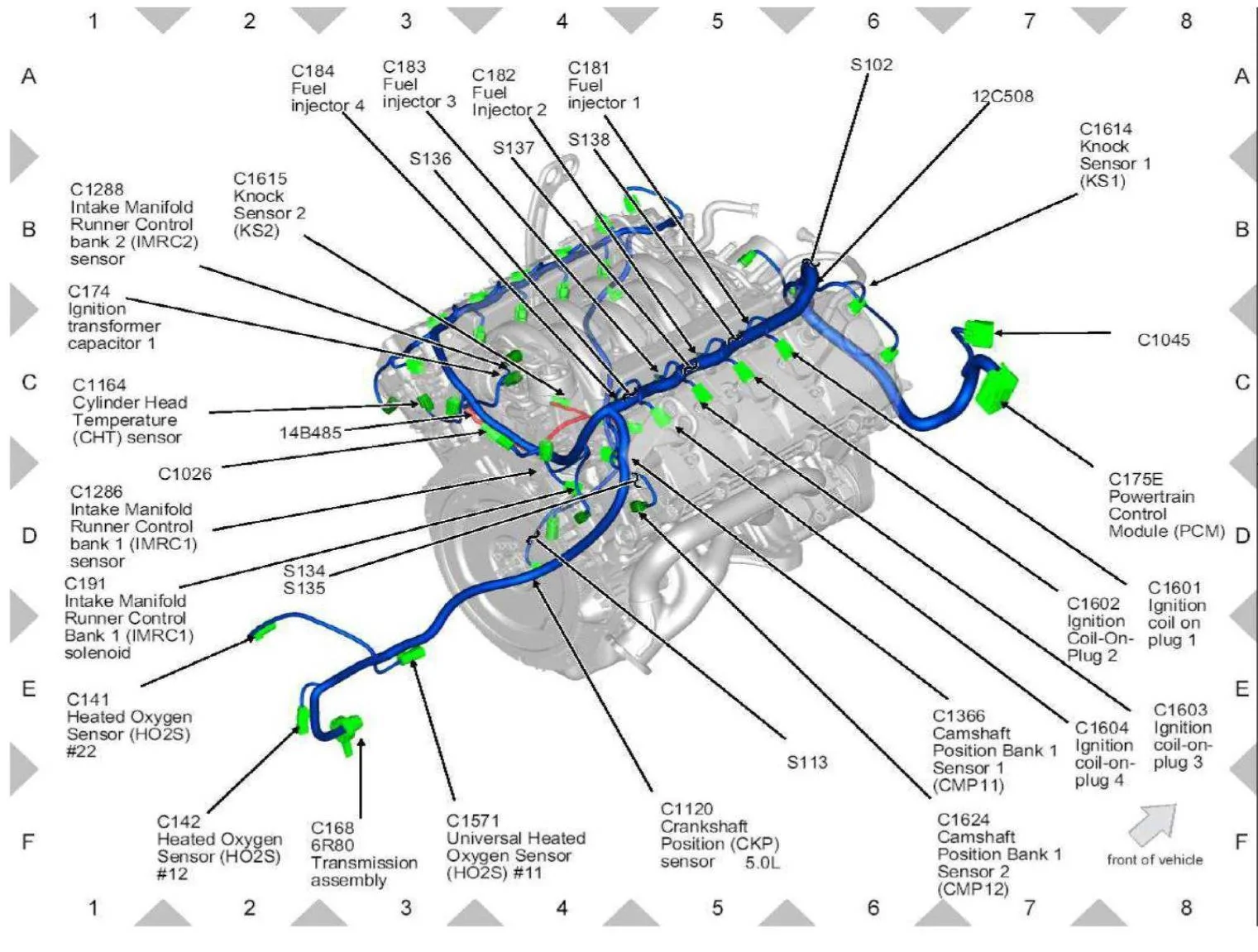

Right. Diff and transmission temp, too. Any other temp sensors?
If EOT and ECT are derived from CHT, it’s the only one we can affect directly. Is that confirmed?

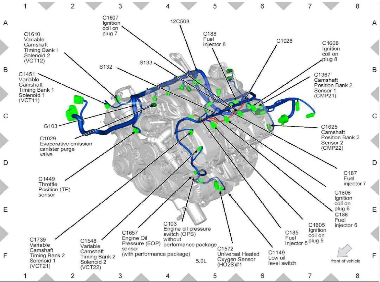

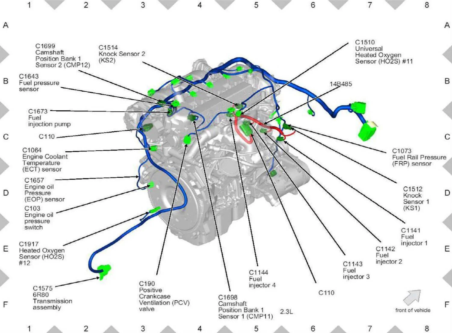

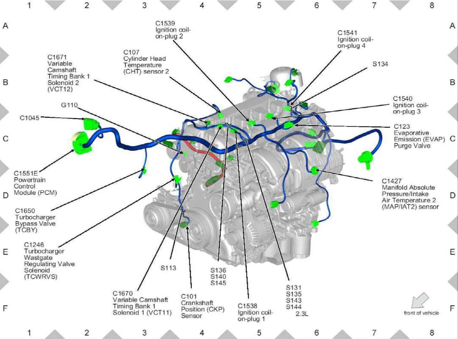

looks like some 5.0's have actual oil pressure sensors, but only a CHT sensor. While the ecoboost has a CHT and ECT sensor. forscan shows a cht and ect value for my ecoboost and they read a few degrees different
