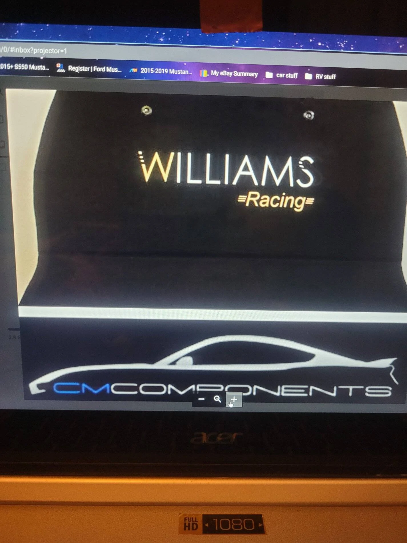

Check out CM Components. https://thecmcomponents.com. You can also ask for thicker material to be used in the construction, as well as custom graphics (like they did for me). Also When I installed mine I lined the floor beneath the seat with plastic bags and the bottom side of the seat delete and filled the empty space with expandable foam. Once it was fully cured I removed the bottom seat delete panel and removed the plastic bags as well as trimmed any areas I didnt want foam. That really gave the seat delete bottom extra support. I have two one hundred pound dogs I put back there and even with all their tossing around the seat delete bottom held up great, and I even have the std material thickness model.

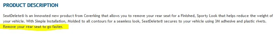

Love the product description...

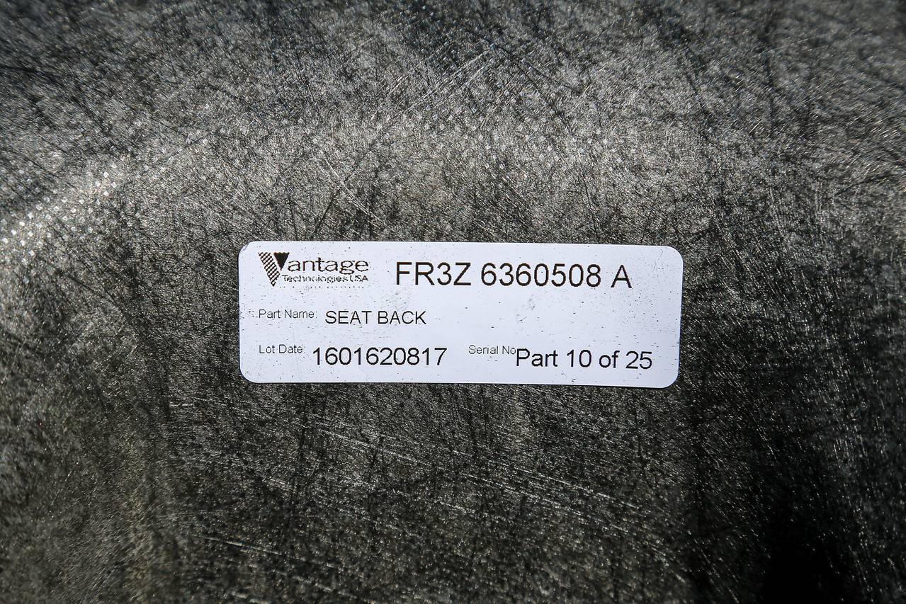

I'm not going to lie... but the OEM is likely built by CoverKing and I can't believe you found it. haha, that's nuts.

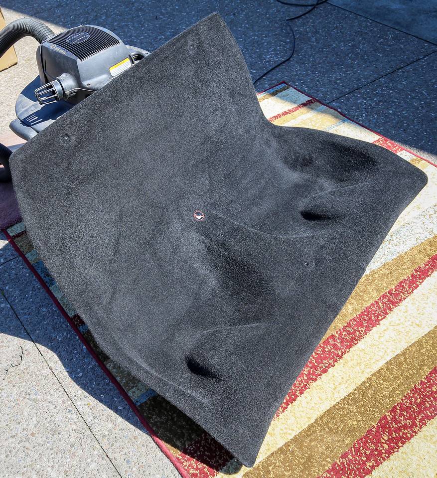

The OEM RSD is not made by CoverKing. I've put in a few OEM ones now and they are all from the same company.
https://www.vantagetechusa.com/
