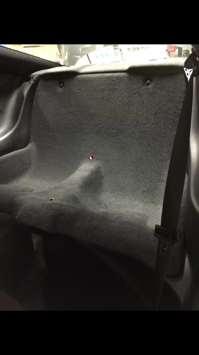

Ok guys I have it all installed. Here's a few tips.
The package tray trim where the seat backs latch onto (the striker) once you remove those, the RSD uses the outer bolt hole to fasten the RSD to. You must put a hole into the package tray trim to allow the RSD to be bolted in place. I used a old screwdriver and got it red hot so it wouldn't fray the cloth trim. This works great because it also melts the holes edge so it won't unravel. Also the lower bolt hole Ontop the driveshaft tunnel is a blank hole (just a die punch out, no threads) I used a rivitnut or thread insert. I didn't measure the threads but I'll post the size tomorrow. In all from rear seat removal, seat belt removal And RSD labor time is about 90 minutes or so. I put the seat belt bolts back in place along with the child seat ancor bolts. Just in case I ever decide to put the seats back in. I'll weigh all the rear seat parts tomorrow. The RSD is light. I'd guess maybe 2-4 pounds.

Installed. Just waiting on seat belt bezels.
