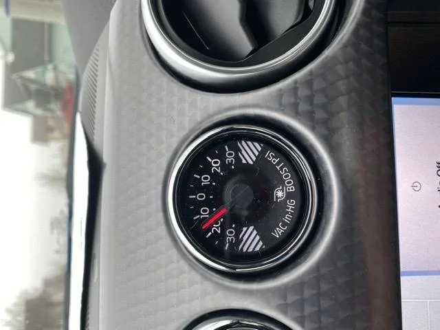

looks like a vacuum leak but I have no idea of where.
How accurate is that ecoboost boost gauge? I've been meaning to change out my PP vac gauge out for one, but wasn't sure if it would even work with an aftermarket blower.
On that topic, I have an older gen1 series ngauge. Lund website says it's boost box only works for gen 2 ngauges. What are my options for logging boost on an older ngauge?

I’m not sure how accurate the gauge is. I went with it because of ease of installation and seeing that a lot of people here is it too. Edlebrock said it isn’t really accurate due to the way it operates. There is a port on the back of the blower for a better gauge.
I haven’t been able to get into boost due to it going super lean. There is something really wrong with my car. Not sure if it’s the S.C./Tune/ installation errors are all 3.
I was going to install the ECO boost gauge as well but decided to do a vent pod with a nice gauge. As mentioned the small nylon cable is routed from the Gage through the firewall to the back of the supercharger. There is an NPT plug that you simply unscrew but you will need the correct fitting with a crush washer to hook it up properly.
