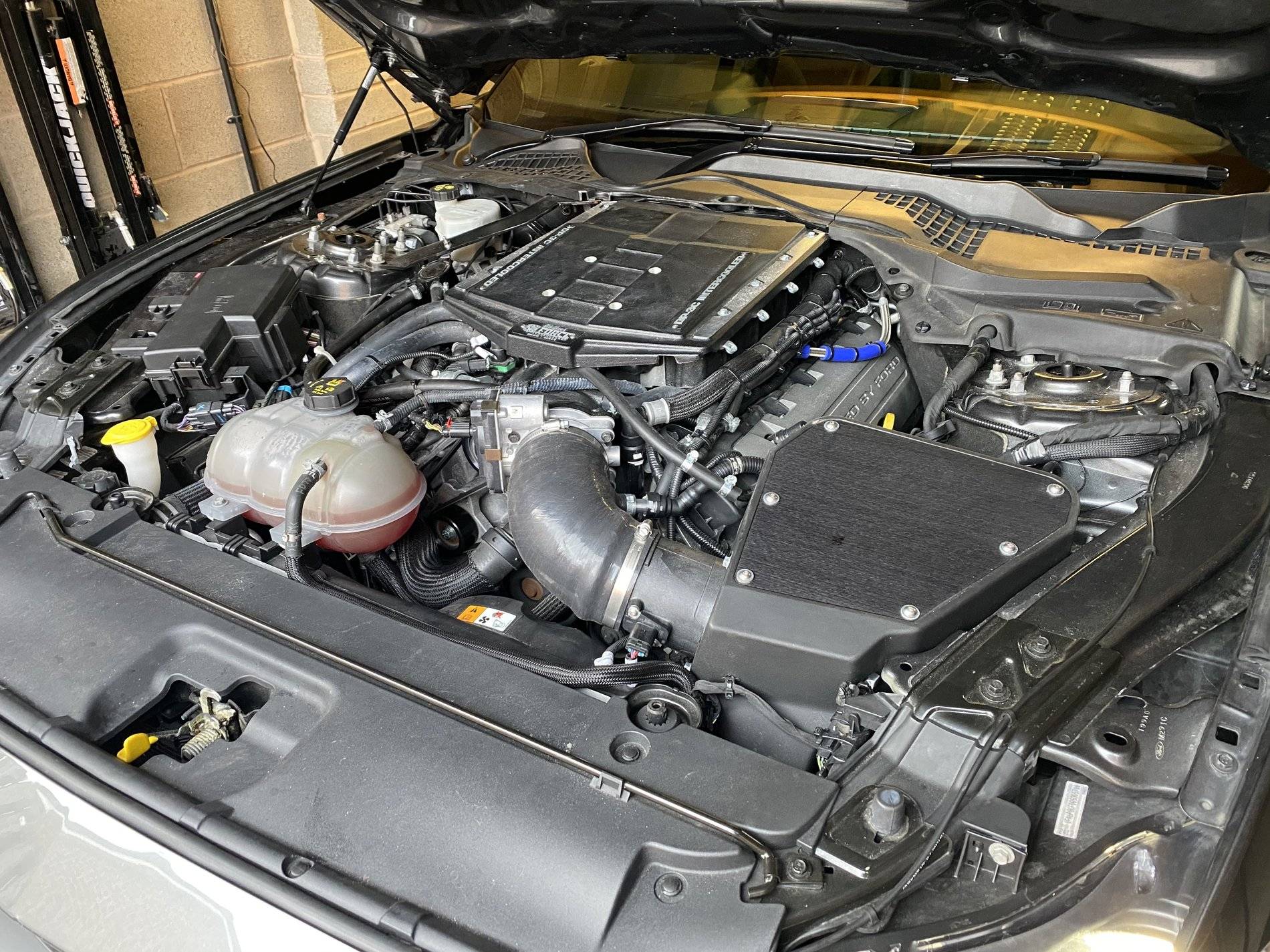

First thing I did was wrap the fuel line in some silicone pipe. On UK cars the fuel line cuts across the coil covers. With the side covers on it’s a shape edge against the fuel line. Only a matter of time until that burst.
Didn't your airbox come with the Edelbrock E-Force logo on top?
My stage 2 kit did not come pre- printed with the logo. I think early versions of the kit did. They do include stickers, in case you want to use.
I don't know why they would stop pre-printing it. Looks so much better with the print on it.
Nope, no stickers either. Didn’t bother me. Prefer the cleaner look.
