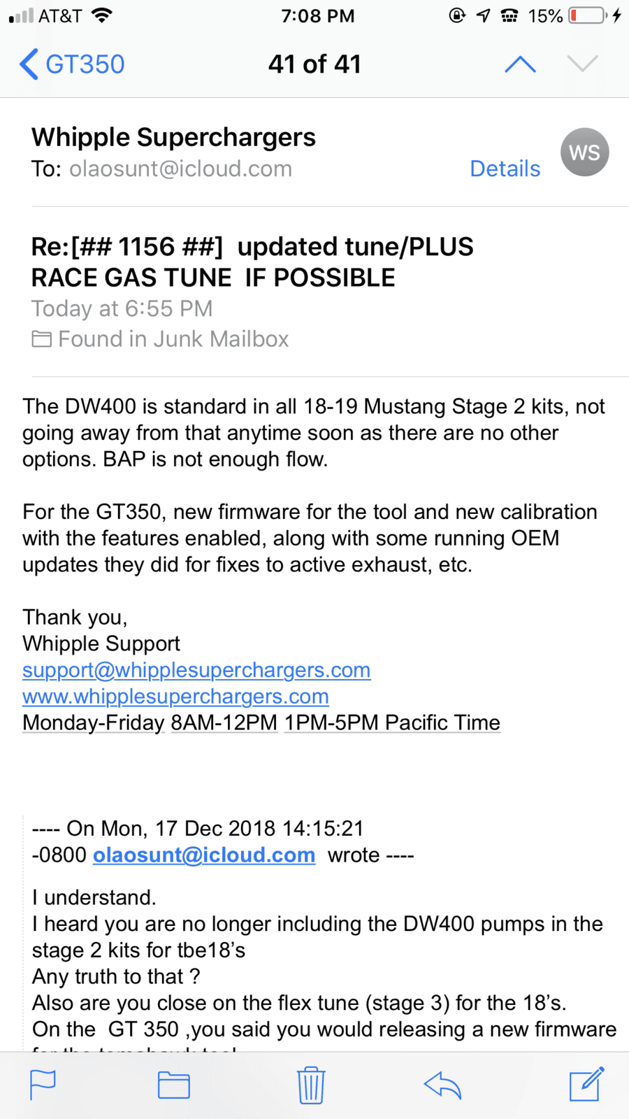

Also please note that the DW400 has no check valve in it. You may have issues with hot starts. I know Whipple does not include this pump in their 18 Kits any longer. Since the fuel will drain all the way back to the tank. I know they are working on an updated version.
Not sure where you got the info about Whipple not including the DW400 pumps in the stage 2 kits anymore but it’s not true .
I asked and here is what they said
