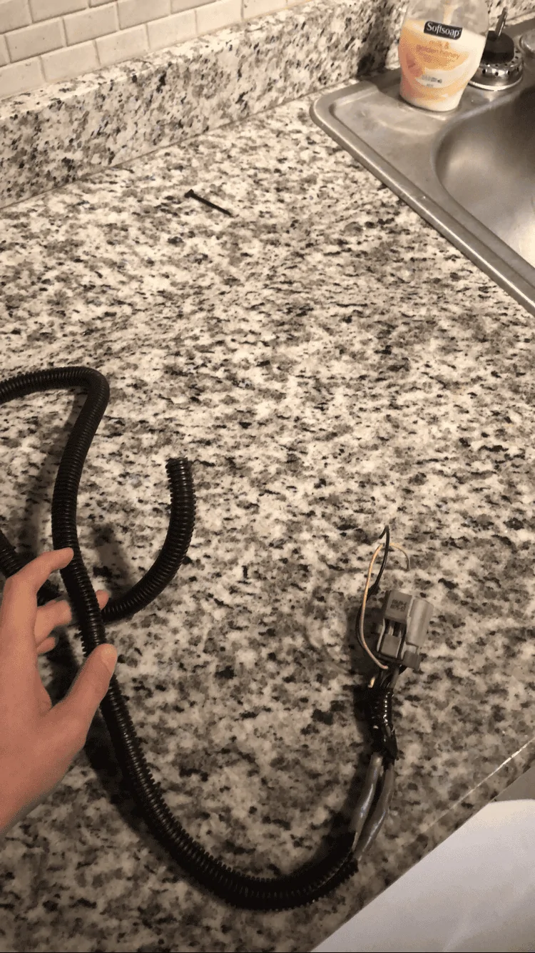

Does anyone now how to get their hands on just the harness offered in Sai Li's kit?
I imagine it's not terribly difficult to assemble one, but I don't know all the details (what relays to use, what gauge the wiring is, etc.)
Edit: included a pic of what I’m looking for.
I spoke with Sai and Lethal performance and both said they don’t sell it separately.

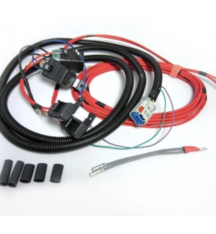

If it shows up with the tan connector then it will plug right into a GT500/GT350 hat, if it shows up with the black connector you will need to dremele off the 2 alignment tabs on the hat connector(not the locking tab)
Also, not sure why @LethalPerformance didn't mention it, maybe they forgot they carry it?

I actually have the tan connector, just not the other half of the wiring assembly. Think there’s a cheaper way of getting the rest of what I need? (It’s not a huge deal if I need to just pick up the lethal harness but if I just need a few wires and relays, maybe there’s a way around it?)

Not sure who you spoke to here but we're all very familiar with our harness and it is indeed available. You'll have to switch the polarity on the power/ground wires at the connector to make it function properly on the GT500/GT350 fuel hat.
Let us know if you have any other questions.

Is the harness offered with your Sai li kit the one offered by other distributors as well? Or are they assembling their own harness to sell the complete kit?
If you’re the funnel for everyone, then it makes sense to just pick it up from you guys.

It's our harness. Other dealers of ours may sell it but it's a Lethal Performance product.
Let me know if you have any other questions.

Yea i bought one and the tabs on the connector have to be filed down in order to fit the gt350 hat,the gt500 hat has different tabs also.

Can you make it specific /plug and play for the GT 350 hat on request?

So if I already have a 2013 GT500’s dual hat since I went fore triple, this harness would allow me to use the dual hat in my 5.0 ?

Unfortunately they only come one way. As mentioned the only thing that needs to be done to make it work on a stock GT500/GT350 fuel hat is switch the polarity at the 6 pin connector which only take a minute to do. The other thing is that the black connector requires the tabs to be filed which also take a minute or two to do. It's real easy. Sai does this with out harnesses to use on his fuel systems.
