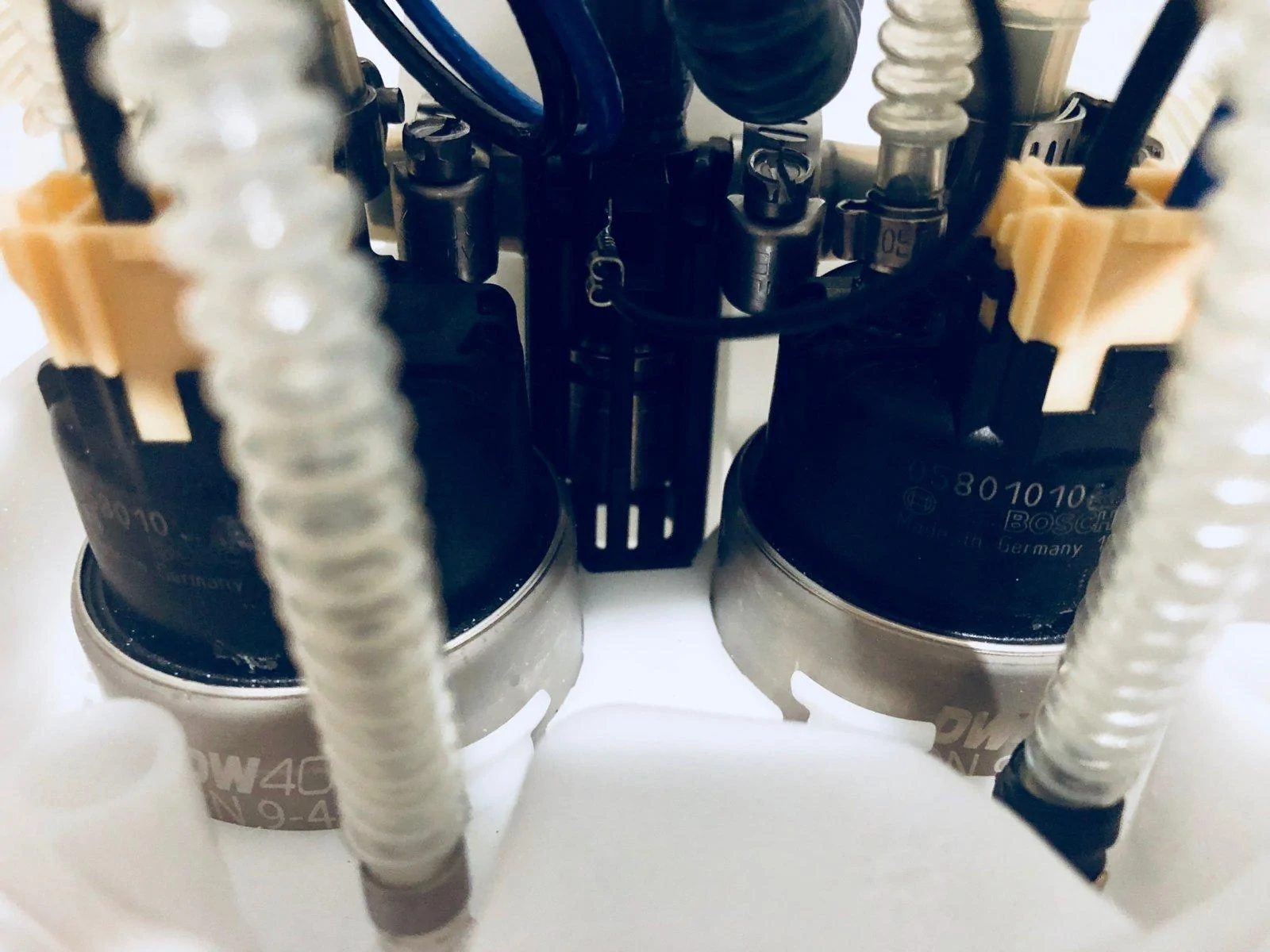

Since a single pump with a returnless system is rated to support 750 whp with E85.
What if you do a dual pumpset up with 2 ?
I am wondering if replacing the dual stock pumps in my GT 350 with the DW400’s would give me enough fuel for 850 whp on E85 without having to run dual BAPS .

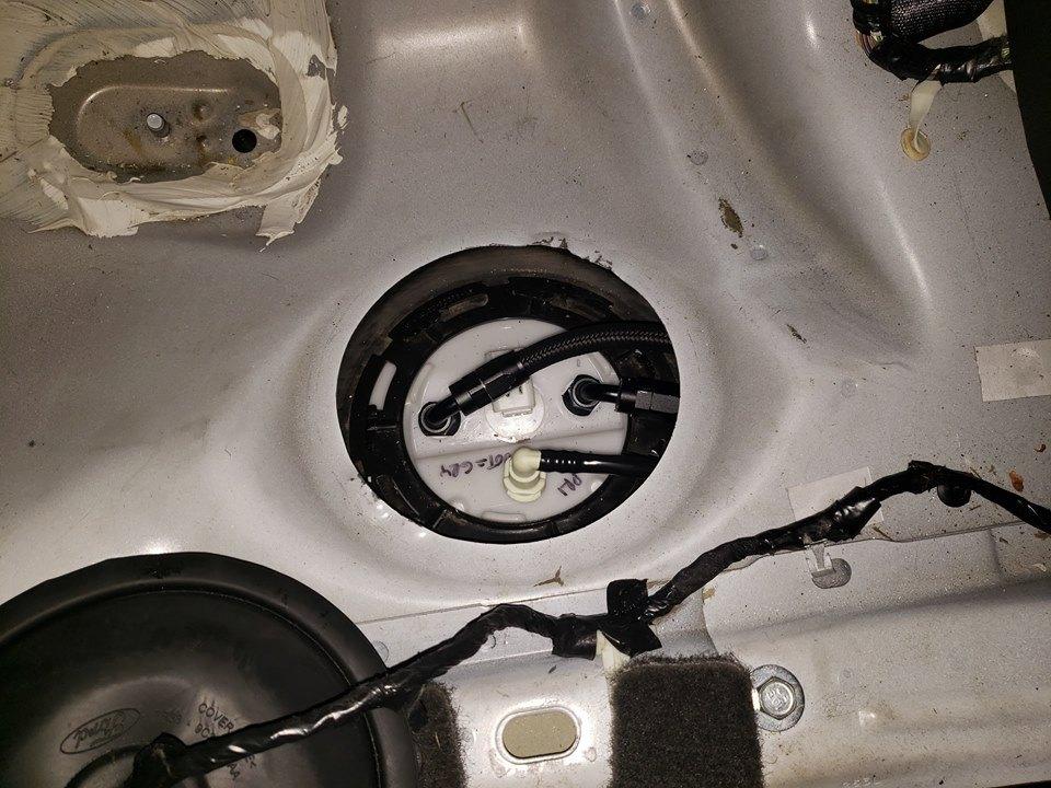

You can do dual DW400 in the stock GT350 hat, they have a ton of flow to them even at higher pressures you will see due to the pressure loss across the stock lines.
Ideally you will wan to add 2 6AN bulkheads to the hat and run those to a Y block(6AN inlets with 8AN outlet) then run the 8AN to your rails, then regulator, the return port will connect to the factory 3/8th port on the hat.
You can try putting 2 DW400 in the hat and keeping it returnless, but the GT350 car itself runs PWM for the pumps, so you will need to talk with your tuner and see if they have tune it to run the pressures you need them too. Also, you won't have boost reference if you stay returnless...I would just go return style..

Dual DW400 will flow way more fuel than the OE pumps ford uses in their hats, each DW400 flows about 80% more than each OE pump in the Ford hat, so they will support more power than its that use OE Ford pumps. If you plan to covert to return style, do it like in the pic I sent so you have less pressure drop from the stock ones, run dual out, to a Y bock, then 8AN to the rails and regulator

If you go that route you might as well throw a fore hat in there. you will be at 400-500 bucks in just pumps. You can leave your stock feed line in place and everything can easily be returned to stock. I used black ptfe line on my car and the only thing that you notice is the fuel pressure regulator.
That's what I would do, except I'd just run a radium assembly instead na d8AN to the rails and regulator, hide the regulator in the fender well and you wouldn't even know except for the braided hose feeing the stock rail

The F90000285 pumps flows like 5% less than the DW400, almost negligible for sure, but they are not set up for a stock hat, they lack the Venturi fitting to allow the factory cross hat to draw fuel from the other side of the saddle. It is a nice pump though if you toss it in a Radium or Fore hat, they do have a larger amp draw though...

The F90000285 is a nice pump, but the lack the additional fitting to allow the OE venturi set up to draw fuel from the other side of the saddle...only the DW400 has this fitting right now. Also, the 285 has a 22amp draw@80psi, vs the DW400's 19amps, even at 60ps it's 18amps to 20amps...the lack of check valve is no big deal, if it bothers you so much, you can add a inline check valve, but you can live with out it, even aftermarket fuel systems that use the 274 and 285 systems will have in line check valves
