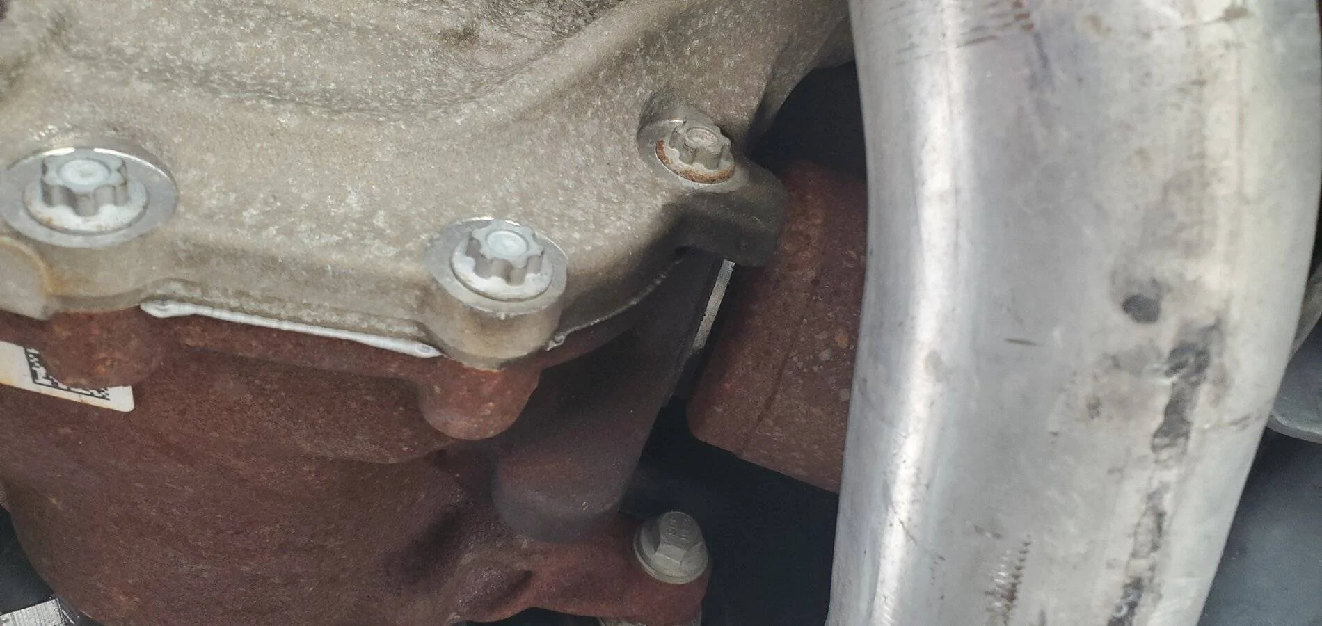

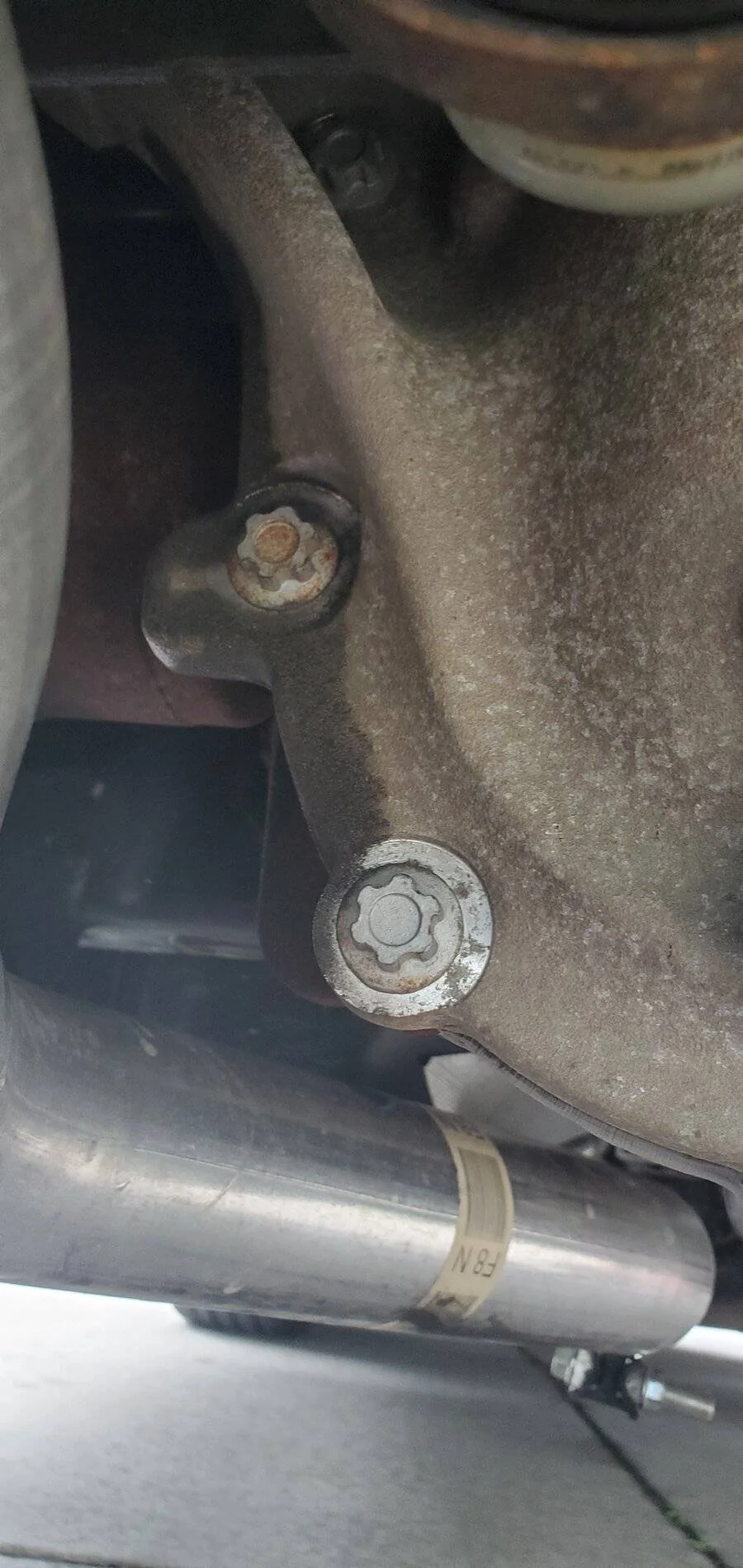

Does this look like too much slop to anyone ?

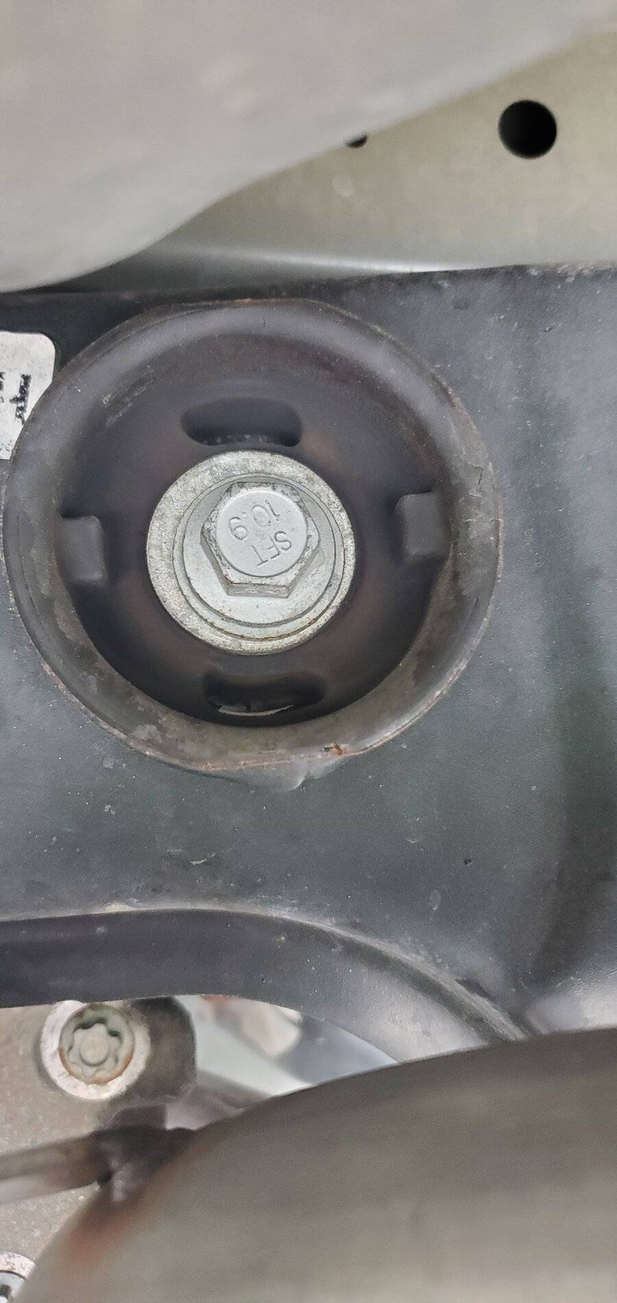

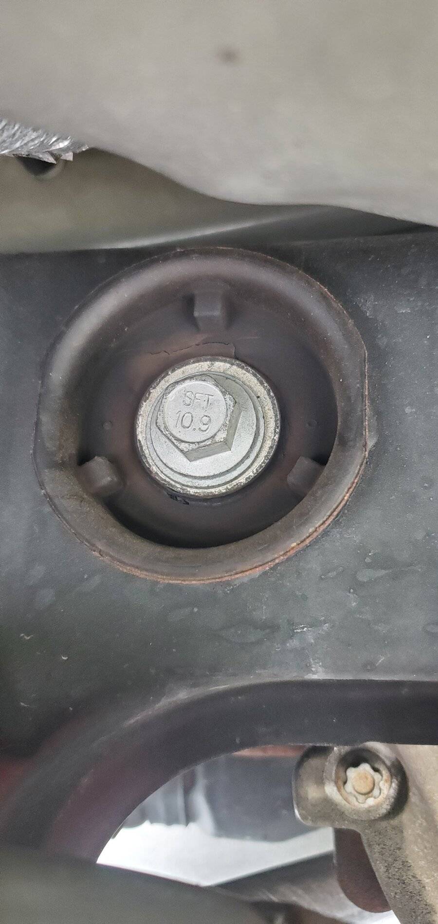

Also adding some pics of the diff. One of the bushings look like it's tore a bit. That looks bad?

1st picture of a mounting bolt looks like the bolt isn’t central (maybe the washer is throwing my eye off a little) - perhaps the bolt sleeves will help.
2nd picture of a mounting bolt shows a partially torn bush - perhaps the bush inserts will help to prolong its life.

I’ve installed diff. bushings in my car, but the bushings weren’t torn. However, I would be inclined to think that installing bushings on top of the torn bushings, to buy you some time. But complete replacement is the best way to go IMO.
I agree. Doesnt look fun to do tho.
