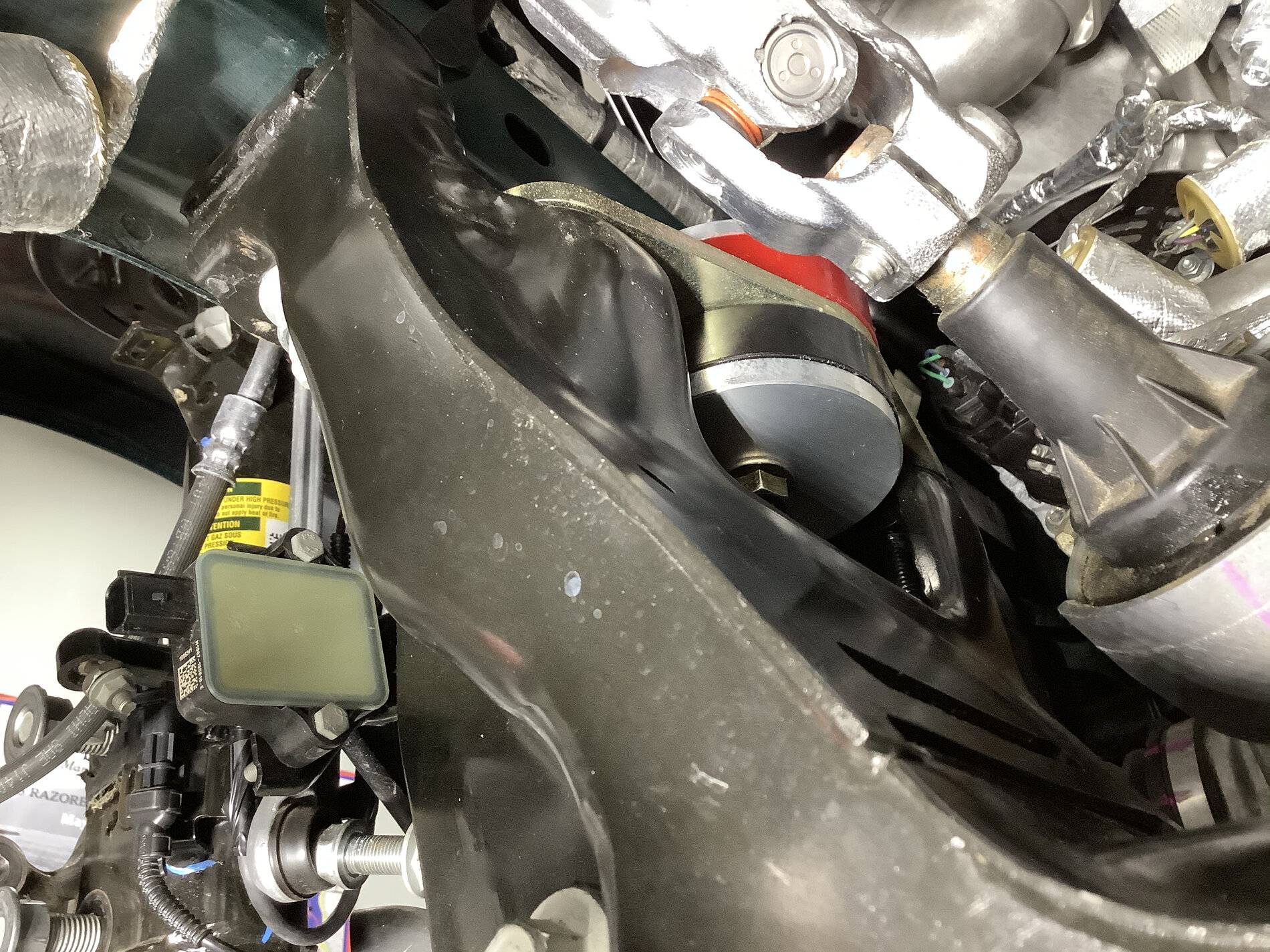

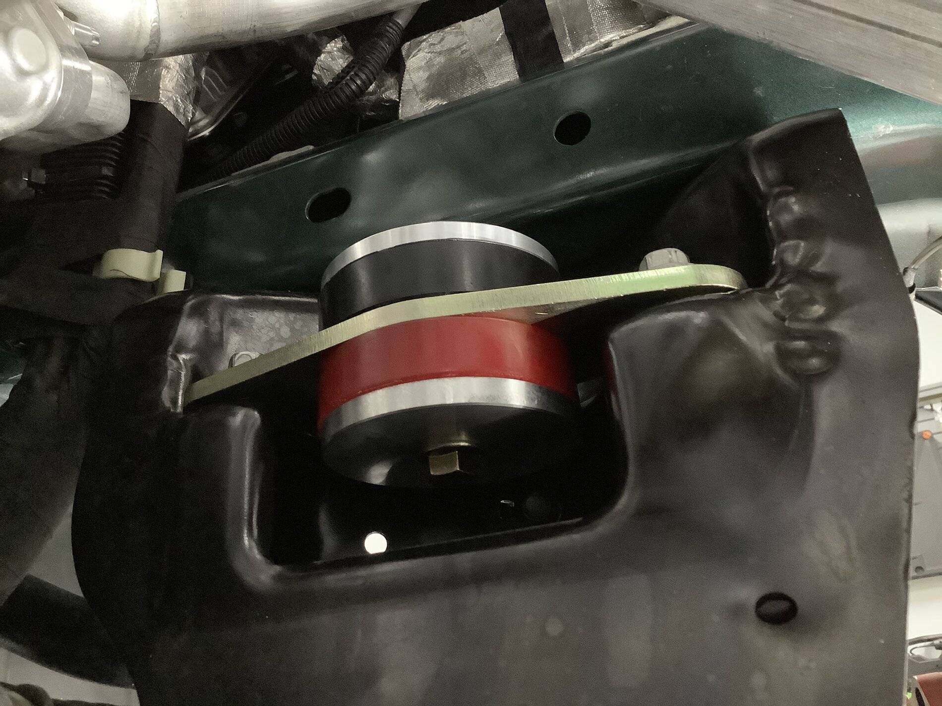

Those mods will definitely be a huge help. Note: Notice how I have a black bushing on top and red bushing on the bottom on the right side mount and the opposite for the driver’s side. This setup info. is in the instructions and is considered to be the drag race setup. It prevents engine torque-over which can lead to missed shifts too.

Oh cool. So you can adjust it for what you want.

Yep. You can also adjust the height of the mounts to lower the engine up to 3/4” if you need to gain clearance for something like a supercharger or headers.
