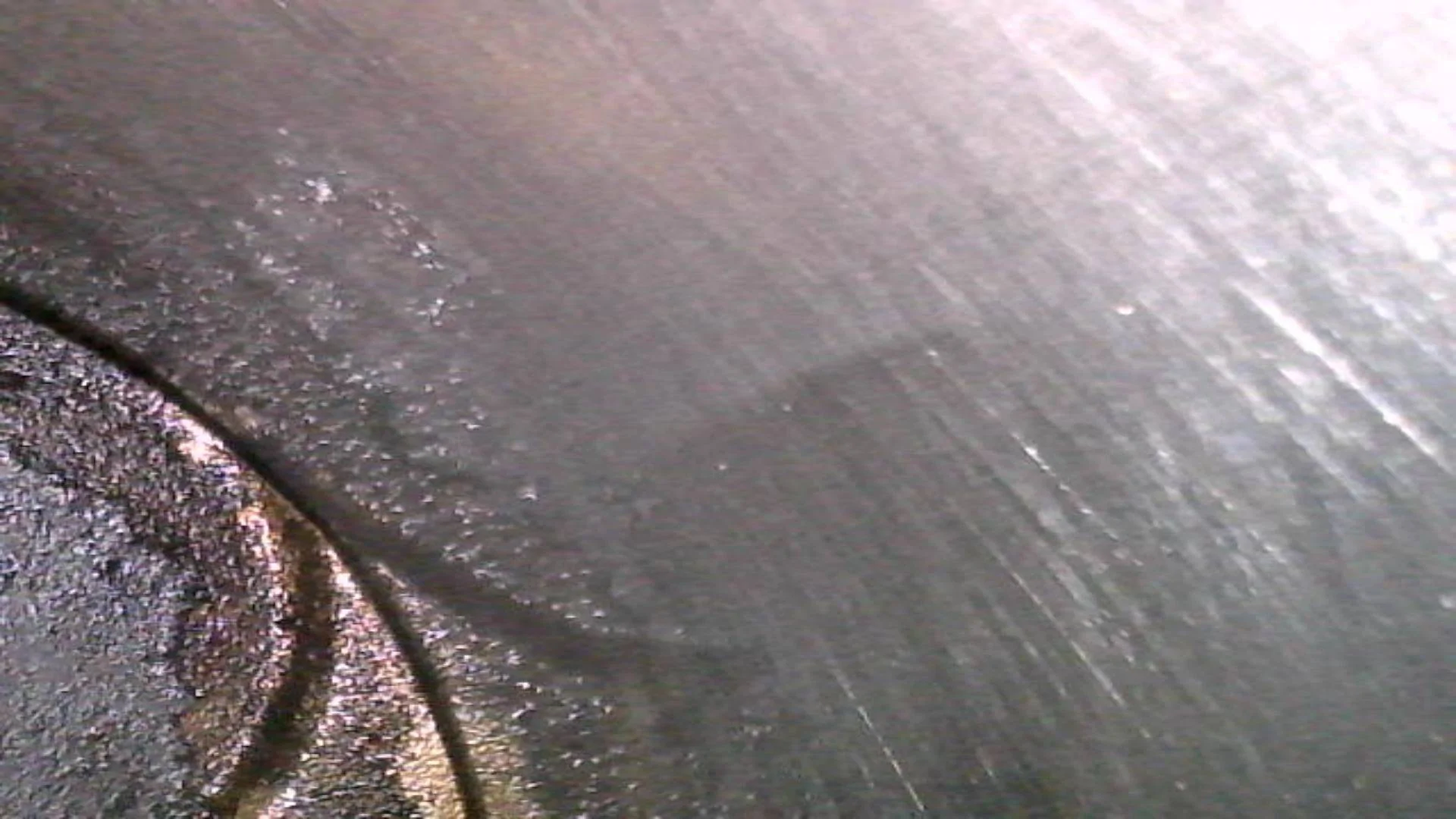

The darkened area corisponds with the piston coating. Doesn't show well but Its the cylinder in question. BTW when you cancel that cyl the noise reduces/goes away, only happens with cyl 3.
That doesn't look bad at all.

No it doesn't, it's what I have to show right now, my camera with pics of streaking are at work. However this is cylinder 3, the one with the noise. The others aren't showing an imprint of the coating. It's just a small piece of the puzzle. That photo was taken at 3000kms BTW.

Sounds like rod knock on both videos, not piston slap.
Further, the beautiful cross hatch in that cylinder pic indicates nothing wrong w that cylinder.

Yes, cross hatch is good in that Pic but in others I've got streaking that is hard to tell (from the glare iof the camera light) if it's cutting through the cross hatch.
