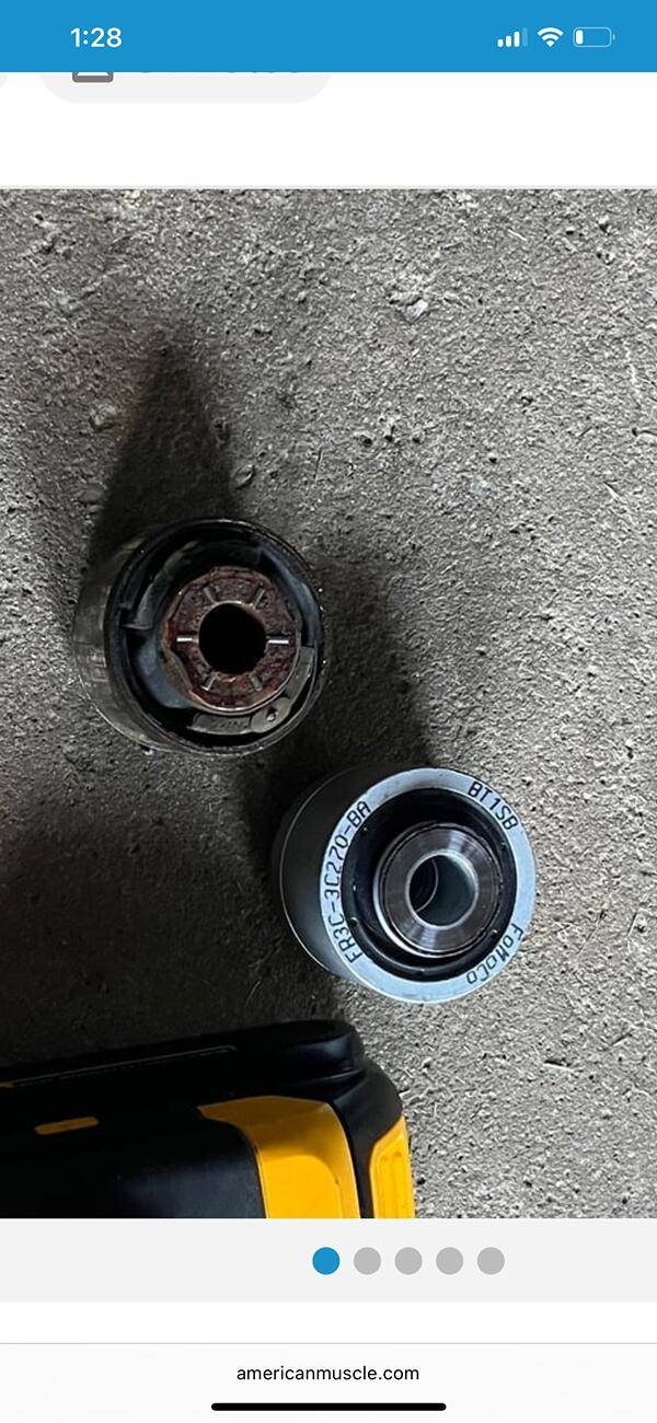

In about a week or so I plan on replacing this bushing. It’s the Knuckle to toe link bushing. The left one is the old one and the right one is the new one. I got under my car the other day and stuck my face right into this bushing and it looks a little chewed up and I’m wondering if it’s giving any sort of play so that I’m hearing this clunking. It’s weird if I hit a dip like into a sewer plate it doesn’t make the noise it’s only when it goes over a small bump.

I’m not who you’re asking but my knuckle to toe bushing were torn at 7k miles on my car and I replaced them with an option from beefcake racing (mechanic’s suggestion product over the ford racing). I’d read horror stories about getting the old ones out and the new ones in and paid a mechanic at the racetrack to do it. It was a 1.5 hour job for him while I waited and shot the shit with him.

After 3 hours trying to remove them with hand held press, I took to shop to press out and in done.
