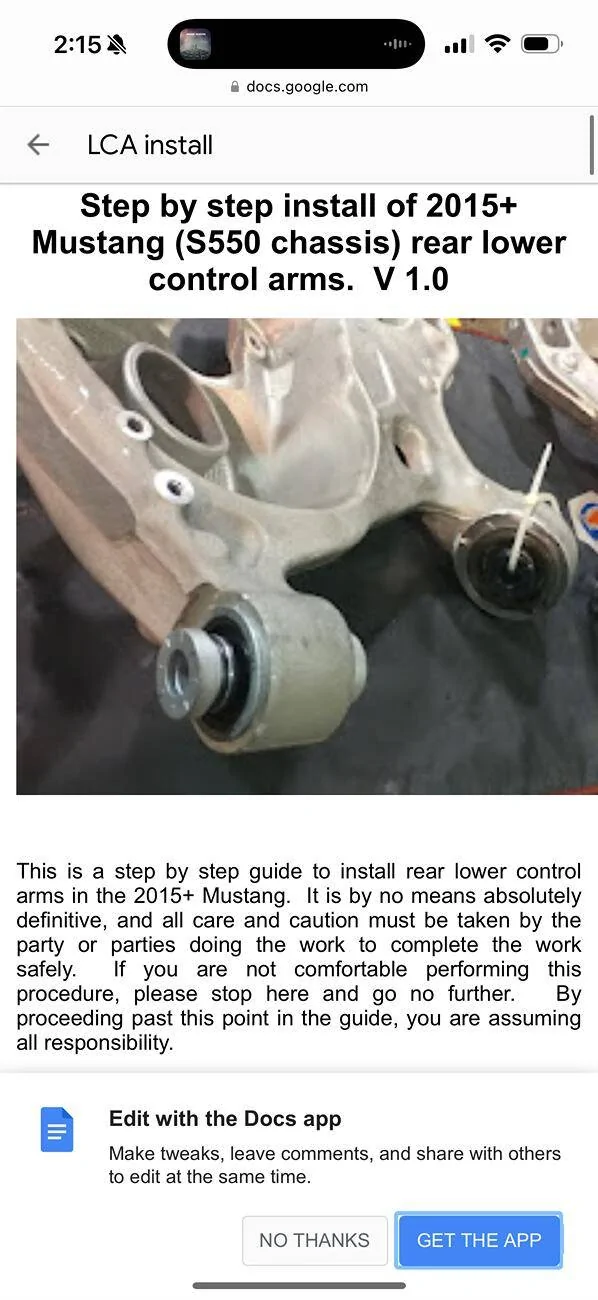

I have some play in this bushing on both sides. The bushing is pretty beat.
What is the best method of replacement? Replacing just the bushing or replacing the whole RLCA? I cannot really find it anywhere to purchase the whole assembly online.
