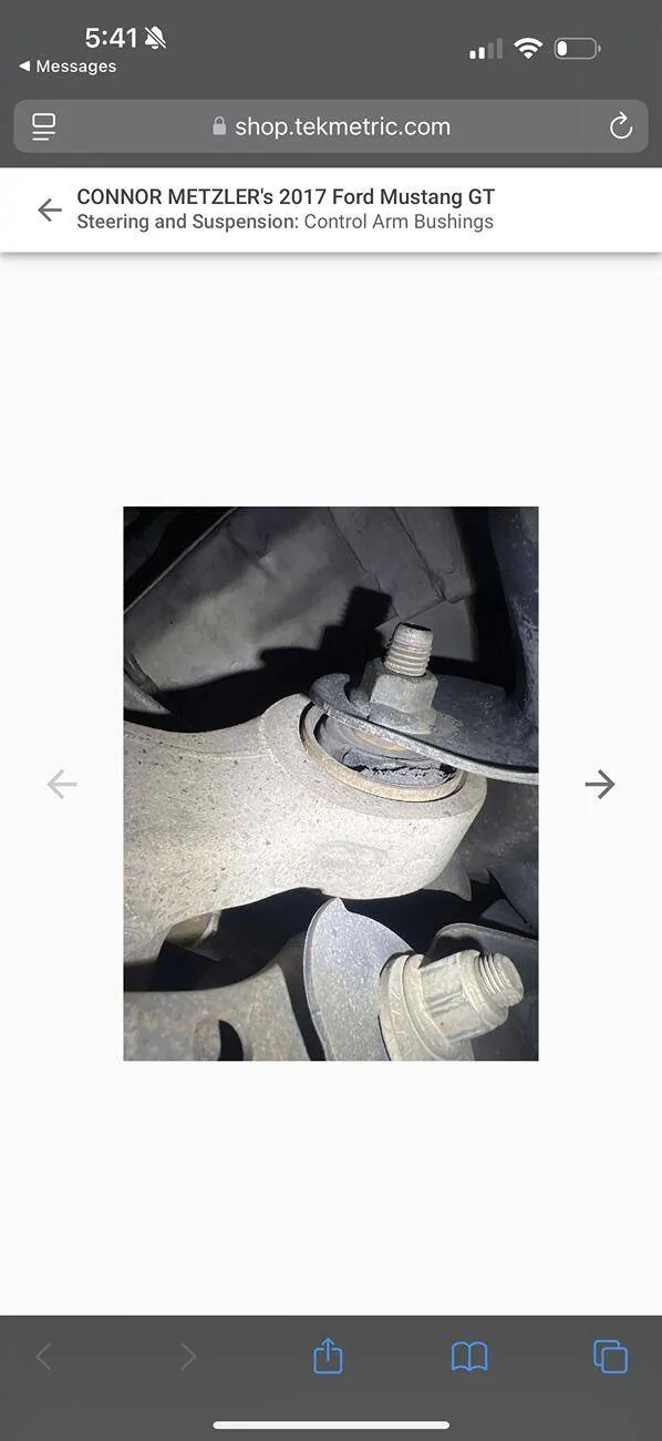

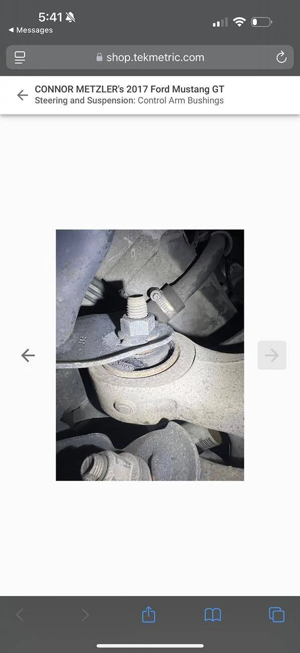

Just looking to update this post. Getting my rear lower control arms replaced tomorrow. Bushings are absolute TOAST. Car pulling all over the road may just be completely gone tomorrow. :)
Holy crap Batman. Those look like they have 200k miles and 20 years old. Yikes. Are you going back OEM on the bushings?
Yeah they’re just being replaced with moog replacement. They could get them in same day and have it done same day.
I am not sure why those bushings look so bad
Moog has good quality parts. I just never seen such worn out lca bushing. Good luck
