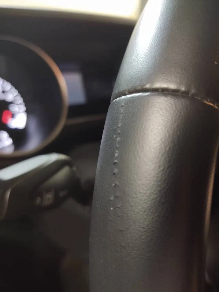

update: i have noticed that this tick noise only seems to happen when its warmer out. so of course when i go to visit the tech today its 60 degrees. he finds a creaking noise that while I hear isn't the issue and asks me to come back when its warmer. I also made it clear to the service dept that this scratch on my steering wheel was not present before they had it last time.

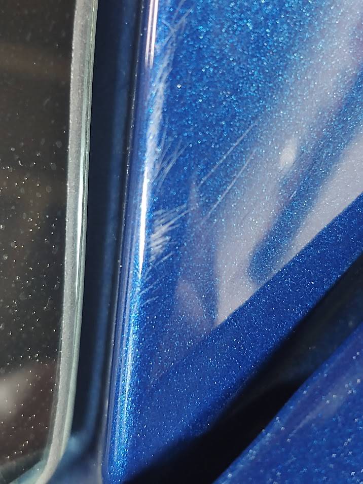

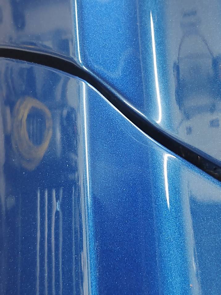

here's the damage from when they "fixed" my fender issue:
A pillar scratches and poor fitment.
notice the misalignment and haziness in the clearcoat. the only way i'd do business with this dealership again would be if they sold me a vehicle at THEIR cost. they are horrible.

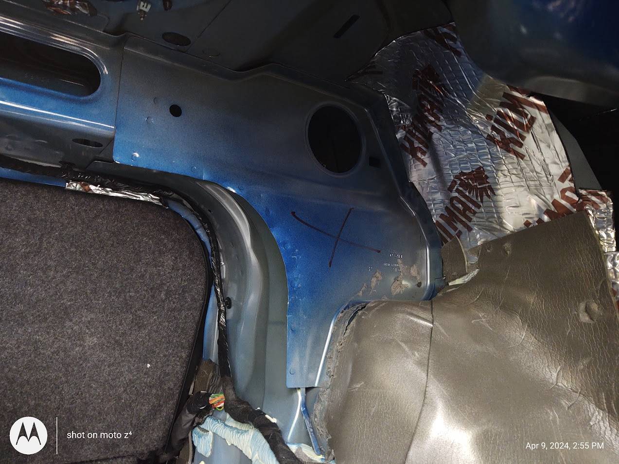

the new actually good dealership has been trying to dig into the noise, everyone agrees that its REAL, bad, and somewhere deep inside the chassis behind some spot welded stuff on the passenger side under the package tray above the trunk floor...somewhere.
Anyhow, they think they can fix it so hopefully that remains true.

Sounds like adhesive not sticking to panel properly. Looking at you. Bronco. I had that in my Bronco. I gutted it and did dynamat all over and fixed it. Have someone ride in the back and push on the panels and see If it quiets it down. It drove me bananas. I hate ticking and rattling. I’m like Captain Hook with that shit
