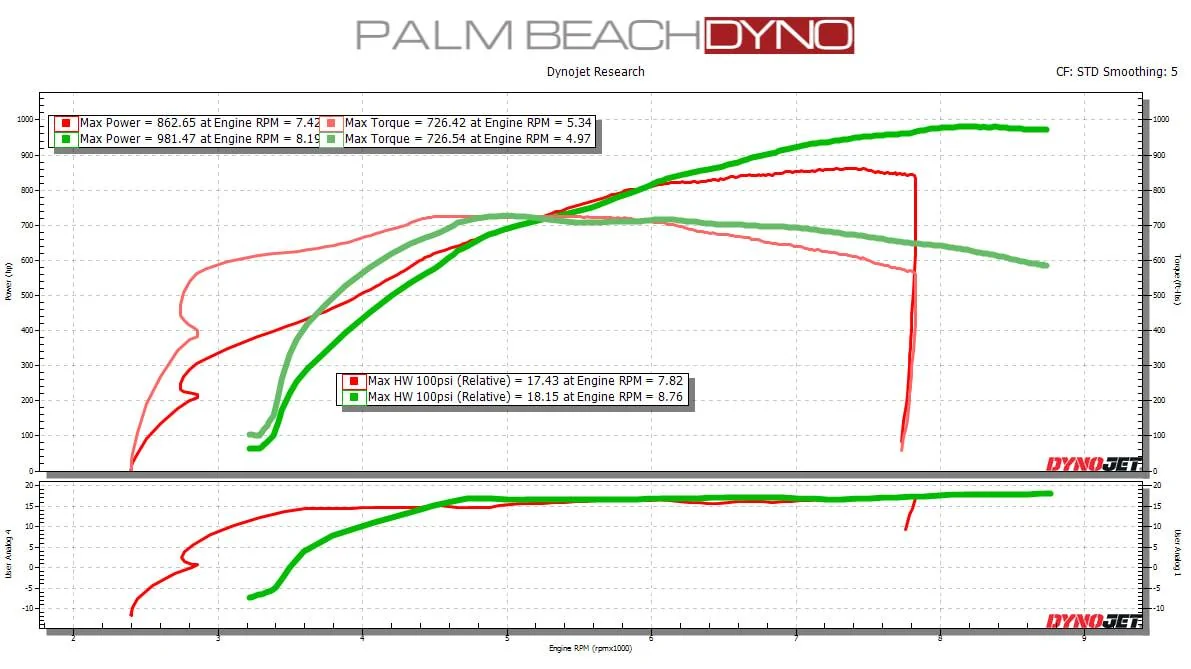

I disagree there, Efficiency varies by compressor design and speed/load. Chuck on a small pulley and although you get more boost and power, you are actually at a lower efficiency meaning a lot more power has been consumed to achieve it. Energy can't be destroyed, only transferred so where did it go? It turned in to heat.
You cant compare all the brands maximum polytropic or Adriatic efficiencies. It's not that simple, you have to keep the blower in the sweet spot to achieve those and many if not all blowers have smaller pullies on, putting them way outside the mark.
PDs make more power down low because that's their highest peak in efficiency. That's not where I want my peak. I don't want power under 4500rpm, that's only for cruising and tickover.
look at a pd Dyno Vs boost, youl see it dropping off towards the end no matter what brand, it's the flaw of that design. But if you want all out low rpm torque, that wears gearboxes/ drive train and smokes tires, itl do that for you.
fit a smaller pulley and now you're really pushing the limits of usefulness, your peak is now even lower in the rev range. Although you've gained another 40whp, you are generating a shit load more heat for the intercooler/ engine to deal with in terms of a square route I imagine. Hence the requirement for crazy chiller coolers and such for PD cars. Again all added weight to the front of the car or additional parasitic loss through the crank pulley from driving the alternator and or AC compressor, a weak point on the coyote so best to not go there.
If you need it to work for 10 seconds only then fine, you can let it all dissipate before the next run or fill the airbox with ice or what ever but imagine doing a 12 lap race! Totally useless.
Show me where "the boost drops off towards the end"
This argument is really becoming tiresome
if a pd is the best low end, best top wnd, best thermal effecient, using the best water cooled system, and is still cheaper than turbos, why on gods green earth would anyone buy anything around 10k other than a whipple?
unless you want to spend 5k on an entry level ess, everyone would buy a 10k whipple that “does it all the best”
unless of course, maybe its not the best top end, nor the best heat effecient? Food for though that maybe if theres even a debate of which to go, that the whipple CANT be the best at everything just cuz u throw out one dyno with no emphasis on what it means and whats done to it
knowing what ur showing so far, youd show a killer chiller pd and claim “thermal effecencies” 😂
That is a fantastic Dyno, who's ever it is. However 18psi all the way to just shy of 9000rpm is a little out of my price range considering I want my engine to do this for more than a few seconds.
I think that's the point being made here!
Nobody is saying 'Whipple is the best'. I don't know what you're going on and on about. I just replied to someone who said the boost drops towards the top.
