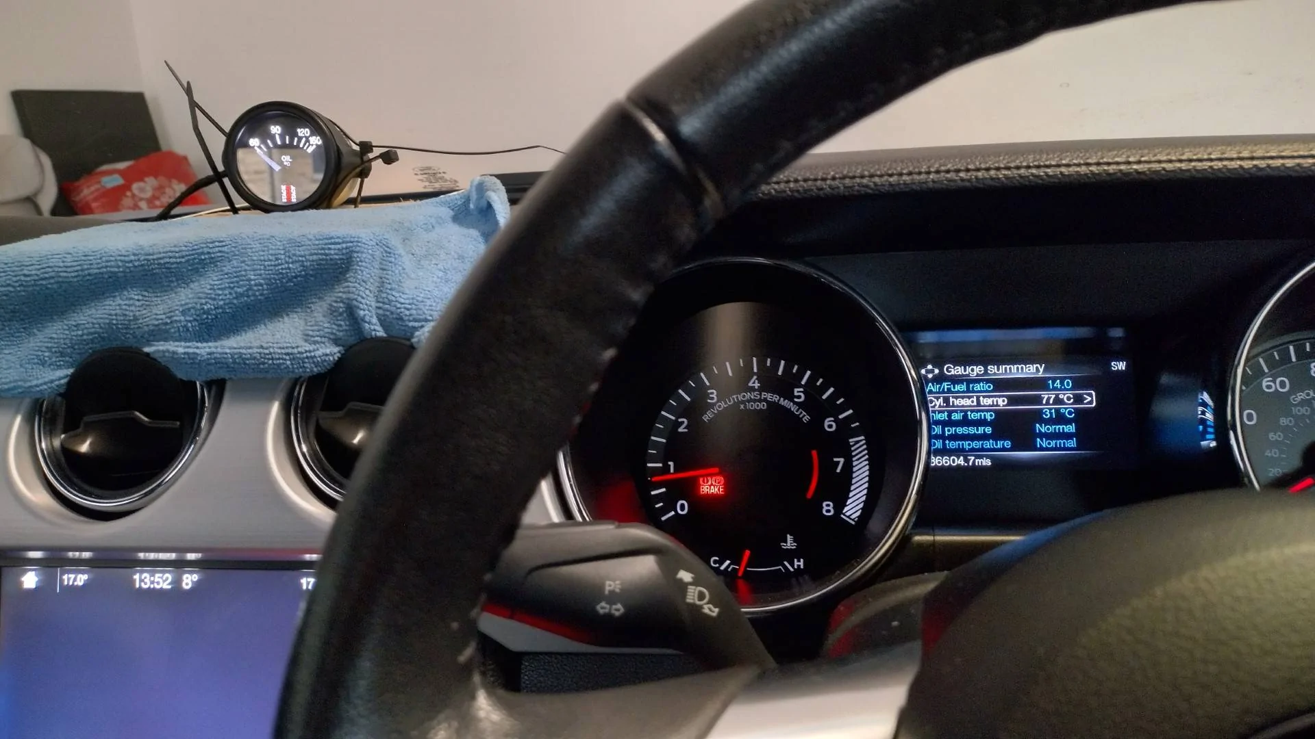

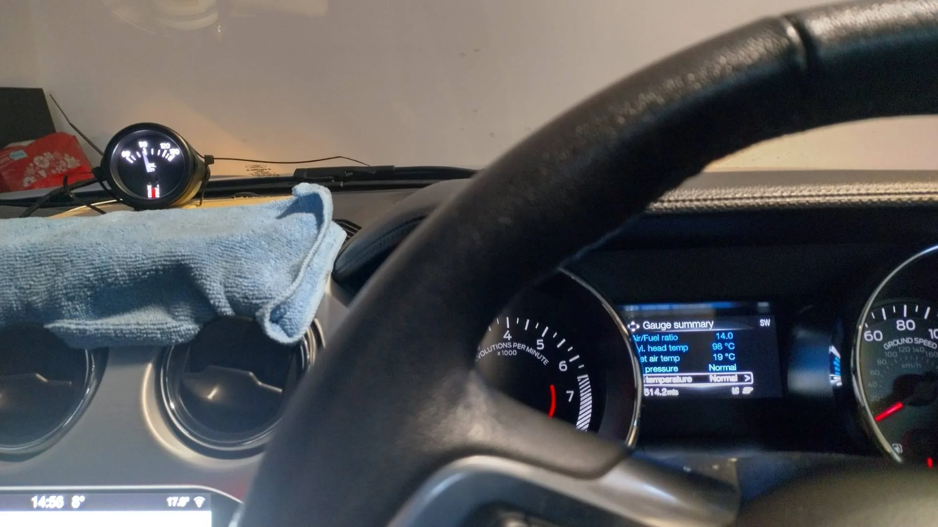

annnnnnnnnnnnnnnnnnnnnnnnnnnnnnnnd finally I have managed to get the oil temperature gauge hooked up and get some data. Now, this is a temporary solution and it's not for resale (esp since I messed up the design concept should have made it more rhd ie pointing towards driver (me) rather than worldwide point centre / center) so please forgive the abomination of positioning and er attachment but at least I can see while driving and hopefully it wont slide off the dash either! Note use of centre vents to hold microfibre cloth into position and hide the block of wood from the drivers eye line :facepalm:
Exec summary - we need a third person with a decent gauge to get another independent result as my Stack gauge did not peg the red (or anything near it).
Anyhow. So after fitting the gauge we warmed the car up and checked nothing was leaking from the sensor fitting at the engine. Nothing leaking. Let the car warm up a bit and check new gauge versus dash and as the dash oil temperature was going into the green, the new gauge was just moving off the 60degC marker and the infrared on the sump was 60degC also. So, on the road testing. I was cruising 60mph and the oil was just over 90degC, bumped the speed up to 70mph and oil was just over 90degC. Drove into private testing area and yeah managed to get oil temperature up above 110 maybe 115degC but that was getting on about and running out of runway, backed it off and the oil temperature came back down (not rapidly i have to say) to just over 90degC. Normal motorway running it stayed about 90degC BUT i had the gauge in the glovebox lid so it wasn't exactly in eyeline so was quick glances. Todays air temperature 8degC according to Sync 3
So first pic is after car had been sitting for 90 minutes or so after the drive home after fitting so this was just after startup for me going back out again.
below pic is after getting home from shopping which was 50 and then into 30mph into residential crawl then stop at home, idling for 30 seconds. Notice the crude / casual modification using a cable tie to nudge the front of the gauge into more of an angle towards the driver... deary me.
Further testing to be done but i am not seeing 120-130-140degC under anything like normal driving, not even close to those temperatures. Peak was just over 110degC WOT at the top of er yeah a lot of gear.
Again I profusely apologise not only for the delay in getting this snizzle hooked up but mainly for that gauge mounting solution. I hang my head in shame :blush: :blush:

brilliant work!! So, we now have two completely differing tests?? So, if your test is accurate and mine is bollocks, we don’t need a cooler for everyday use? I would be more trustworthy of stack over my cheap thing.

true your gauge is a little more suspect re quality but with only two results and two completely different answers i dunno where that leaves us tbh. The one constant is we both used same pick up source for the sensors so yeah comes down to gauges / sensors. If you want to try a branded gauge and see what you get? Might help answer the question or worse case back up your original results. How rubbish would that be lol
One thing i need to do is run with the OEM dash oil temperature gauge and see how it moves in relation to the external oil temperature gauge. I've been using the CHT as it is more animated, you confirmed that it is actually hooked into the coolant passage yes and not the metal of the head? Its a real coolant sensor in that respect versus the rest of the inferred gauges ?
Need a third person to try with the oil cooler delete and a fourth person with the OEM cooler in place to try this.....
