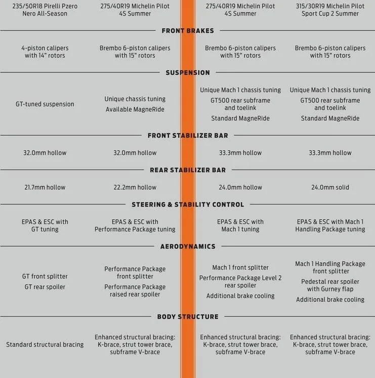

There is NO difference between the PP and HP Mach 1 other than spring rates the fact that the rear bar is solid on HP and hollow on PP, HP gives bigger wheels tires and spoilers and camber plates. All the rest is exactly same. Basically it’s just like a FP handling pack for Mach 1 with wheels tires and bigger spoilers.

As far as I am aware, compared to PP1, M1 has:
1. Oil Cooler
2. Trans cooler for Tremec, better trans cooler for 10r80
3. Diff cooler
4. Shelby car front/rear subframes
5. Updated brake cooling
6. Shelby magride dampers(GT500?)
7. Shelby springs
8. Larger sway bars

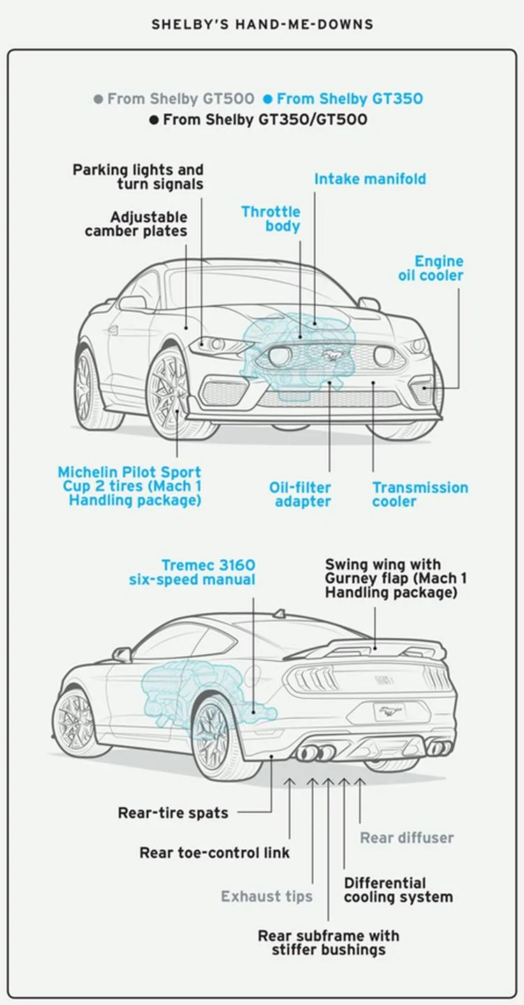

From my research:
BULLITT
Engine – Modified Bullitt Engine
MUSTANG GT PERFORMANCE PACK 2
Spoiler
Brembo Six-Piston Front Brakes
Engine Spun Aluminum Instrument Panel
Gauge Pack (Oil Pressure and Vacuum)
Heavy-Duty Front Springs
K-Brace
Larger Radiator
Performance Rear Wing
Black Painted Strut-Tower Brace
TORSEN Differential with 3.73 Axle Ratio (Manual)
TORSEN Differential with 3.55 Axle Ratio (Automatic) (PP1)
Unique Chassis Tuning
Unique Stability Control, EPAS, and ABS Tuning
Upsized Rear Sway Bar
Front Splitter
SHELBY GT350/GT350R
Air Intake
Intake Manifold
Engine Oil Cooler
Oil-Filter Adapter
Tow Link
Tremec Six-Speed Manual Transmission
Throttle Body
Transmission Cooler
Michelin Pilot Sport Cup 2 Tires (Mach 1 Handling Package) (GT350R)
Lower Front Vents
Stiffer Bushings in Front and Rear Subframe
Tire Fitment (Mach 1 Handling Package)
Incandescent Park/Turn Lamps
Adjustable Camber Plates
Differential Cooling System (GT350R)
SHELBY GT500
Rear Axle Cooling System
Rear Diffuser
Exhaust Tips
Mufflers
Rear Tire Spats
Swing Wing with Gurney Flap (Mach 1 Handling Package)
Rear Toe Link
Splined Intermediate Steering Shaft
WD Pro

Trying not to go through everything with a fine tooth comb or be nit picky, but these things immediately jumped out and / or I have a genuine interest in finding out more :
SHELBY GT350/GT350R
Tow Link
SHELBY GT500
Rear Toe Link

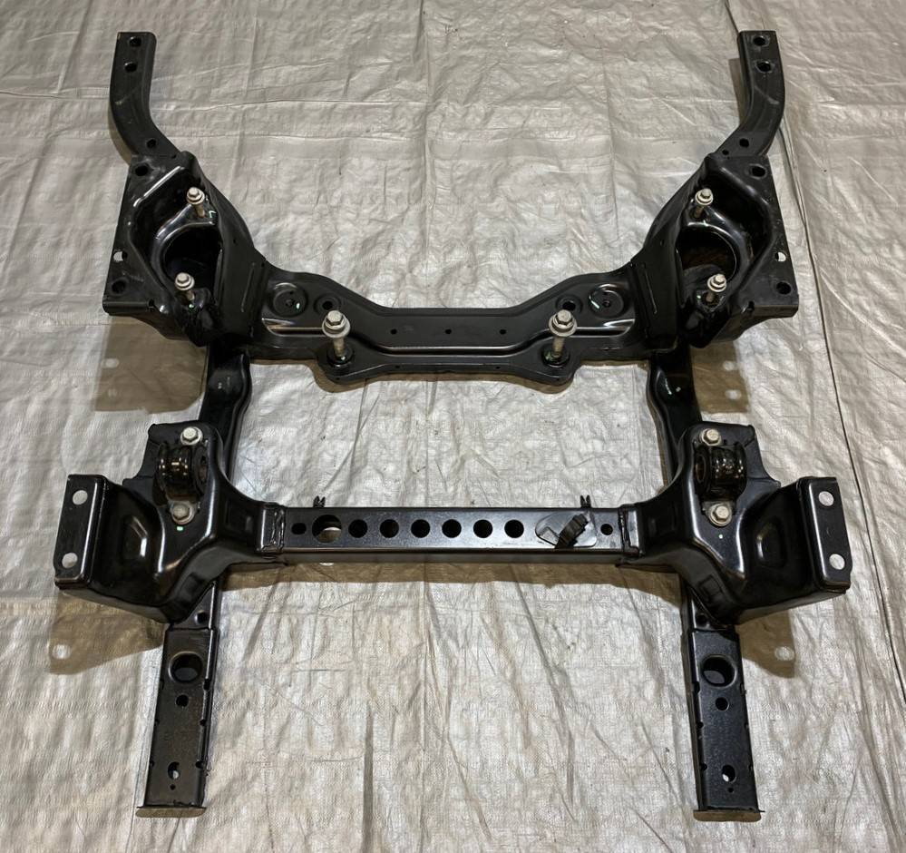

Do we know what's actually different with the tow link ? Another (M1) forum user removed theirs, and couldn't find any difference between it, and one from a PP1 (including the toe link bearing - which is still rubber in the M1)
SHELBY GT350/GT350R
I know about the rear, but what about the front ?
Unless I'm missing something, unlike the rear, the front subframe (all models) bolts to the body solidly :
So is the comment referring to other things that bolt to the subframe - engine mounts, front arms etc ?
SHELBY GT500
Exhaust Tips
Mufflers
Exhaust tips are M1 specific, attached to a GT muffler :like:

I researched and found these from articles written by Ford and Car magazines. None of them really went into specfics of each part. Ford Performance should list each part they added from the Shelby's and list the actual difference instead of us having to gather information from other sources.
