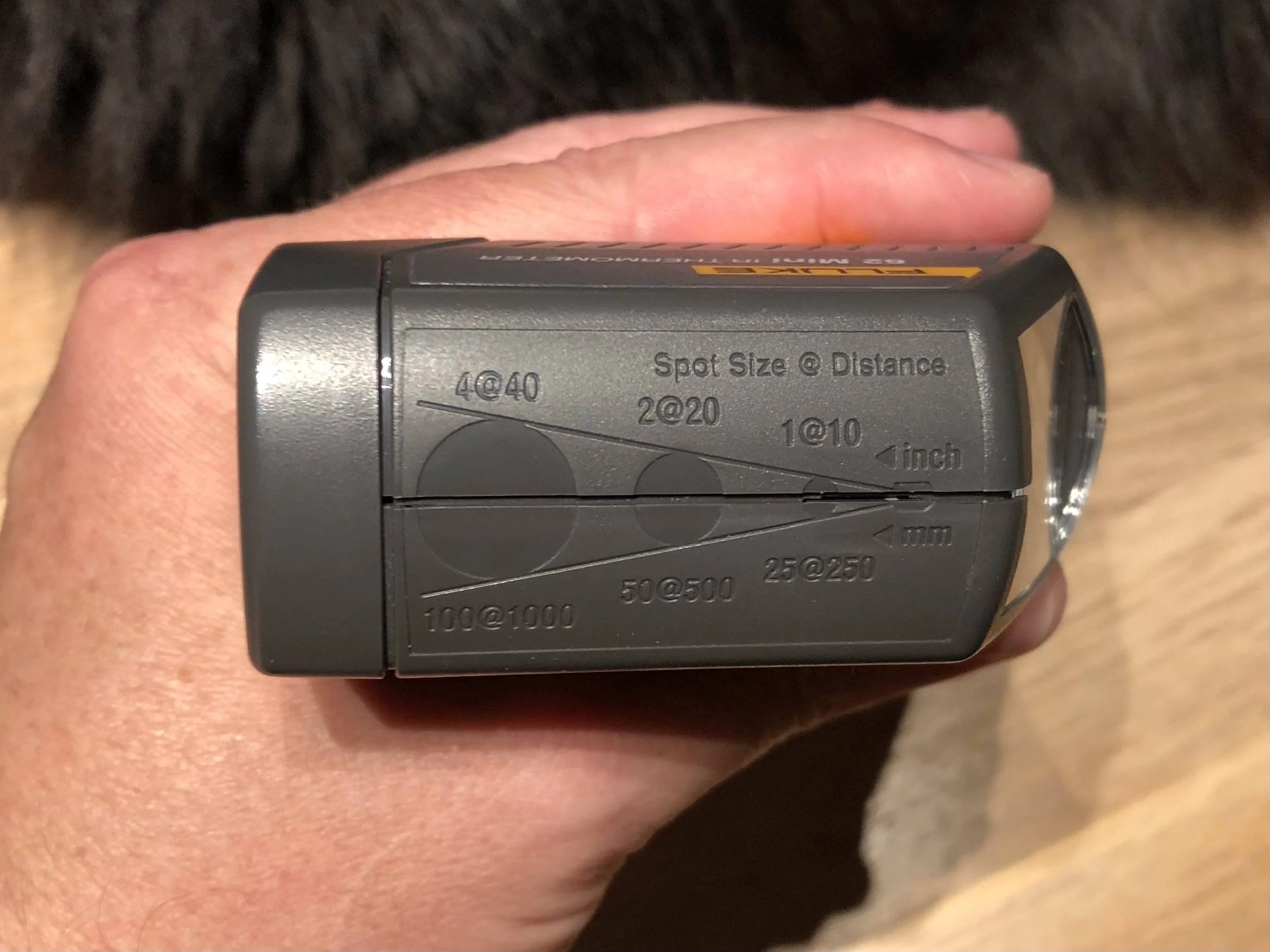

Another interesting video thanks Nige.
Think your latest infra red thermometer will give approximate readings only rather than actual oil temp for the reasons you gave in your “beer can “ example.

Hey thanks for the mention on your video :like:
Just few more things to consider :
The infrared guns increase their measurement spot size as distance increases, so shooting from as far back as you did and expecting maximum accuracy can be tricky. as an example, here’s the info on the top of my fluke :
I don’t think they like breezes or chilled / hot air getting inside the bore that shrouds the lens - I’m sure I read something about that if using them up close to check aircon vents etc. Maybe that phenomenon messed up your beer can test ?
