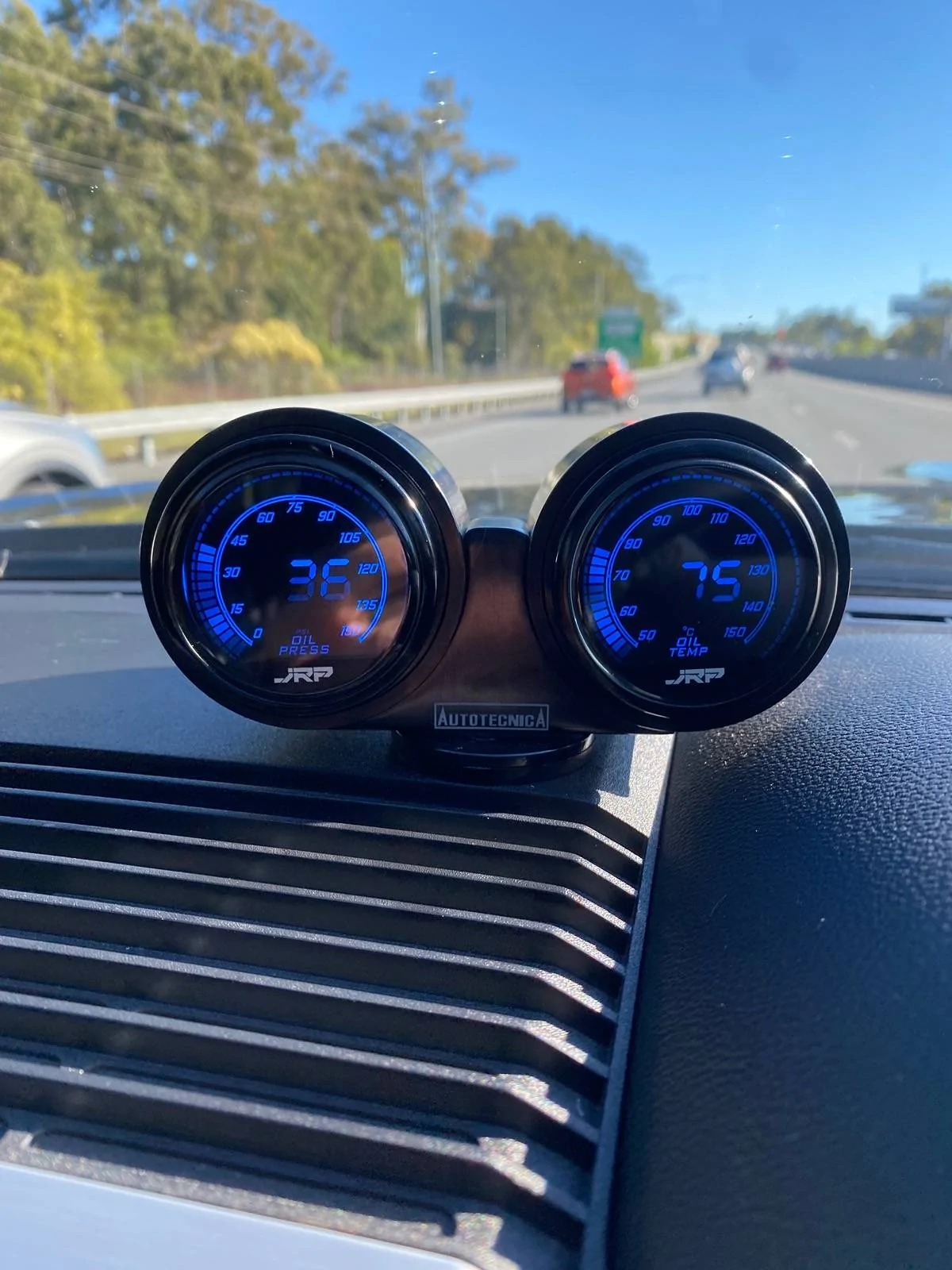

UPDATE !!!!!!!!!
finally after a long drawn out process my I put my sleeved/built motor back together and it’s running magic.

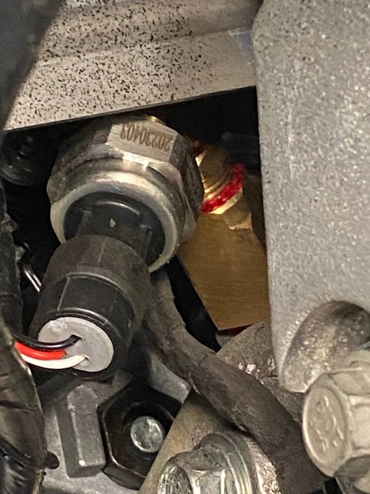

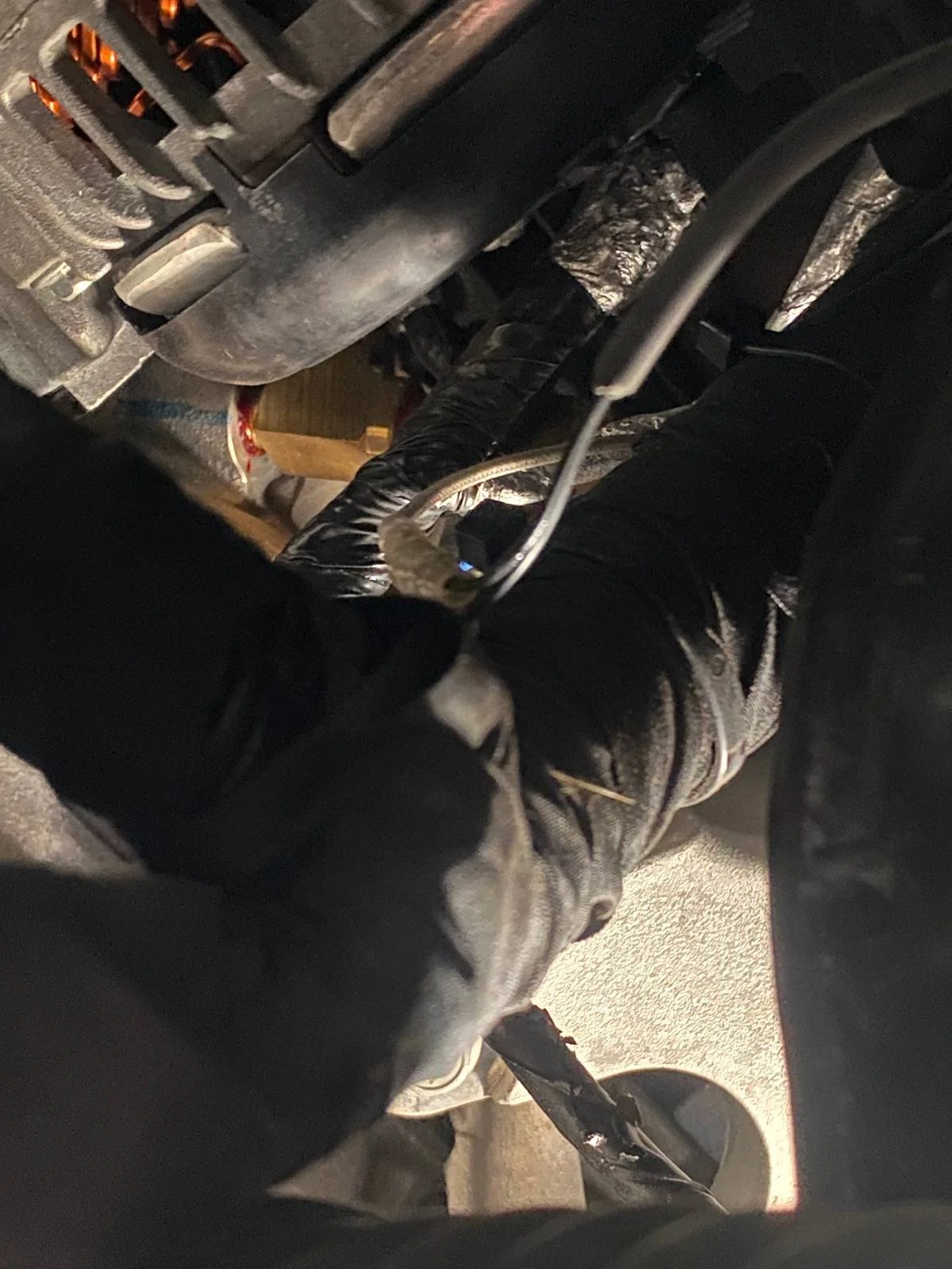

I added a Mishimoto block off plate and got rid of the factory useless water/oil cooler crap.
added simple brass extension with Tee to enable me to run factory oil sensor and also an after market oil temp and pressure Sensors.
not much room on an ozzy/uk coyote , but doable.
ive Been running the engine in , hard long simulated dyno pulls…. 2k to 5k. 3rd , 4th and 5th.
200+kph (125). multiple days of this type of driving and plenty of country mountain roads etc.
ive done 750kms on the new engine now….. zero issues with oil temps.

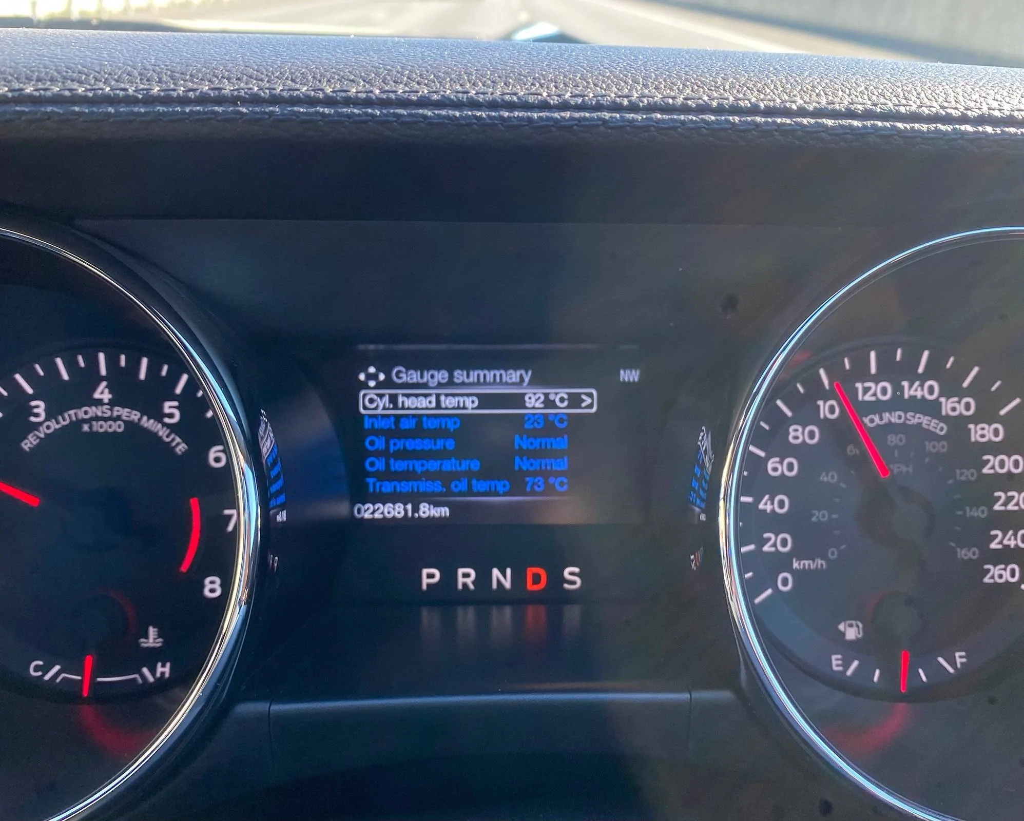

these shots are cruise on the highway at 100kph ( 60mph) 36psi oil pressure and 75’C ( 167F) oil temp.
removing factory oil cooler and using the block off plate has made ZERO difference in oil temps in my experience
cheers
Tim.

nice one, way way better gauge setup than i had haha. Must admit, I'd have expected both pressure and temperature to be higher at that speed but yeah defo not too hot on the oil which is good to know it wont boil/ breakdown in the engine
