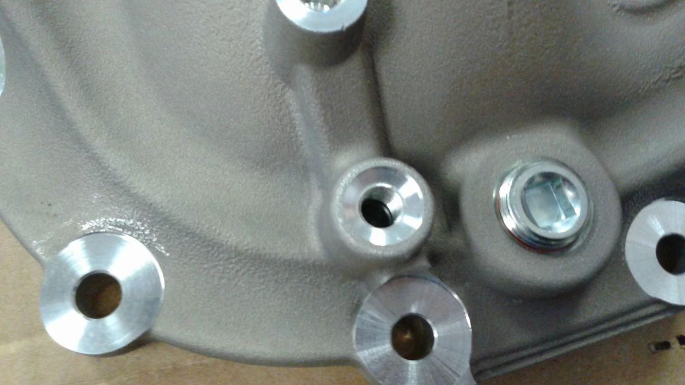

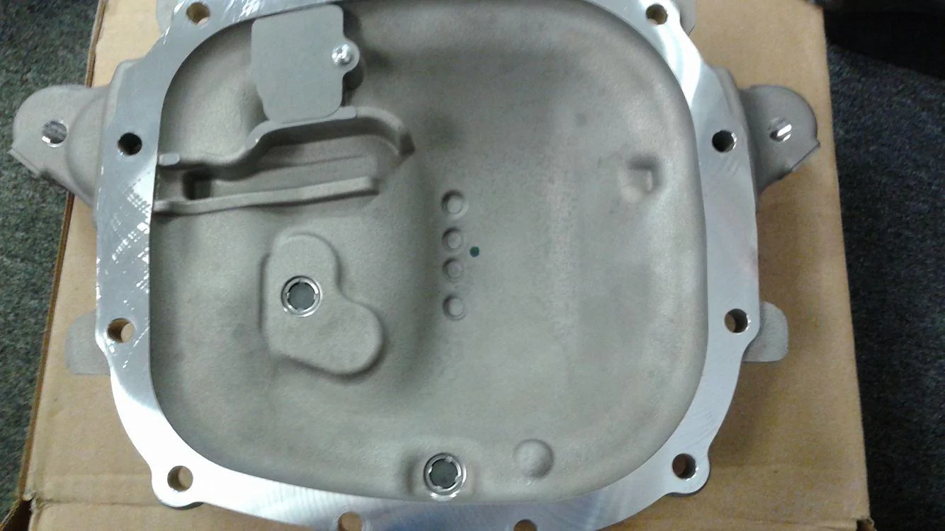

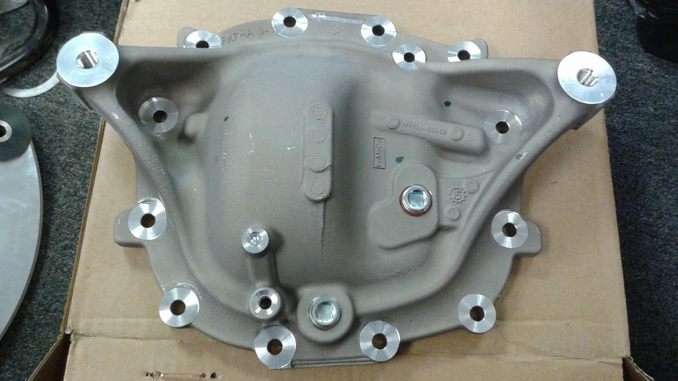

Here is a look at the 16+ diff covers with temp sensors.
The sensor is to the left of the drain plug. It does not go all the way through/into the oil.
I grabbed this one to make a custom cover, larger capacity with cooling features.

Can you tell me the thread size of the temp sensor port?
Also, does anyone know if the wiring is in place and a sensor could be added to a 2019 GT, non-PP, and could it be enabled with FORSCAN somehow?
