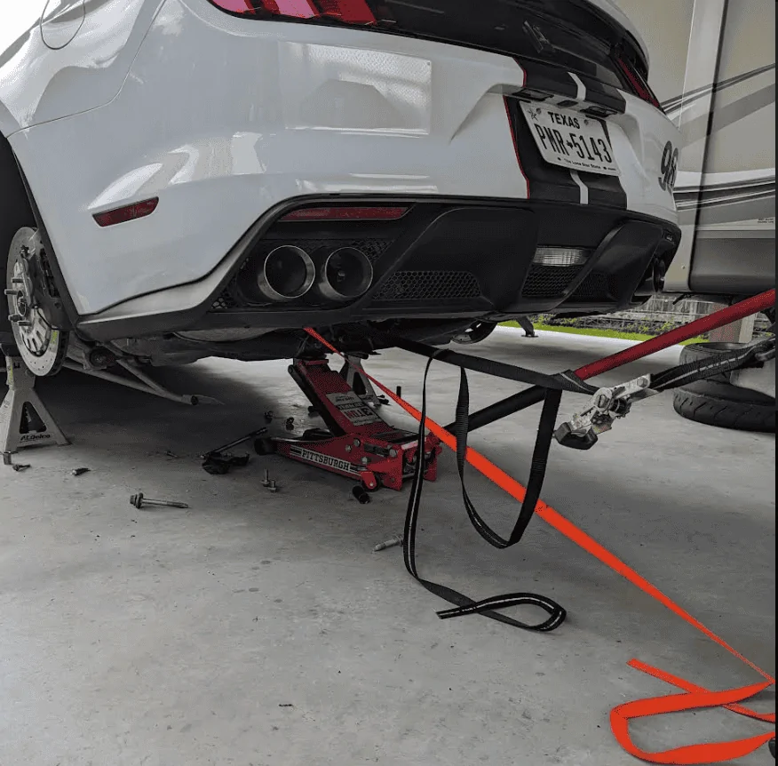

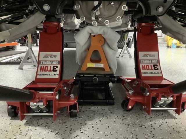

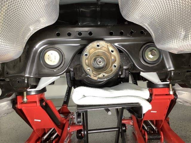

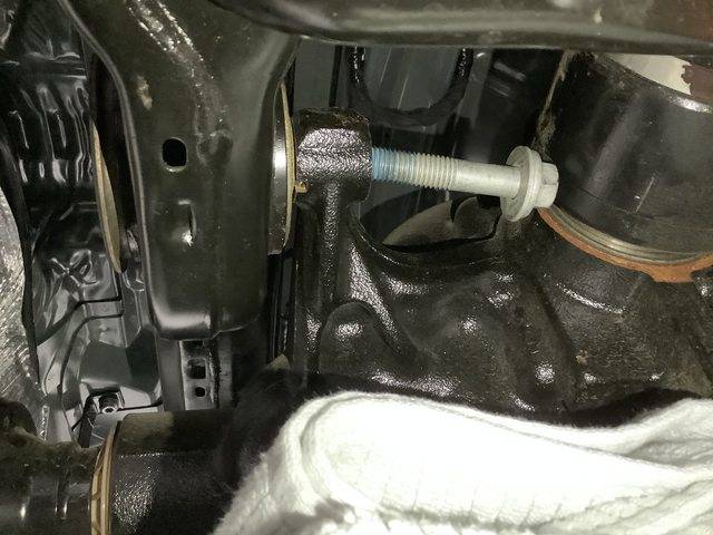

Yeah, it was a bit of a challenge to do working alone. I installed my entire differential bushing kit, along with the differential bracket kit at the same time. I did drop the cradle, in order to work comfortably.
Much more refined than me....
