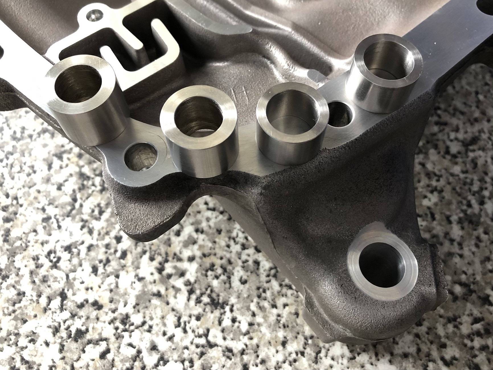

Steeda supply two from plated steel, and two from aluminium :
2 off 15mm thick, 23mm OD & 14.5mm (or M14 clearance) ID
2 off 19mm thick, 23mm OD & 14.5mm (or M14 clearance) ID

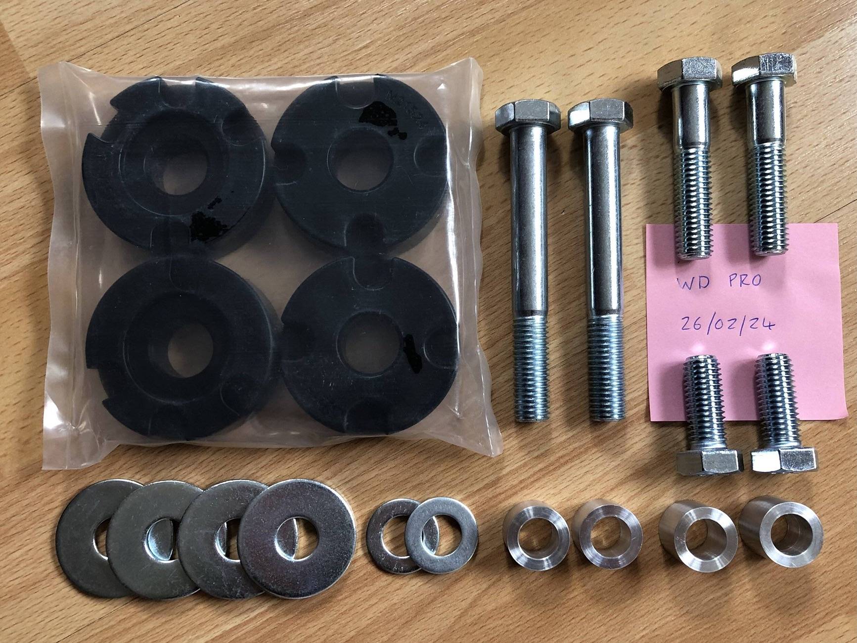

Here they are with the set I sold :
My replacement set (for M16 rears) we’re made from stainless :
