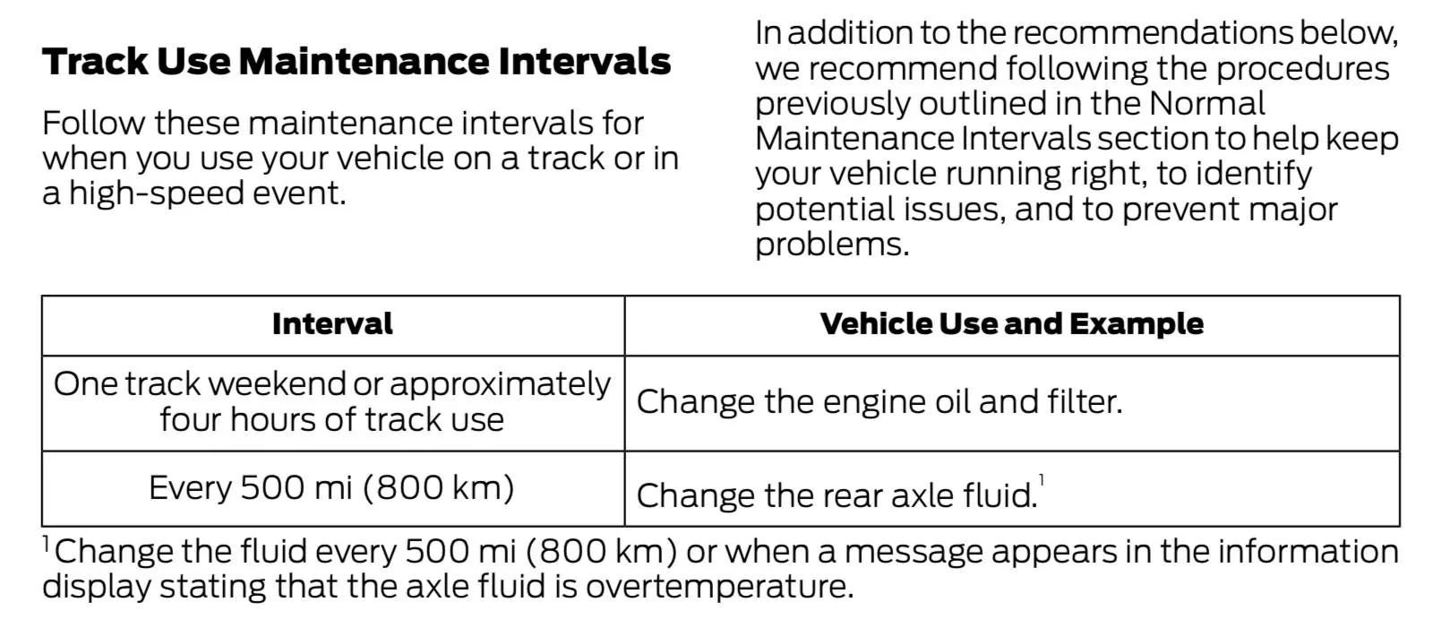

Just over 7000 miles, but the majority of the miles are on track. For instance, I can deplete my engine oil life from 100% in 2 to 3 track days. 1 hour on track equates to 15-25% oil life depending on how hard you are pushing.

I guess you guys have seen this, but to add it to this thread :

Seems I was quite overdue. Fortunately factory oil that was drained wasn't very dirty. Moving forward Im going to change it every other oil change due to the amount of track use.
