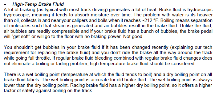

My recommendation is for folks here to search for a reliable source, and the results will most likely contradict the advice offered above.
Why Is Moisture in the Fluid a Problem?

Brake fluid saturated with water will not cause an immediate failure. To be honest, checking for cracks or old brake hoses/rusted lines is way more important than wet BF. Wet BF will have a lower boiling point, ie your brakes get softer quicker after repetitive use. So there will be signs.

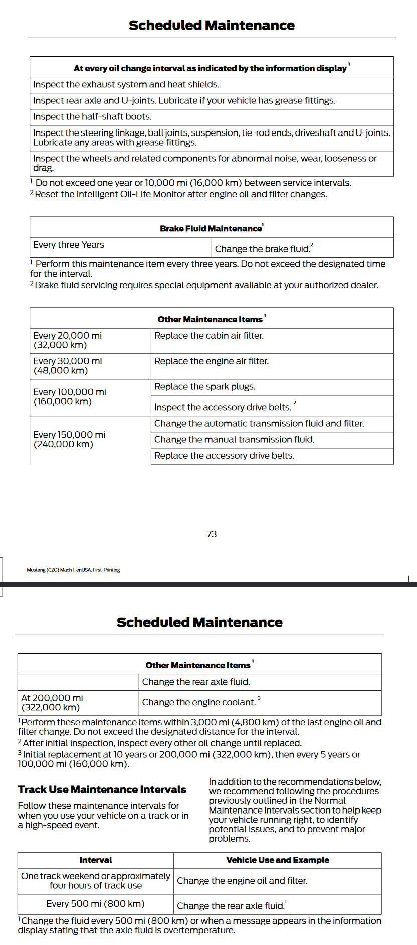

Attached the maintenance interval, ford lists every 3 years:
