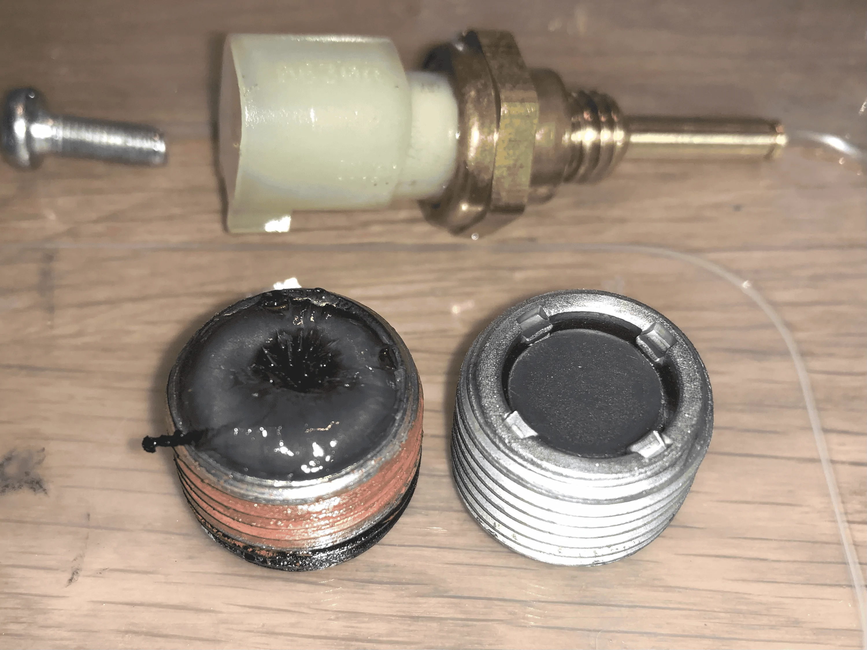

How many metal did you find when you changed your fluid? How many miles did you put on the oil before changing it?
If I'm not wrong it's supposed to be "filled for life" (not that I believe that), I will change mine for sure as well the ATF in the gearbox at some point, just didn't yet decided where the point is.
Approx 2.5k miles :
I cleaned up my plugs and there was actually a lot more crap on them than I expected as the magnet is recessed, this is 2.5k of reasonably enthusiastic road miles :

I changed mine at 3,300 miles. Biggest reason, is the owner's manual warnings about if using the car at the track, then the frequency for oil and gear oil changes drops to stupid low intervals, like every couple of track days....
My magnetic drain plug at 3,300 miles had less build up than the one pictured above, but similar in sort of milky gray color, no metal bits, just very fine film.
If you're not taking the car to the track, I suppose you could go for a very long time.
Having said that, I would highly recommend that you or your mechanic open the drain plug and check the level. I figure mine was between 1 and 1.5 pints low. Really pretty sad from the factory on a 2022 brand new car ???
I think the build up on mine (which you won't get if your referring to your mach = torsen) is the clutch material :like:
