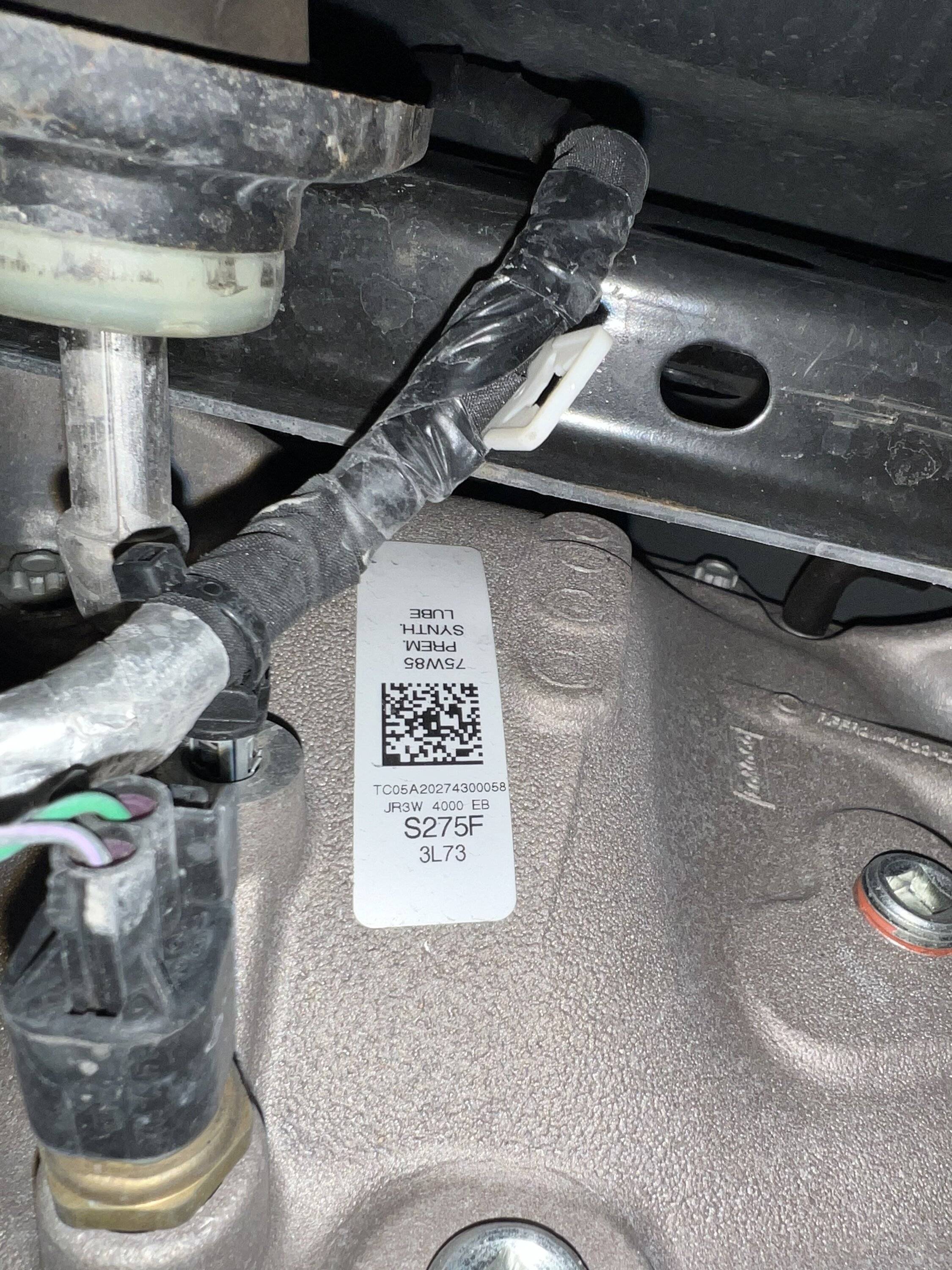

Is this service the same for all 2015 to 2023 mustang
If its not a 350 or Mach I believe there would me a threaded plug where this line is. Does the 5.0 have the Torsen diff? Can somebody confirm?

If its not a 350 or Mach I believe there would me a threaded plug where this line is. Does the 5.0 have the Torsten diff? Can somebody confirm?
Here is a picture of my diff cover from my 20 PP1 you can see the fill plug and drain plug at the bottom of the picture.

forgot to mention the performance pack with the manual transmission has the Torsten diff
So does the auto PP1's, and it's TORSEN, short for TORque SENsing.
