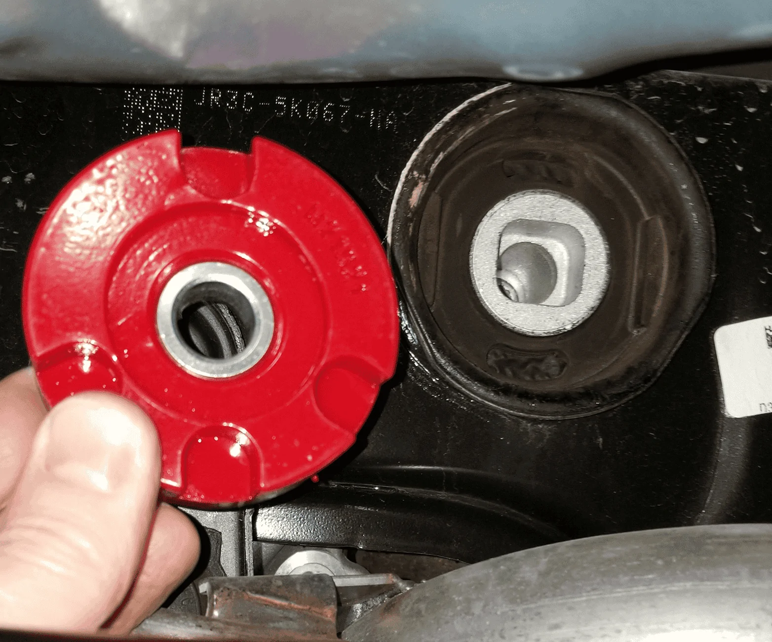

This is good info. This damper will not fit into the bushing on a car not previously equipped with one. There is a protrusion on the back of the damper that fits into this square hole so it can't rotate. The bolt is also longer to accommodate the thickness of the damper.

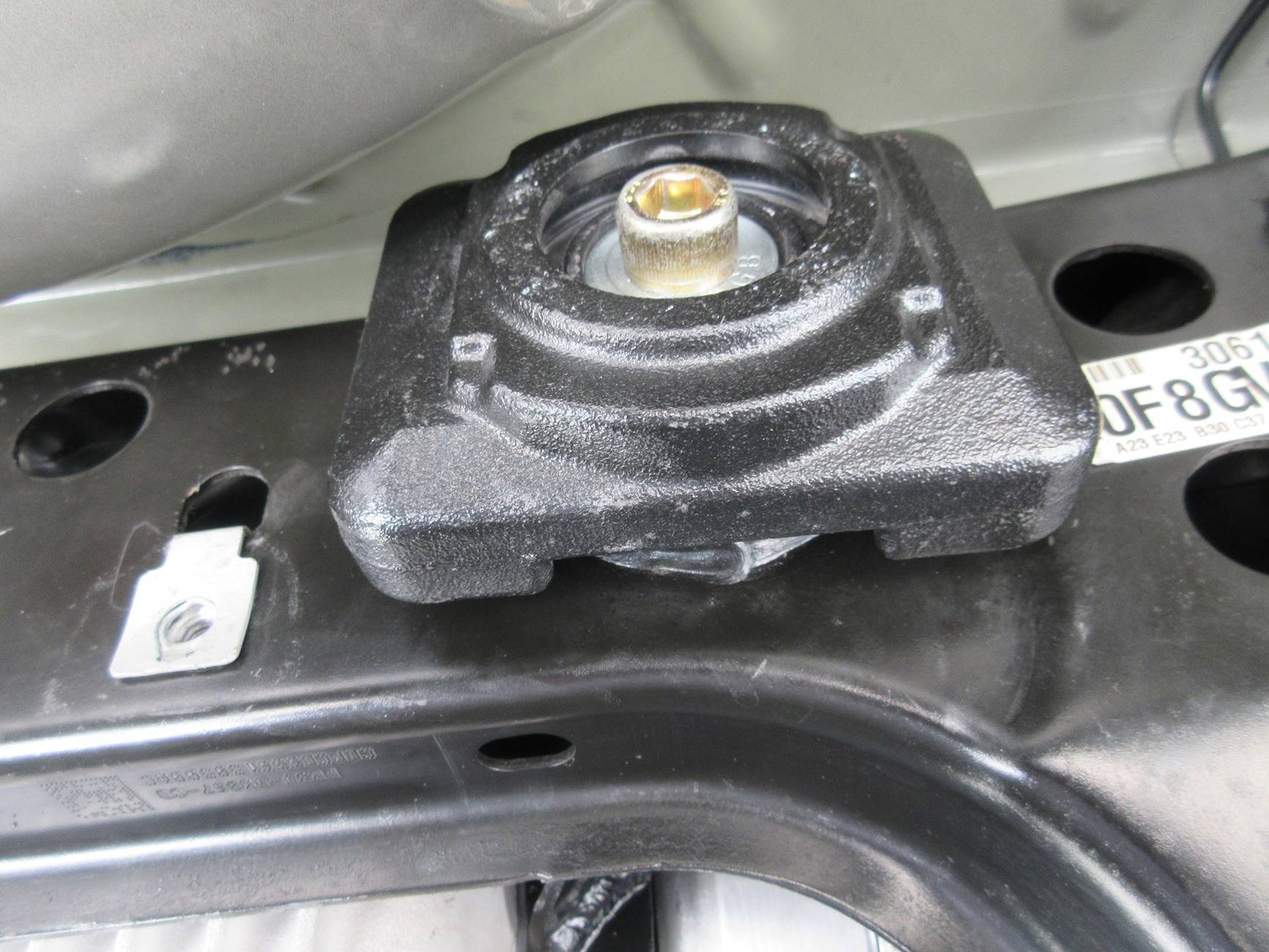

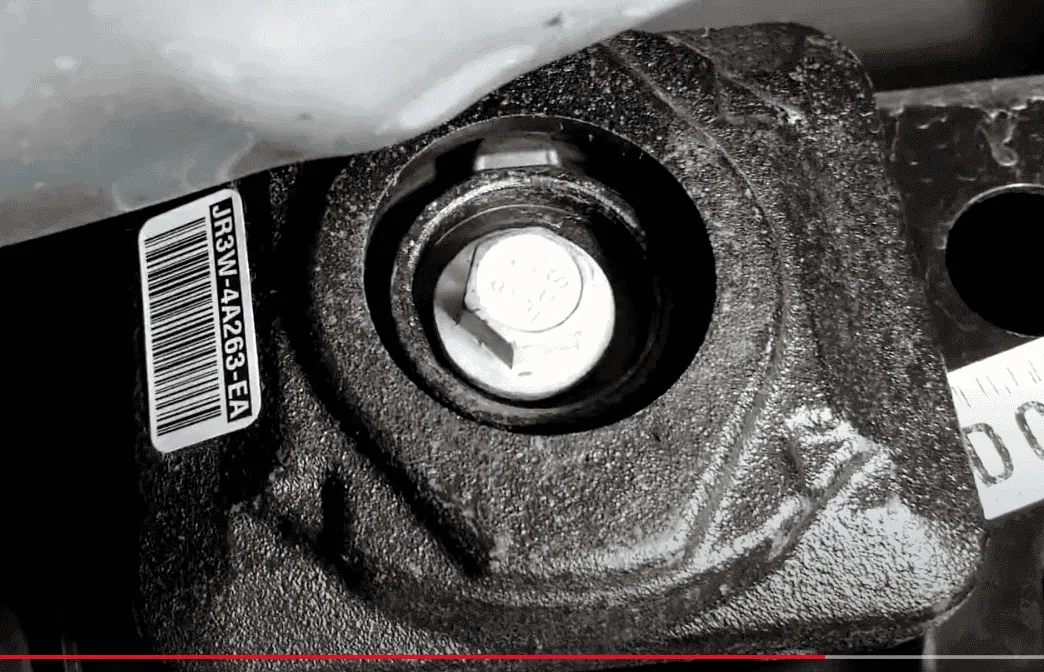

In May 2019 I did a lot of experimenting with these Dampers on my 2016 GT350.
I actually bought (2) FR3Z-4A263-A Dampers.
A Longer Bolt was needed, and I had to grind-off the protruding square nubs on the dampers to get a correct fit.
I believe at that time I had a 4.88 Ring and Pinion Vibration.
I first tried one on the Right-Side (Passenger side), as I had seen some OEM ones placed there.
I observed no apparent changes with the one, so I then put a damper on both sides.
I ran these on my car for about 1,000 miles, along with my Home-Made Rear Diff Cover (I also changed the Bolt orientation), with No noticeable difference observed.
I did get some info from a FORD engineer stating that these were placed on certain models for (Harmonic vibration conditions)
See this link for more details (Pictures/Weights, etc.):
https://www.mustang6g.com/forums/threads/vibration-between-50-70-mph.15990/post-2545655
