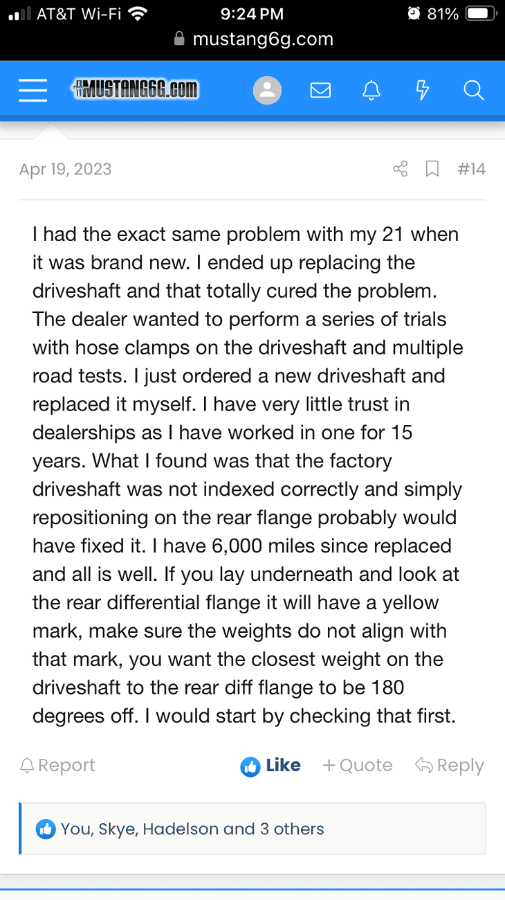

Here’s a screen shot of a M6G member’s observation and corrective action with the OEM DS that vibrated.
I agree common logic suggests a balanced DS shouldn’t need to be re-clocked but that isn’t the case.
6 bolt yoke flange, the position you’re in now vibrates so 5 more locations to test.
Your car your choice, that IRS Diff moves all over the place, this isn’t a 4-Link or leaf spring situation hence it has a CV joint but there’s no going back on that with your CF DS.
