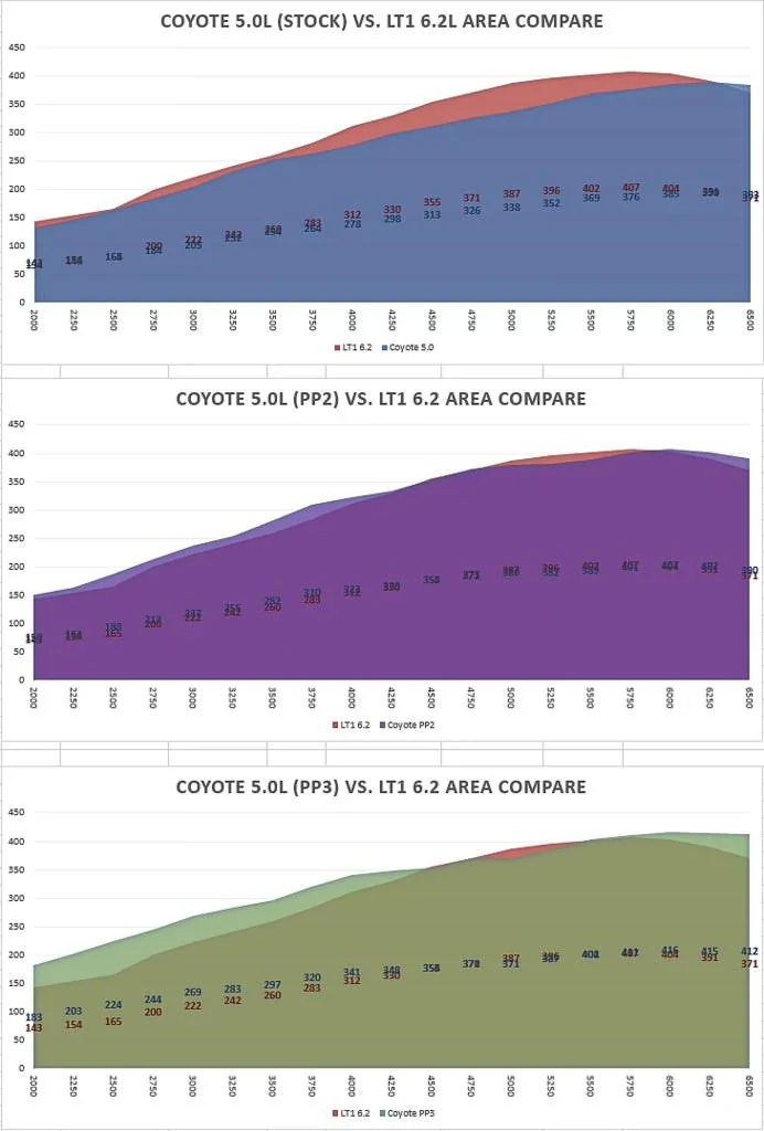

I think the reality is the two chassis architectures are nearly identical in weight. It all comes down to tires, driver, power and suspension tuning. Ford simply does not set up the regular GT's or GT PP's like the 1LE. Not even close. The regular GT is set up like a Fusion Sedan, it's pure grand touring with a reasonably powerful engine.
The Performance Package GT's are set up like a standard 1/2SS, but the older 2015-2017's have an average power deficit of about 23~30 hp if you do an area compare of their power bands (to the wheels) and are a little heavier to boot (about 60~70 lbs if you get a Performance Package only and not a Premium, the clock in around 3780 lbs).
That's what people want, a Grand Touring car and that's why Ford sells them set up like the GT's name sake and not the Super Sport track car, but the GT has the same potential if you want to blend the two and you can do it under warranty.
Ford makes the sales numbers on run of the mill slush box GT's, for those wanting a street performance car, they have Performance Package. For those wanting more of an actual track car, they have Ford Performance factory upgrades which are covered by warranty when installed by a dealership.
I did the Power Pack 2 in my GT and it really brought the 5.0 to life.
2018+'s make a little more average power than the LT1 6.2 or a Power Pack 2 2015-2017, maybe slightly less than a Power Pack 3 2015-2017 5.0. The 2015-2017's with a Power Pack 2 make nearly identical power (just a hair more, 5~7 hp on average) to the LT1 6.2 just shifted 500 rpm higher. With the SS you get as much as they can give you out of the box. With the GT, you get about 90~95% out of the box. If you care about that last couple percent, pay for the factory upgrades. GM also offers factory upgrades for the SS as well, just not as many.
If you don't option the crap out of a GT, weights are within 50 lbs. So it comes down to driver, suspension tuning and tires. That's what the after market is for. Sky is the limit!
The fastest track cars, SS or GT alike are not bone stock factory cars. The fastest of each are going to be highly modified from their factory setups, but you can generally get the GT's cheaper because there are quite a few more of them, but you also have to do more to them because they are just not set up like the SS from the factory.
Ford did build in a very substantial potential however. The most critical areas of design are there as a foundation, it's just buried in soft rubber bushings and very anemic engine tuning.
So do you want a car that's great out of the box and just drive it as is or do you want to make it your own creation and tailor it to your particular applications? Drag, Auto X and HDPE all have very different requirements and the fastest cars in each category are set up very differently of any factory configuration in either a GT or SS.
Hi,
I don't think your graphs are true.
PP3 power pack decrease significantly the torque under 5000 rpm, and max torque is lower than PP2
There is no way PP3 has more power below 4500-5000 rpm even than a stock LT1. Your graph shows PP3 which more power even at 2000 rpm which is a real joke....
I have a 2018 GT stock (which is like between PP2 and PP3 level of performance for a gen 2 coyote) and a C7 GrandSport (both manual) and even when the vette was stock it was murdering the GT below 4500 rpm, the Coyote has nowhere near as much torque... and Gen 3 Coyote is known to have way more torque down low than the Gen2...
Edit : by the way, VIR ZL1 time is 2min50.1, 2min45.7 is ZL1 1LE

He is comparing HP not Torque but he does know that it is Torque actually accelerates the car through straights and turns, I hope!

He's shifted the RPM band on the coyote to show an apples to apples comparison of the two powerbands. Notice how both dynos in all scenarios terminate at the same RPM.

HP and torque are proportionally related. It’s easy to understand if you have more torque down low you have more power.

This doesn’t make any sense, he should have put the real power band. Stock gen 2 coyote doesn’t rev a lot higher than the LT1 (6600 vs 6800) so first one is right.
Then he should have continued the scale with the real rpm limit of each power pack. His graph like is it is misleading, making you guys believe Coyote PP3 has significantly more torque than a LT1 which is BS.
Then you can talk about average HP on the common rpm range used when shifting on both cars. (4800-6600 LT1 and 4500-7500 for a manual Gen3 Coyote)

When talking about area under the curve, it makes perfect sense. He's showing the usable powerband of both vehicles overlaid on top of each-other. Where the LT1 will be at 2000RPM, the coyote will at slightly shifted. It's area under the curve that highlights how a vehicle is going to accelerate, hence the reason for these overlays.

What? No, you can't do that.
I'm not sure if he shifted the powerbands however, if he did, he can't. If we're discussing purely the engines, you don't shift the powerband otherwise it's lying. HP is dependant on RPM and torque, if you're shifting your torque curve, you're changing your HP. I.e. 250 ft-lbs of torque at 7500 RPM is 357 HP. 250 ft-lbs at 6500 RPM (shifted) is 309 HP.
If you want to overlay how each engine performs on the road, you need to take into account gearing and tire size reduction. Then you can overlay the actual road speeds vs effective net torque, and it will show "at 30 MPH, the Coyote will be at 4500 RPM and the LT1 will be at 3700 RPM, here's how their torque bands look different".

Area under the curve is the only thing that matters here which doesn't change when you shift the curves. Remember, horsepower is key with acceleration, not torque...as it's giving you the time variable.
Repeat after me, AREA UNDER THE CURVE. Shifting the curves allows you to easily see which engine has more area, plain and simple.
As for gearing, that's an entirely different conversation.
