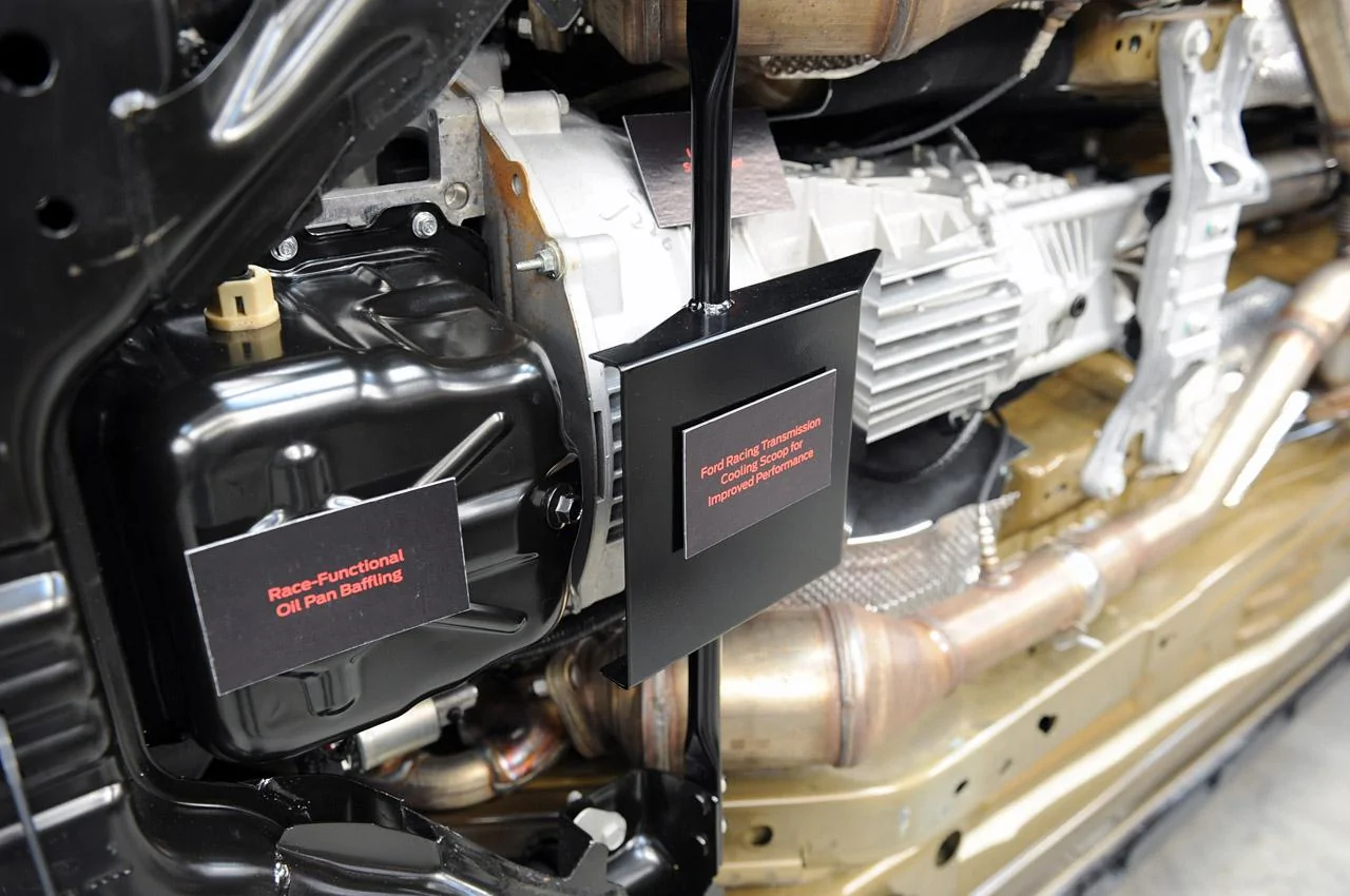

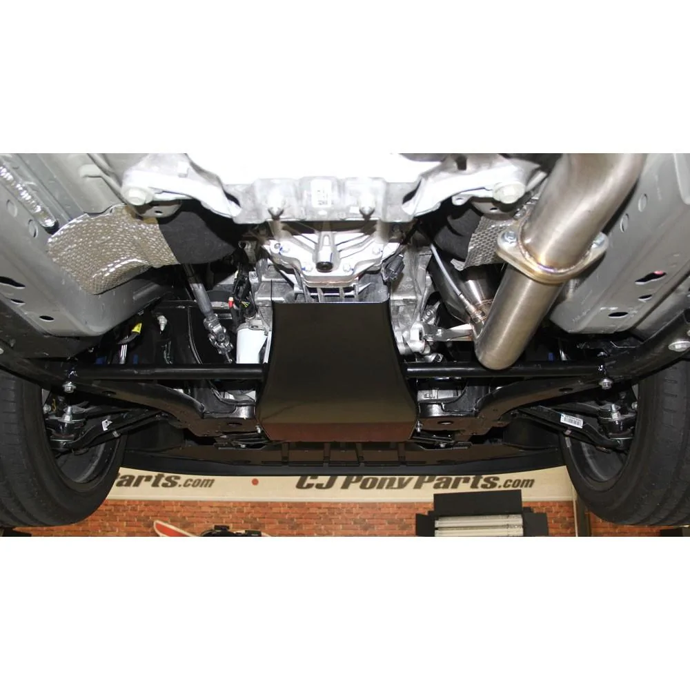

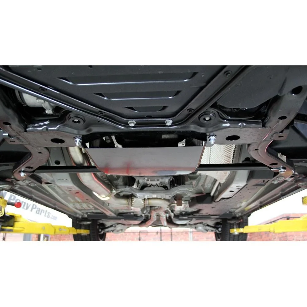

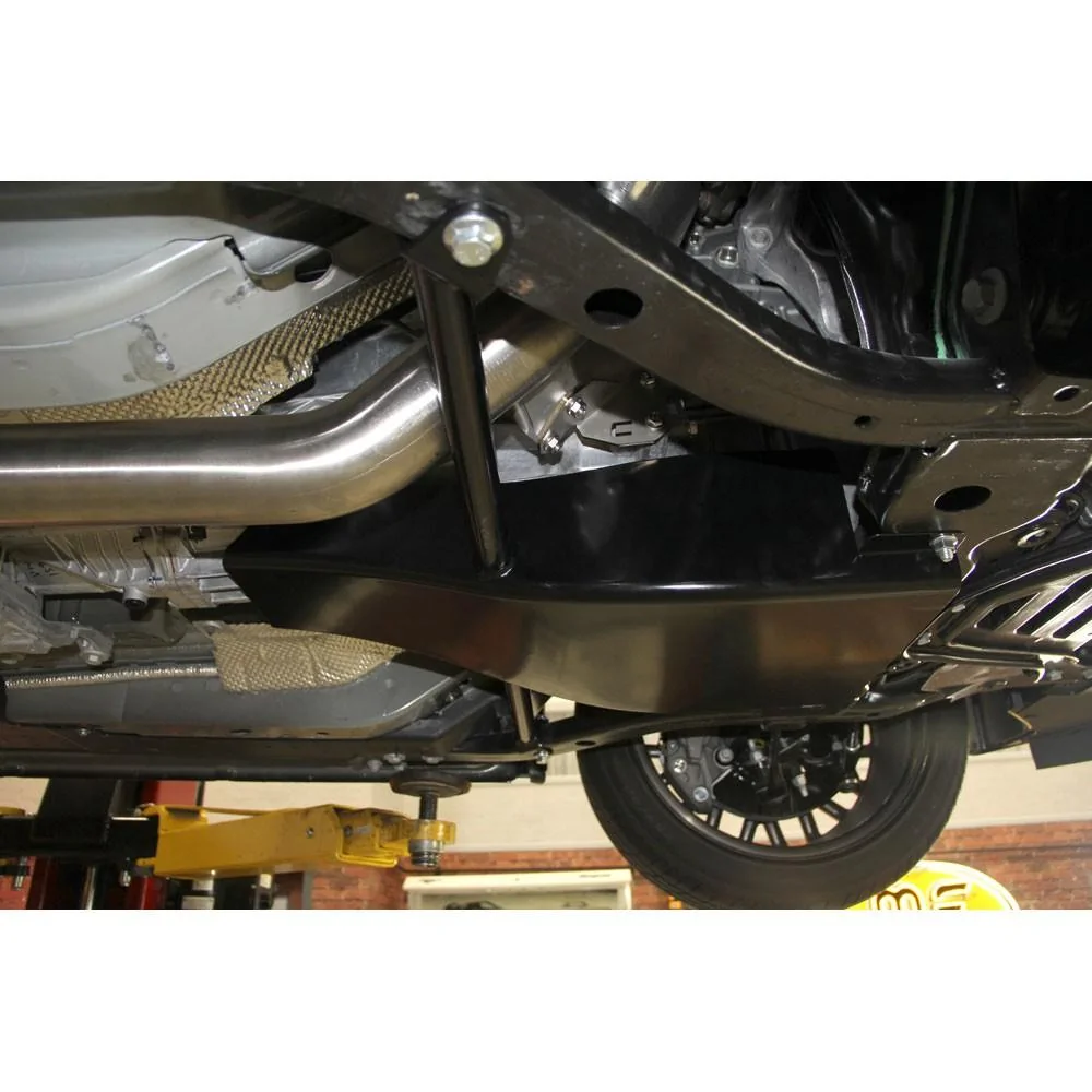

I fully understand, I should have clarified that it would take some modification. My point was, these cars don't need full blow coolers on the transmission, just a bit of air redirected at the cooling fins. Maximum Motorsports offers a similar bolt on though for the S550 (See below).
The work well enough to allow the Boss 302 laguna seca hot lap in the summer. From what I recall, Ford claims 20 degree temp drops...enough to keep the MT82 out of the danger zone. The Boss 302S however has a TR6060 with no cooling fins, so it's not going to as well. As for why they aren't popular here, very few complain currently of overheating transmissions...and fitting that particular scoop would take some modification. They were however very popular with the S197.

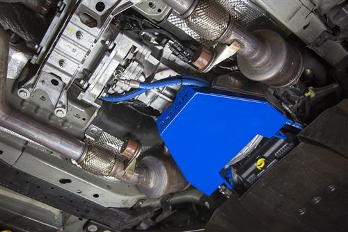

Maximum Motorsports however makes a direct bolt on for the S550...
https://www.americanmuscle.com/frpp-trans-cooler-scoop-1516.html
MT82 with scoop on the Boss302
You’re not “picking up what I am putting down.”
Also just pulling internet information from where ever.
