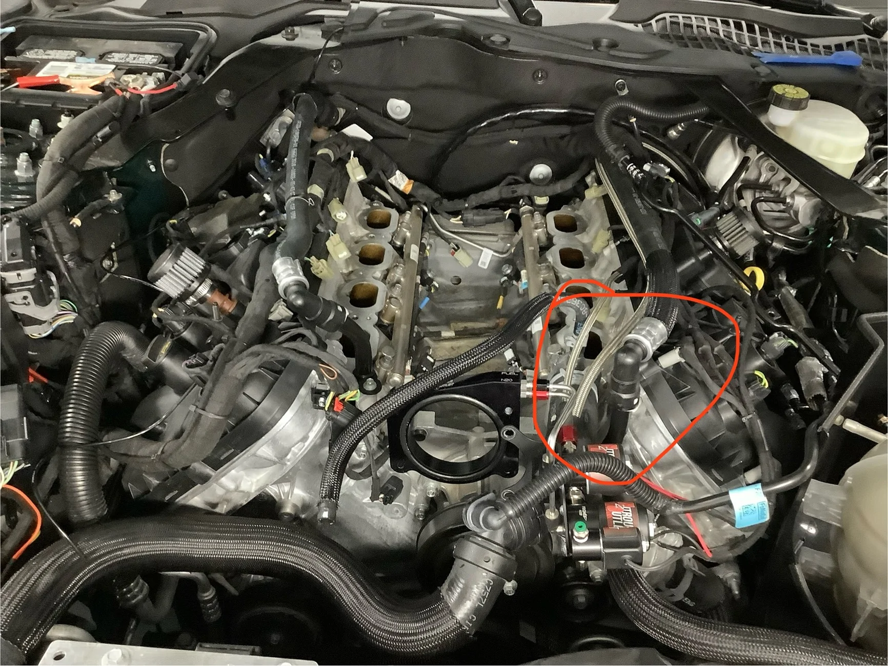

I will make sure to ask the shop that's doing it all what issues they encountered, but so far the only complaint I've got was that the crossover line is being blocked by the coolant pipe so it doesn't fit in. Gonna call DW today and try to see what's up with that.
Send a pic of the coolant pipe if possible. I might be able to suggest something for you.
Thank you, will do for sure, the shop is trying to figure it out now too, hope they get it done. DW just told us over the phone that "it should fit without problems"...

Is this the pipe that’s causing you trouble?
Here’s one

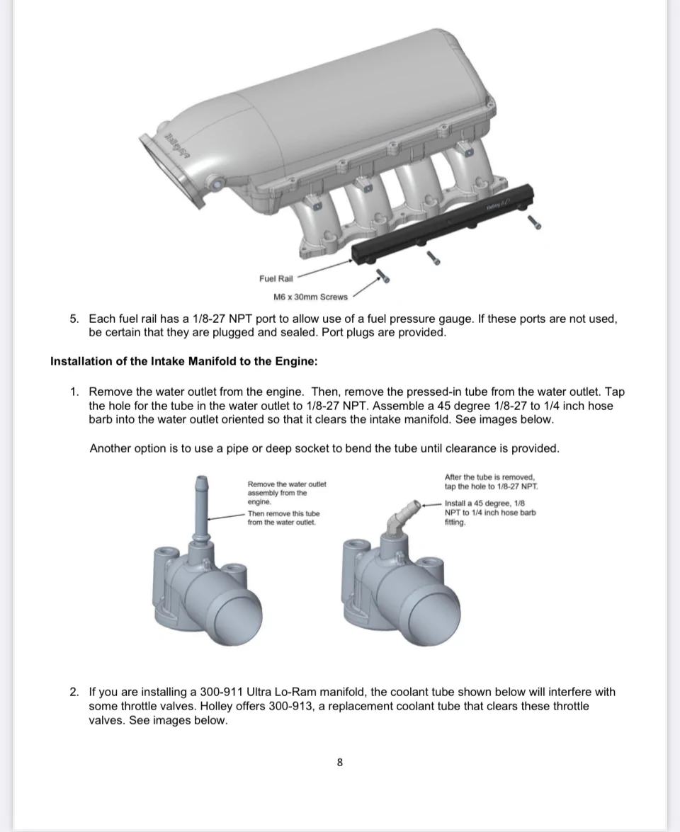

I was messing around trying to see how to go about installing mine in the Holly rails and here’s what I came up with.
It should be the same for the DW rails. I figure, why not try and use it.
