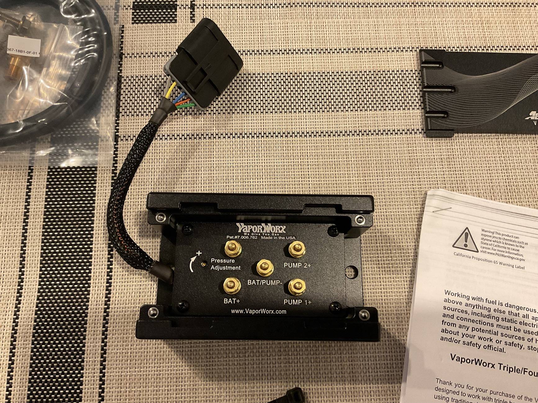

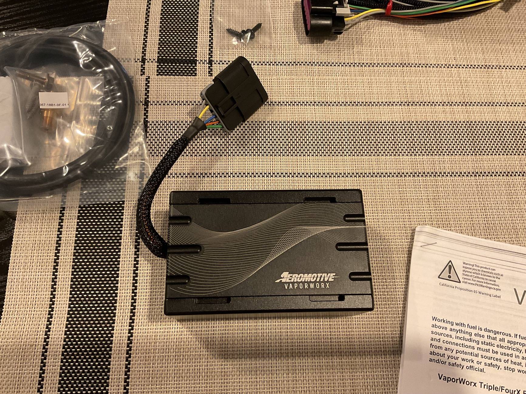

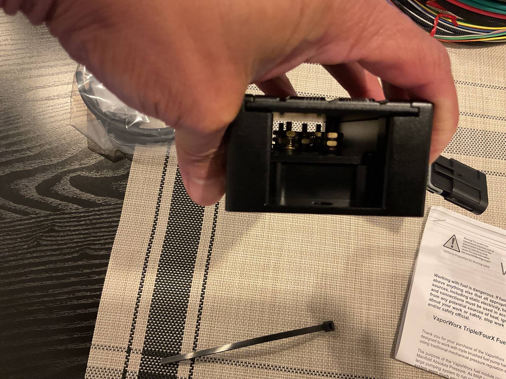

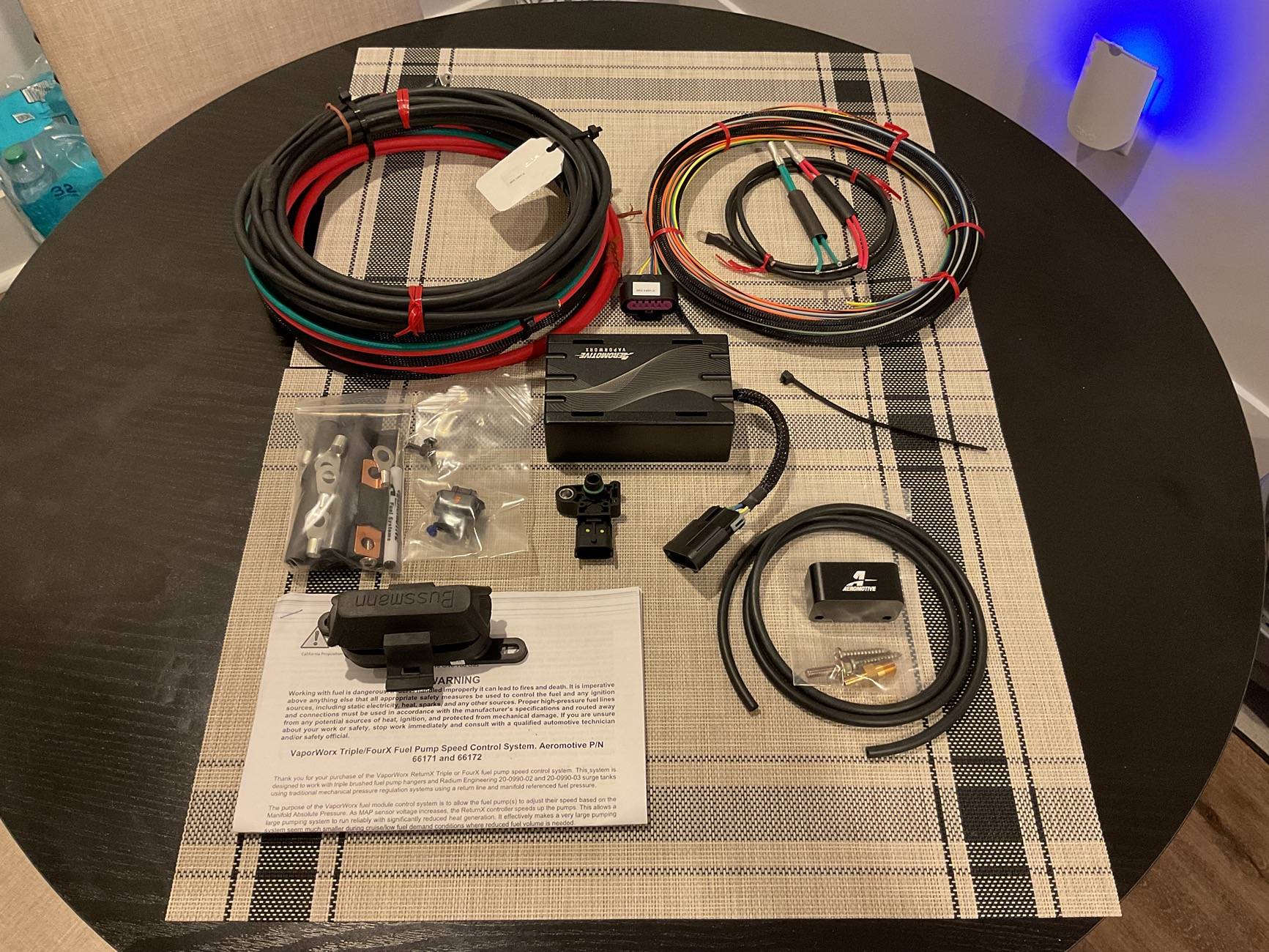

Update: I received the last of my fuel system components from VaporWorx/Aeromotive yesterday. I purchased their FourX PWM controller to handle all three of my DW400 pumps .
There have been some product updates made to the system, in that the controller now has a cover over the terminals and the Smart Relay Controller is no longer needed with the newer design.

Is it compatible with the whole DW X3 setup? What made you go this route?
It is compatible with any brushed fuel pump system. I went this route because I never liked the idea of running naked fuel pumps (not in an anti-slosh bucket) or using a Hobbs switch to run additional pumps, all of which would require the pumps to be running at full speed all of the time. I know many don’t agree with it and that’s okay.

how would it all be connected to the bucket? do they provide any installation instructions by any chance? Cause I'd rather be on the safe side and not run 3 naked pumps as well, being in SoCal and all, don't need all that extra heat. Especially since DW very strongly suggest to get shitload of wiring from them anyway...
Disregard the mention of the Smart Relay Controller, as it’s no longer used with their newest version of the system. They say there’s probably 30’ of wiring in the FourX kit, so that’s plenty to do whatever you need.
https://www.vaporworx.com/wp-content/uploads/2023/01/PWRX-FourX-Instructions.pdf

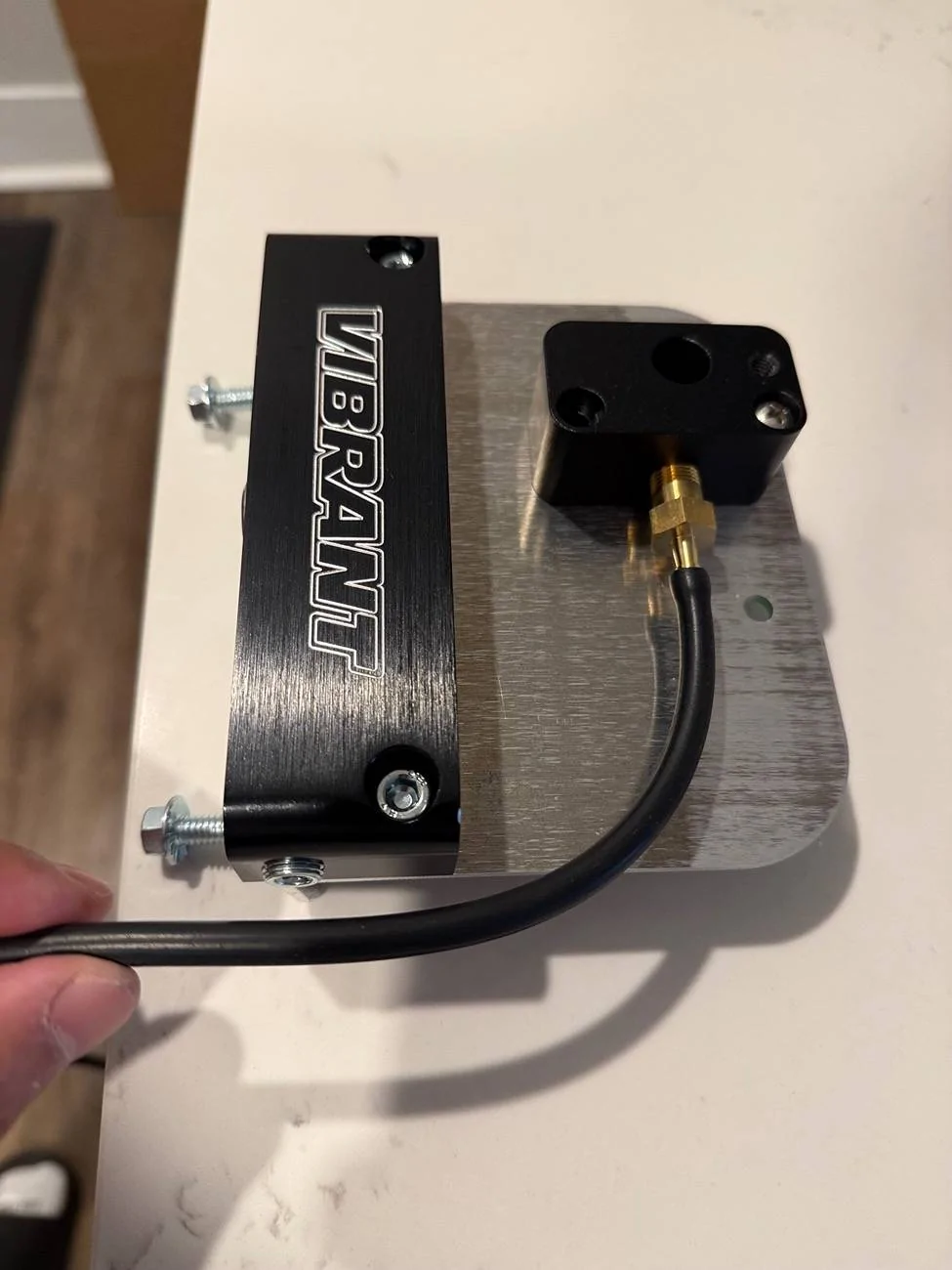

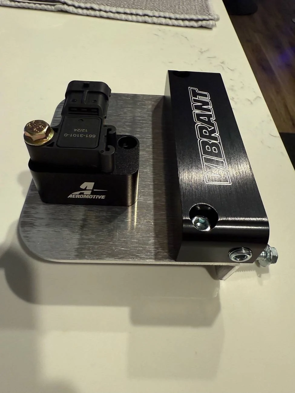

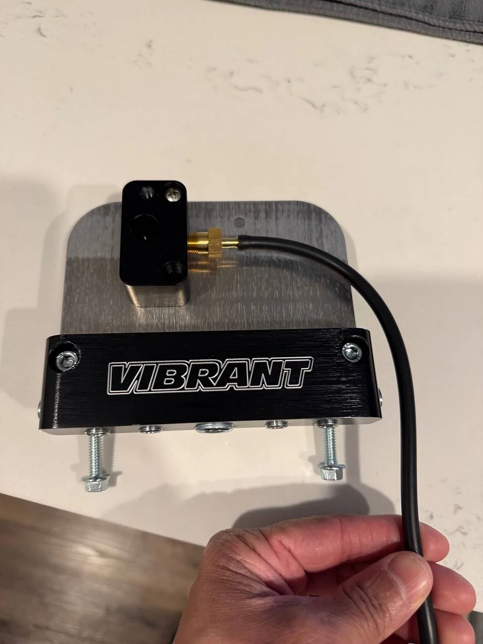

I was doing a mockup today to see how/where I might mount some of the components.

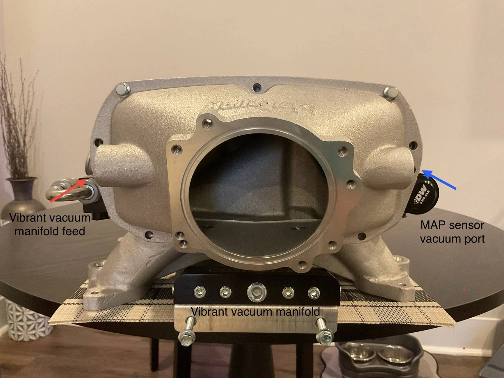

Here’s what I may end up doing to mount my vacuum block which will feed the eBoost2, wastegates, BOV, and fuel pressure regulator, as well as the VaporWorx MAP sensor. I want it to have its own dedicated vacuum port.
Of course things are always subject to change, but for now, I’m thinking along these lines.

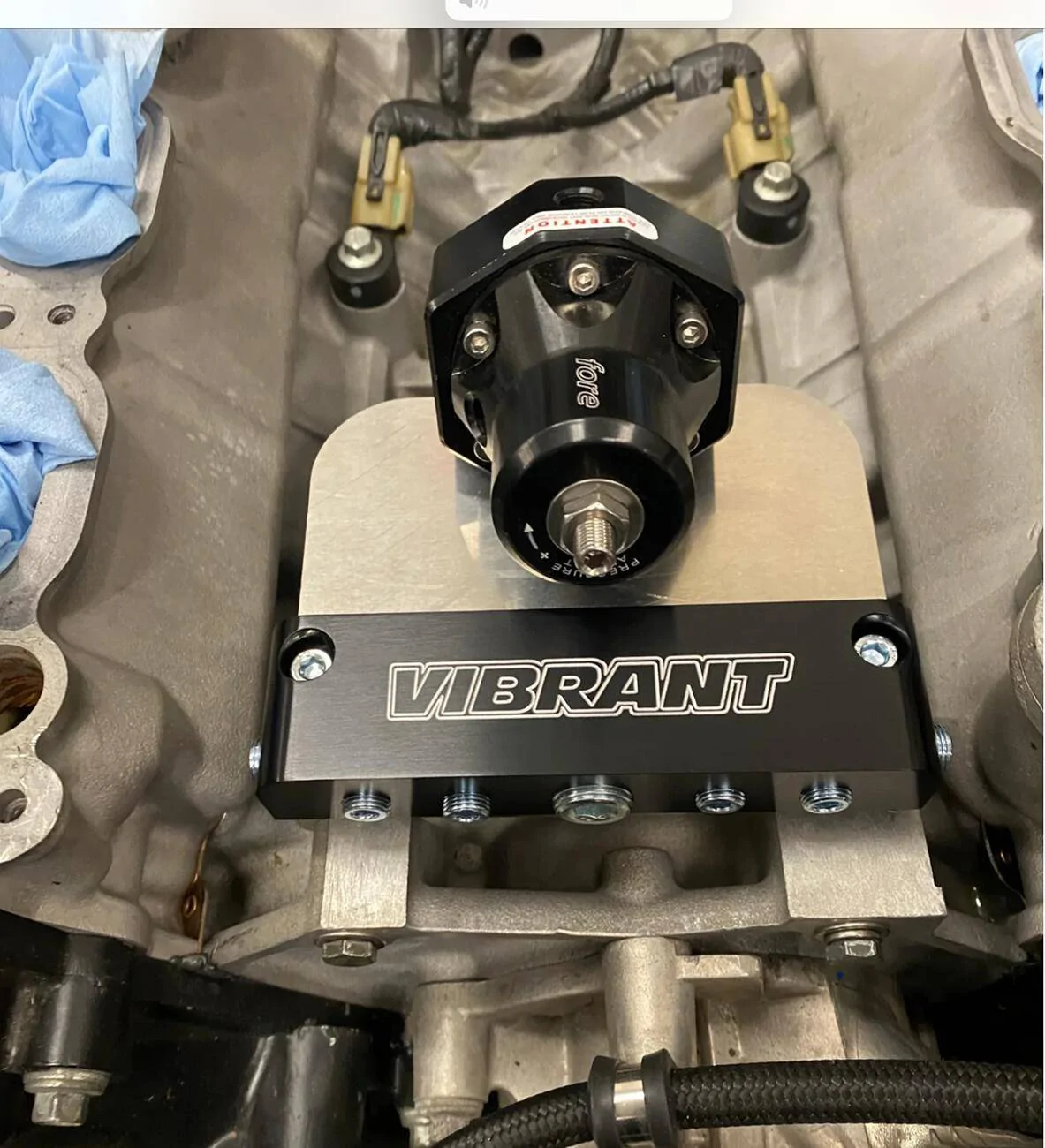

Adrian
2019 Bullitt
The Mike Thomas vacuum manifold mount will be mounted underneath the Lo Ram intake manifold. It has a provision to mount a regulator as shown in the photo from his website, but I won’t utilize that feature. Instead, I’ll repurpose one of the mounting holes to mount the VaporWorx MAP sensor block.
