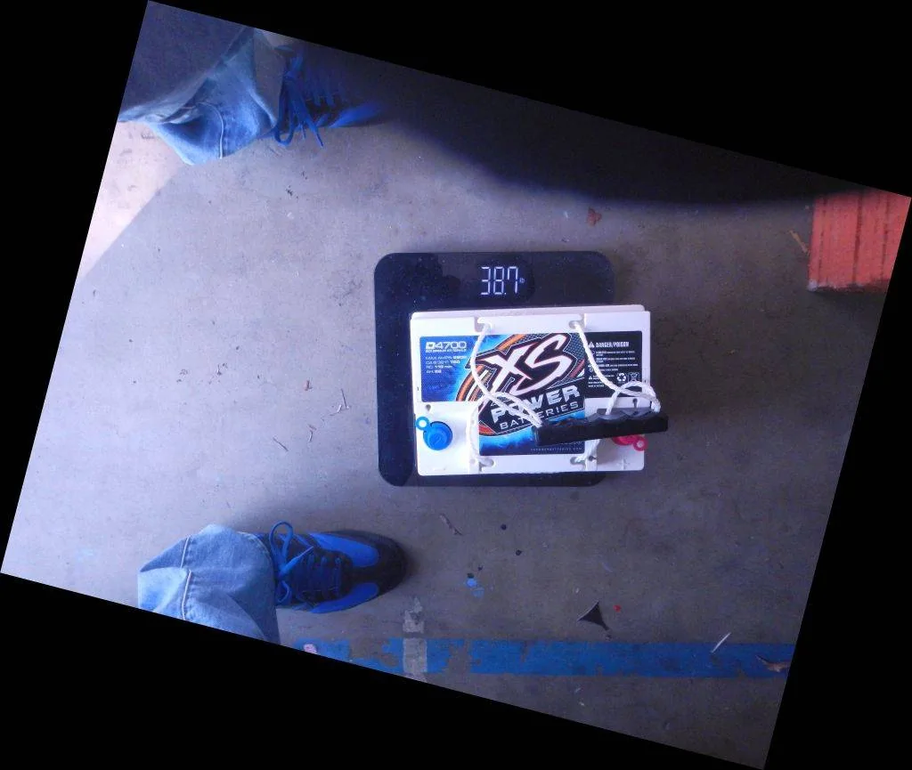

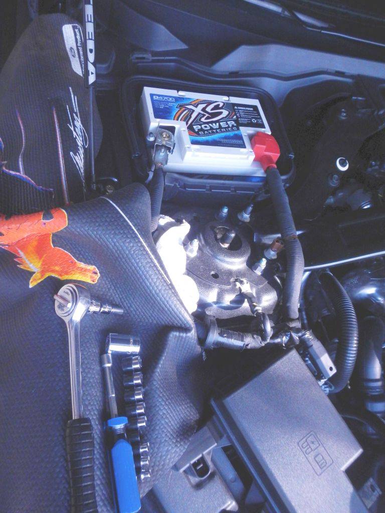

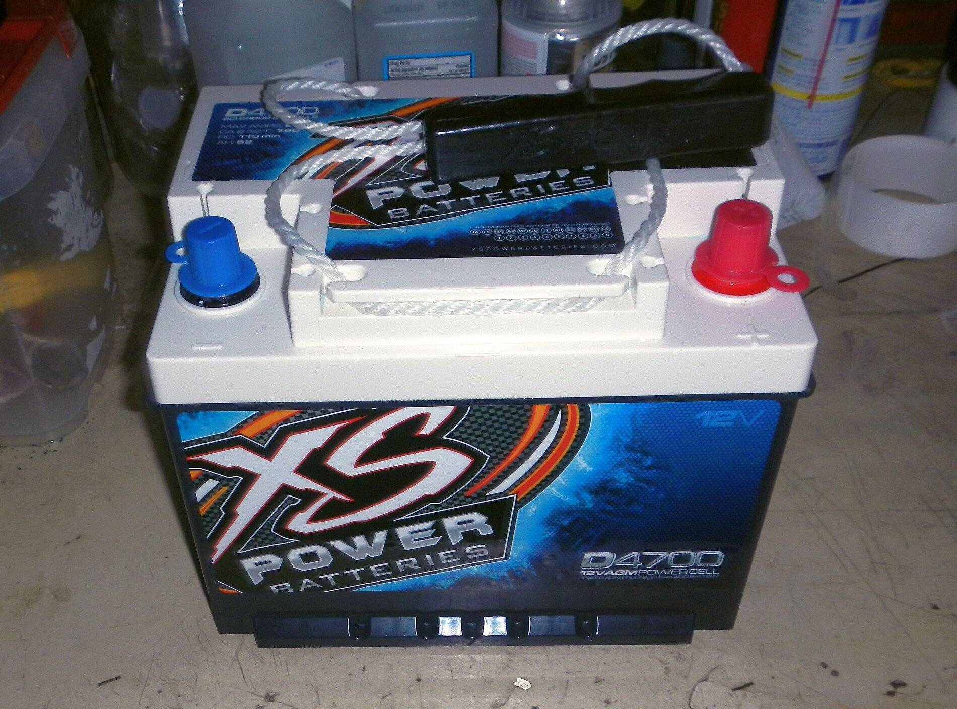

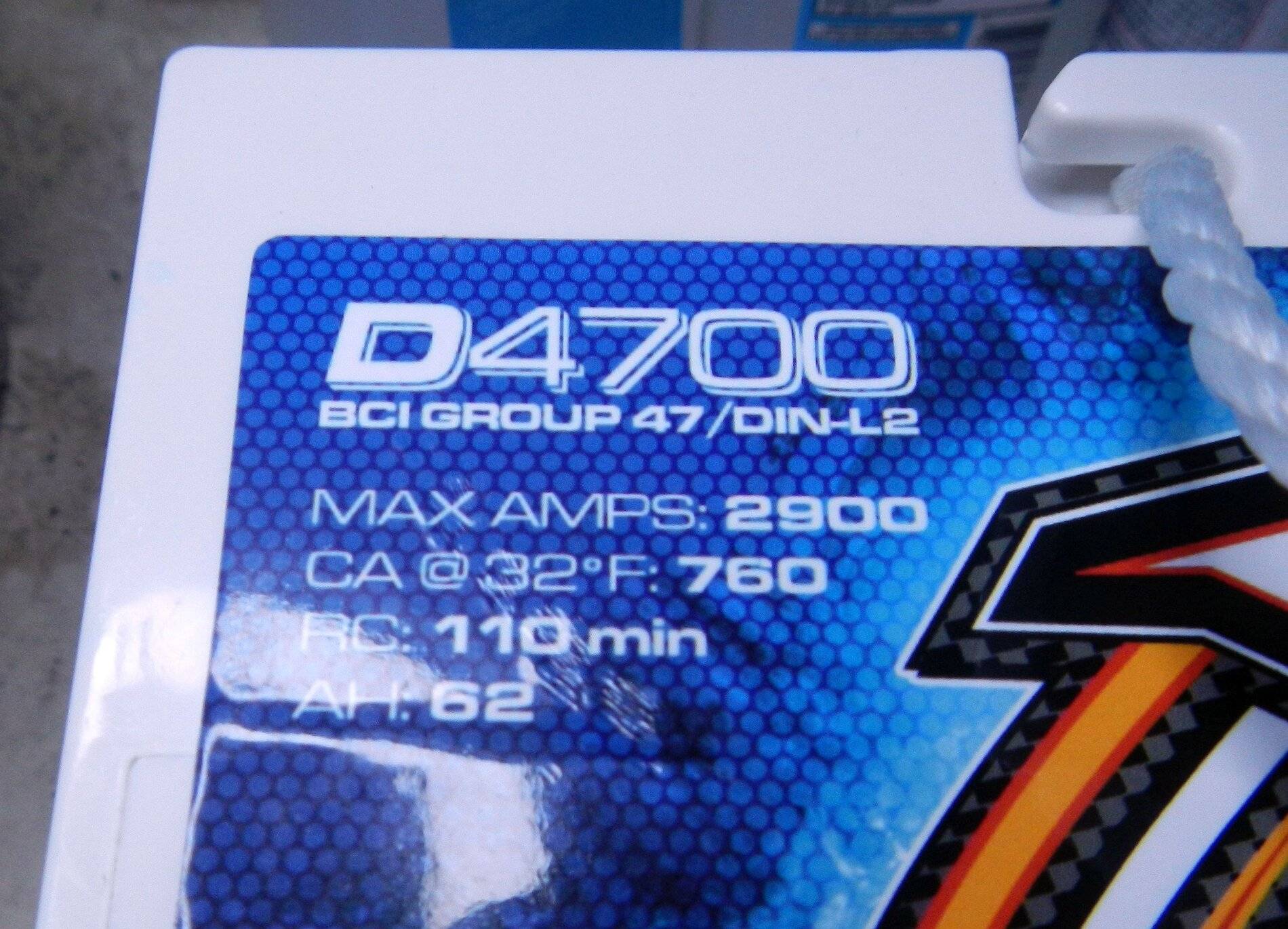

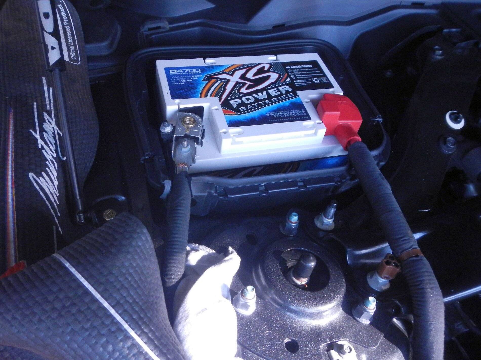

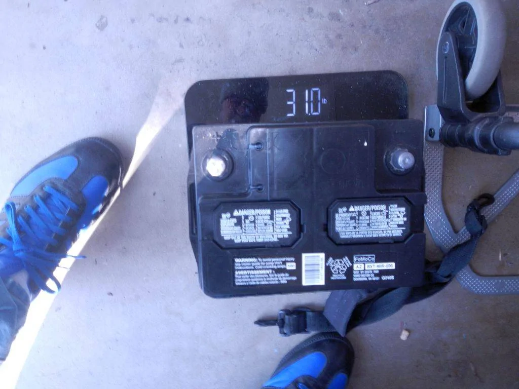

While we're on the subject of more substantial output and reserves, and batteries that are, like, three-eighths of an inch taller than original equipment see my images that might make it more vivid.
