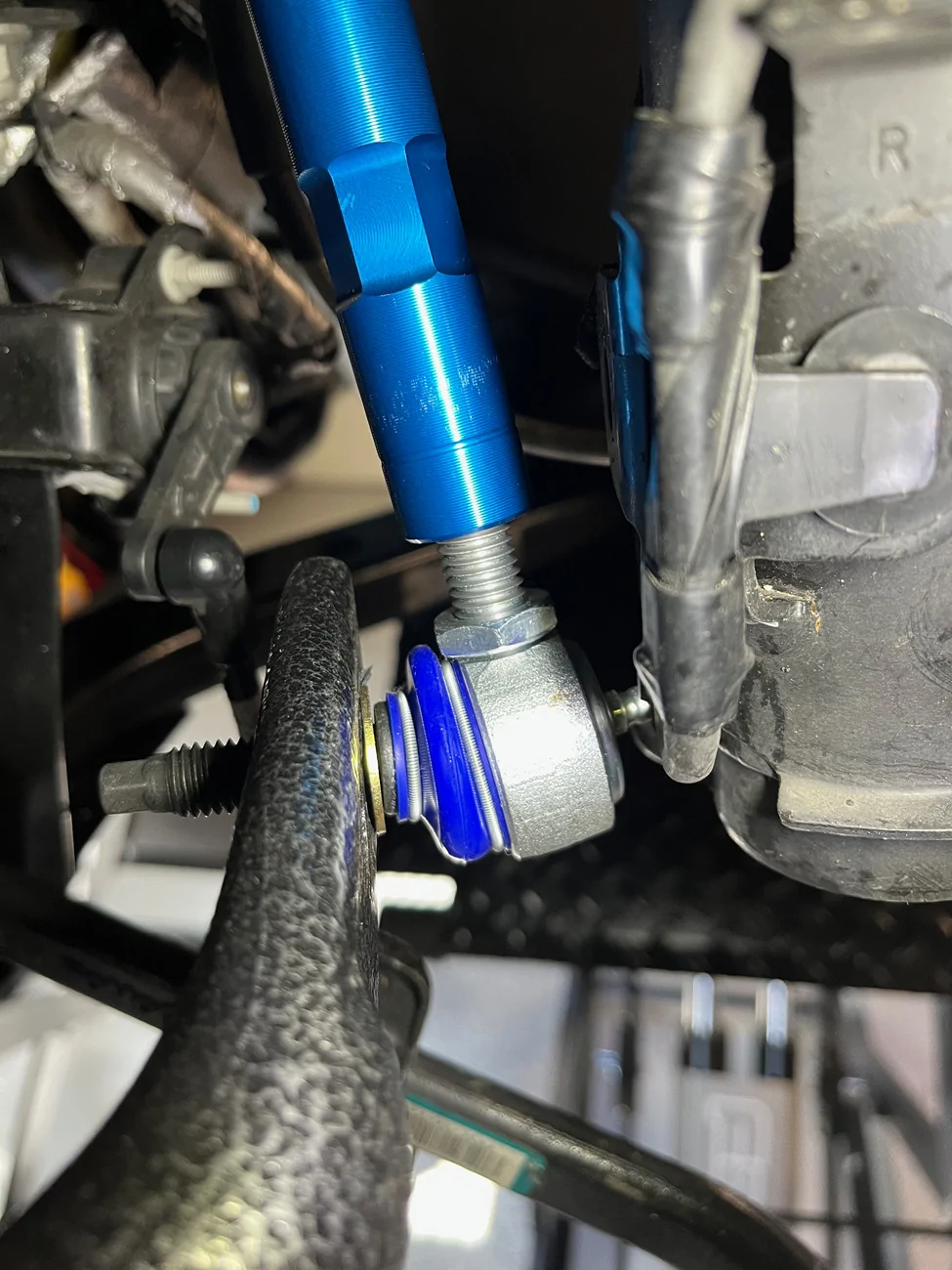

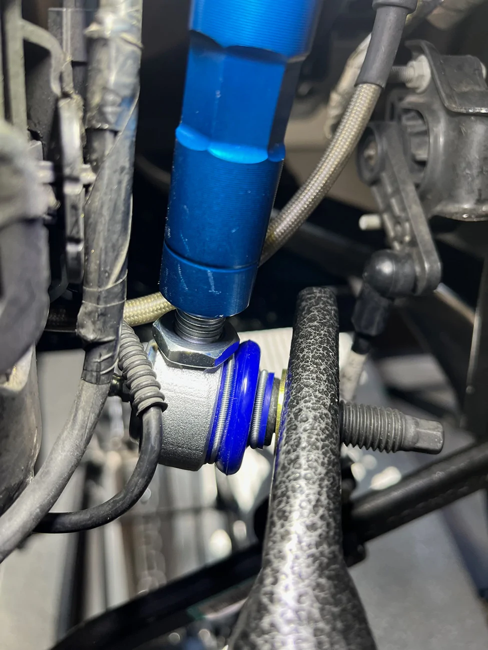

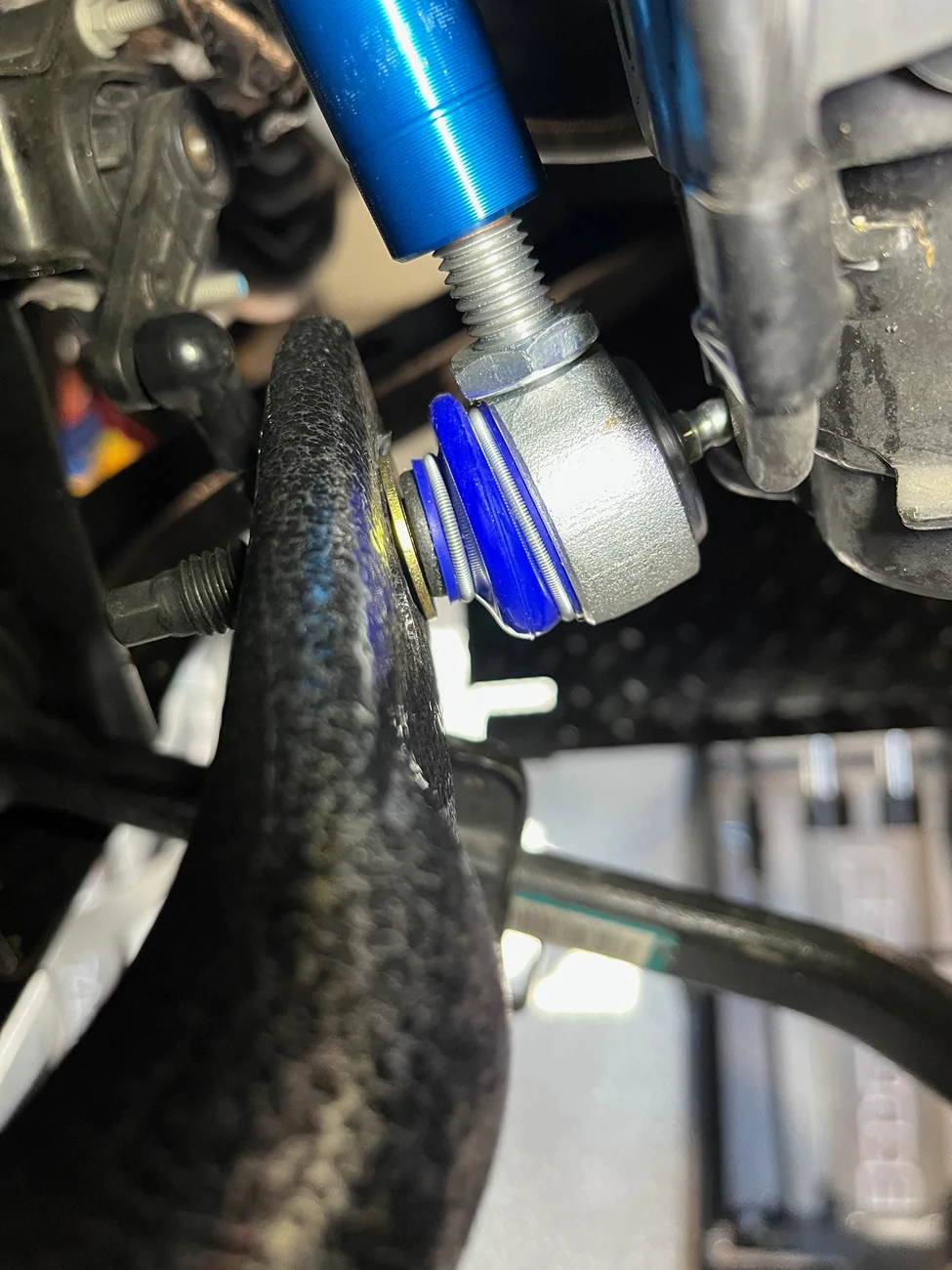

I tried the Steeda end-links, because they had dust boots and looked nice, but they interfered with the spindle. I have magnaride which I think is perhaps a bit bigger than non-Magnaride and the Steeda ends are large. Also, the studs on the Steeda links are long making it a real pain to adjust your sway bar if you have an adjustable one.
I'm running Cortex front end-links now in a car that runs both track and street and totally satisfied with them. None of these aftermarket ones are likely to last as long as stock, particularly with exposed end-links, but for most of us they'll be fine.
