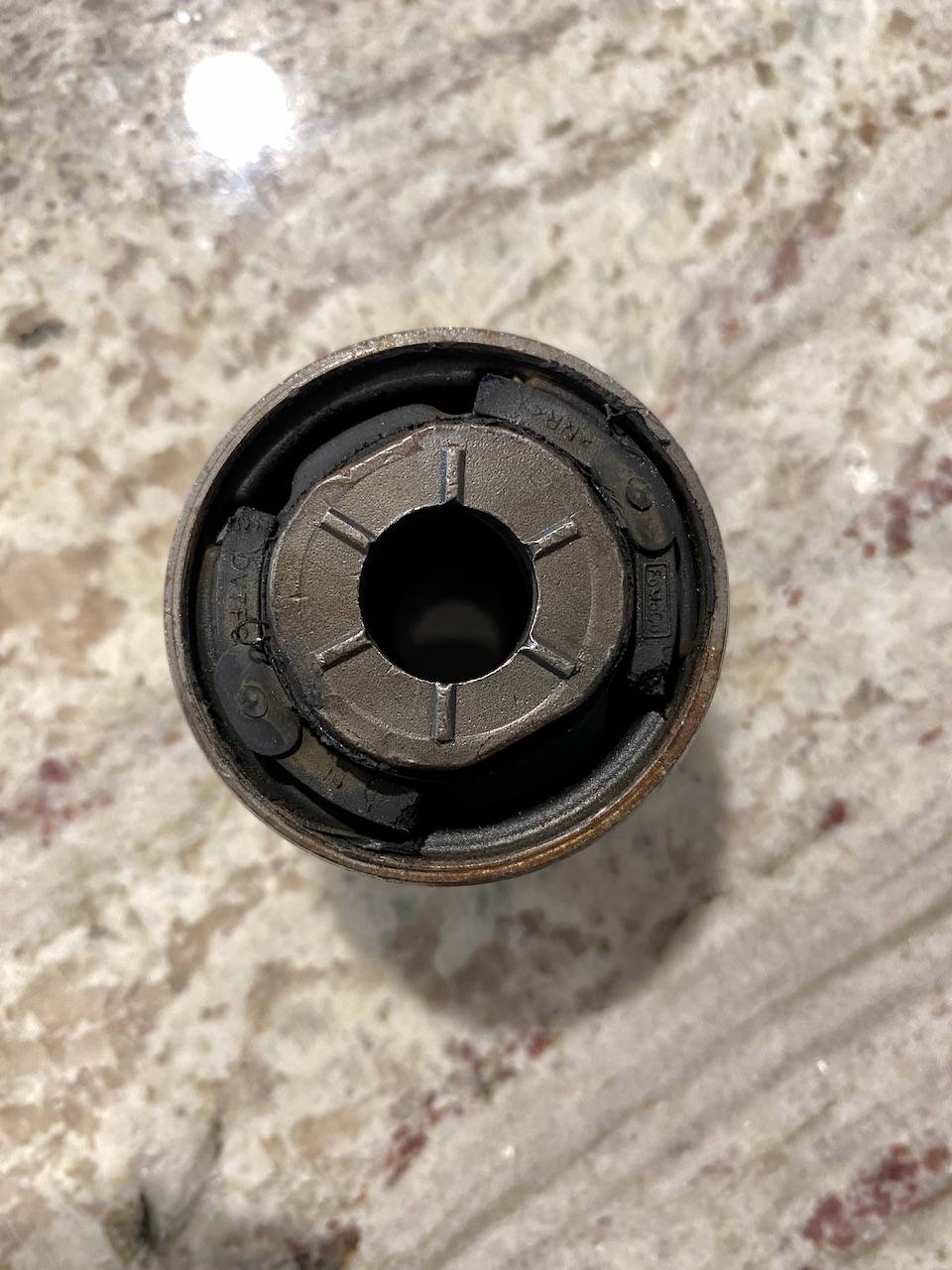

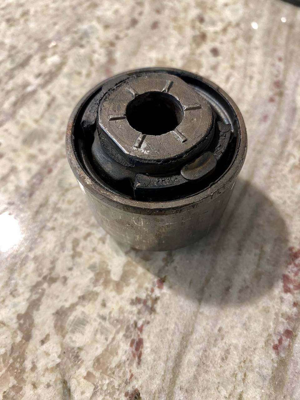

Another note on this topic - my 2016 GT350 came from the factory with a spherical bearing on the knuckle where the toe link connects, and the toe link itself has a spherical bearing where it bolts to the subframe. In short, there's no benefit to installing third party spherical bearing toe links on a GT350. Ford Performance did it for you.
Not sure how you got lucky with the spherical bushings in the rear knuckle where the toe link connects. Neither my 2017 GT350 or my new 2019 GT350R had that. Both had rubber bushings. Spherical only where the toe link attaches to subframe. Just installed Ford Performance spherical bushings (M-5A460-M) in the knuckle. I am very happy with the results.
Are you sure? It has a rubber cuff on it to keep dirt out, but it's an actual bearing, not a rubber piece. In my case, I realized that it was a spherical bushing by putting a bolt through it and moving it - a rubber bushing would spring back to center, but the one on my GT350 moved and didn't spring back when I pushed it. I concluded that the reason that FP doesn't list the M-5A460-M for the GT350 is because it's an OEM GT350 part in the first place. Maybe later model years don't have it, but mine does.

I am sure. Here are some pics of what came out of my rear knuckle. And this bushing is what I have personally noted in all GT350/GT500s I had the chance to look over in that area.
