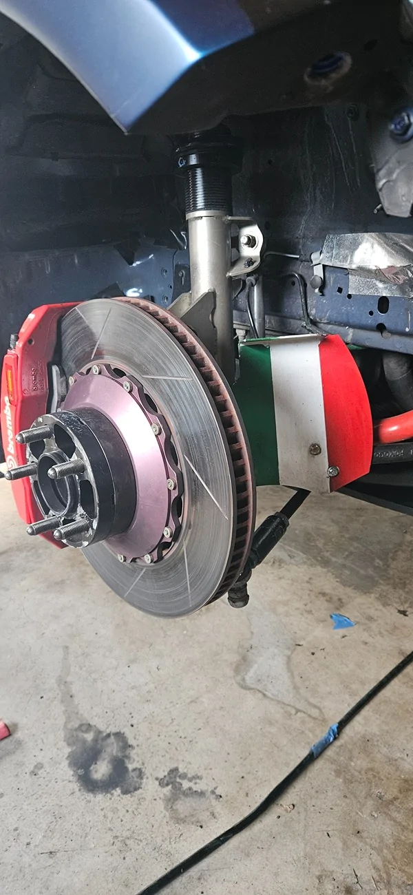

I have them on my racecar since 7 years. Still running strong. Cortex is high quality stuff. Design around racecars and their heavy needs.
I also use their better bushing (such as the monoball)
You can see them here and also their penske Coilovers
