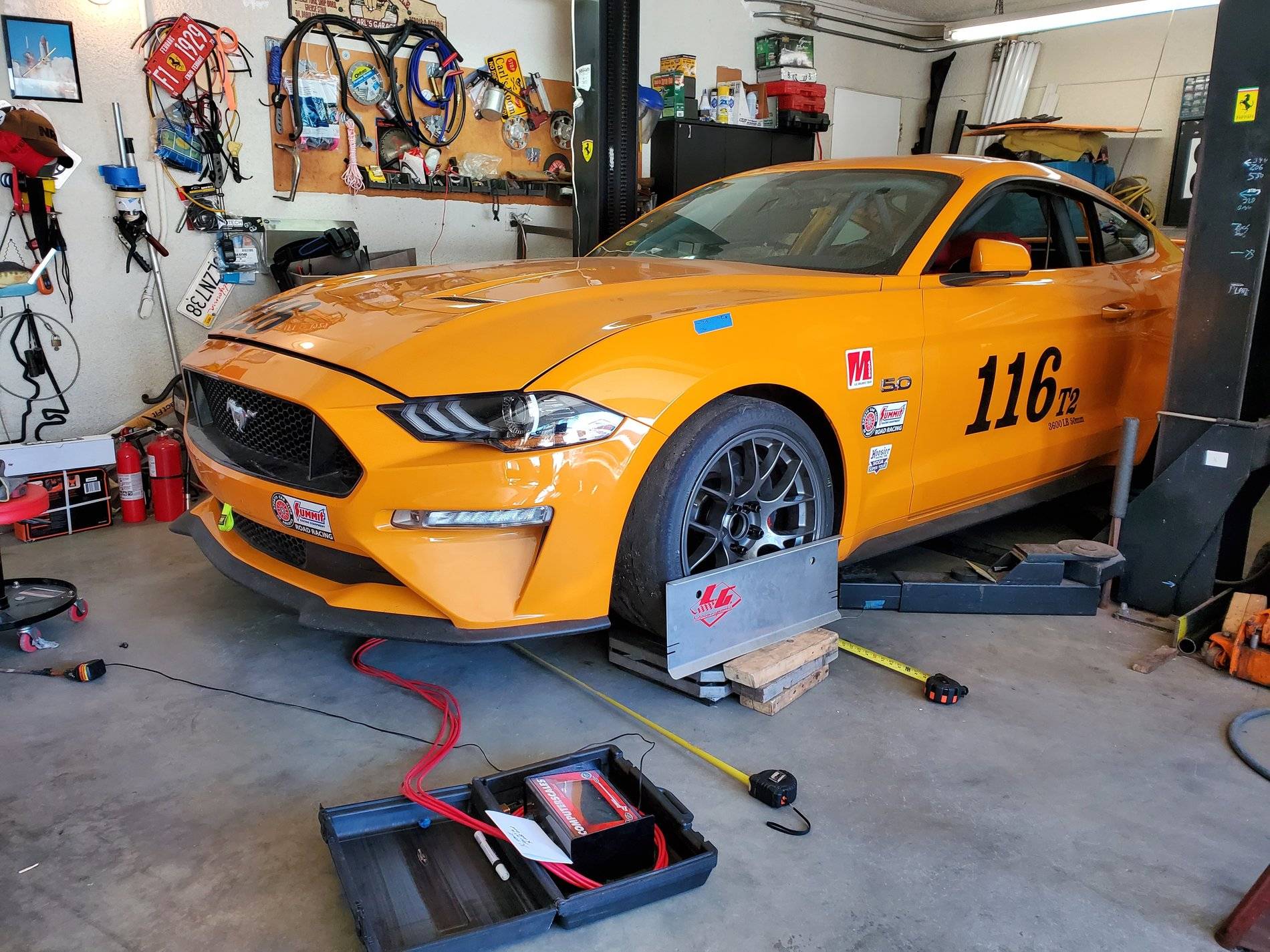

What you do is take old links off. Adjust one new link about the length of the old if you want as a starting point locking the lock nuts. It doesn't really matter on a loose bar unless something hits. You then put the fixed link onto the loose bar. Car should be on ground at rideheight. You then put on the other link loosely on the car. You use the turnbuckle to just make the buckle lightly snug like pinching food with chopsticks so that you do not add any spring rate from the bar. Now tighten the lock nuts. done
Now really what racers do is: flat floor, tires at race pressure, 1/2 race fuel load, weight of driver distributed in seat and footwell, endlinks disconnected. Ride height is selected. Corner balance car, check ride height, set alignment, check corner balance, reconnect swaybar endlinks passively.

Yes like this...I'm doing this several times during the race season.
