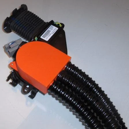

Final version of intake attachment
Well I was hoping for a more streamlined and elegant solution, but it's at least simple and somewhat adaptable.
I decided to give up on my original idea of attaching it onto the existing deflector since it just made it bulkier and it was a pain trying to zip tie it on. So, ended up with a design that will just screw on using the deflector's attachment points (a hook and 2 screws).
In an attempt to not have too much of a bulge in the back of the seat and out of necessity due to the limited clearance under the seat, I opted to go with three 3/4" ID tubes that are each 36" long. That length is enough to get the tubes to the front of the seat. I was hoping to do it with only two, but it seemed to be too restrictive. Any 3/4" ID tube should work, but I opted for pond tubing because it's corrugated (yet still fairly smooth inside) and although not as flexible as I'd like, flexible enough. I was worried that non-corrugated tubing would kink, so didn't try any. I considered the blue conduit that the F-150 guy used for his fix, but it seemed too rigid for our restrictive space. I tried non-split wire loom which I liked, but the airflow across the corrugation resulted in a not-so-subtle whistling.
I don't have one of Ford's sock modified versions, so I can only make some assumptions as to pros/cons of this addition vs. theirs. Since I can't test it side-by-side, I can't be sure there's an advantage and only assume so based on assumptions about their fixes limitations.
Pros: Intake hoses won't kink and are able to draw in sufficient air for the fan to operate at max output. Hoses extend out past the bottom seat cooler exhaust to the front of the seat to breath in cooler air.
Cons: Less elegant – back of seat will not be smooth when closed up. Additional cost plus need to self install. Pond tubing has slight rubber odor.
My experience with the attachment has been positive. It doesn't provide amazing performance, because it's still limited by the cooling unit's abilities, but it does provide actual sustained cooling.
So, the point of all this is to see if anyone wants me to produce this intake only part for them. I'm still trying to figure out if adding an exhaust option is helpful.
Keep in mind that you would likely need to remove the blower unit from the seat. Although I think it's possible to install it w/o removing it, it would require some dexterity and a small or flexible enough screwdriver to get to the screws. Either way you would need a Torx T6 screwdriver.
I would produce only the plastic attachments and you would be responsible for getting your own tubing. The pond tubing I'm leaning toward I got from Home Depot. It comes in a 20ft roll, which is enough for both seats. I tried some from Amazon that was cheaper at the time, but one of the pieces I cut seems to have wilted in the heat of the car. It's a little thinner and more flexible, so I was hoping it would work out, but I guess not.
Not sure of the forum rules, so hopefully not going afoul of them. Just to give you a rough idea of cost, if you got the same tubing as I did, you'd probably need to spend around $40 plus tax to do both seats. That would include two of the attachments from me plus a roll of tubing. It wouldn't be much cheaper to only do one seat due to postage and the need to buy the 20ft roll.
If there's interest, I suppose I'll figure out a way to facilitate and provide guidance.
