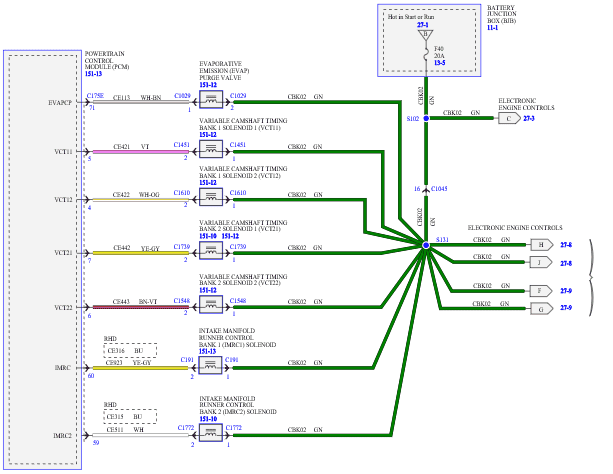

Current hypothesis is that the vapor line restriction is causing the high pressure in the fuel rail since it can't evacuate. Thoughts?
Given that this car has had a few problems with electrical connections since the AC repair fiasco, I am wondering if it's related. The most common fix for P144A seems to be replacing the purge valve, but I would like to trace the circuit and make sure the connection from the PCM is intact. Can anyone provide a schematic for that?

Thanks, Billy. I appreciate it.
Now to dig in and see if it's electrical or mechanical. Can't figure out which one I dread more...

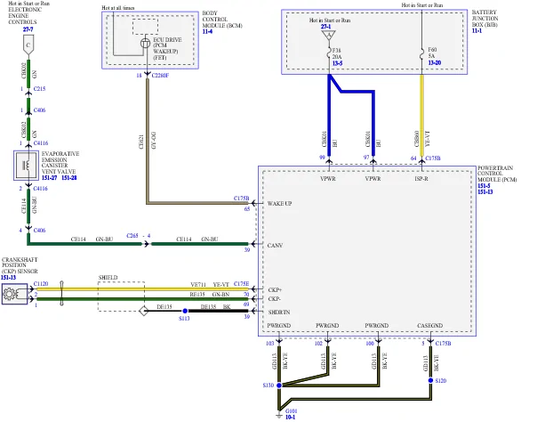

Update
I've tested the EVAP Purge Valve itself, the circuit and the PCV line heading back to the vapor canister. All passed. That leads me to believe this is in the vapor canister/vent control solenoid. Before I go tearing into things, I'd love to verify this circuit as well. @FLATPLANE - are you able to find this circuit as well? Not sure what it would be called, but it's in the emissions system and has the vapor canister and control solenoid.

Where was the harness pinched?
Any chance the wiring for the purge valve runs through it?
The wiring for the purge valve most definitely does. But it cleared my continuity test. Not sure if the second circuit I'm looking for does or not, though.
